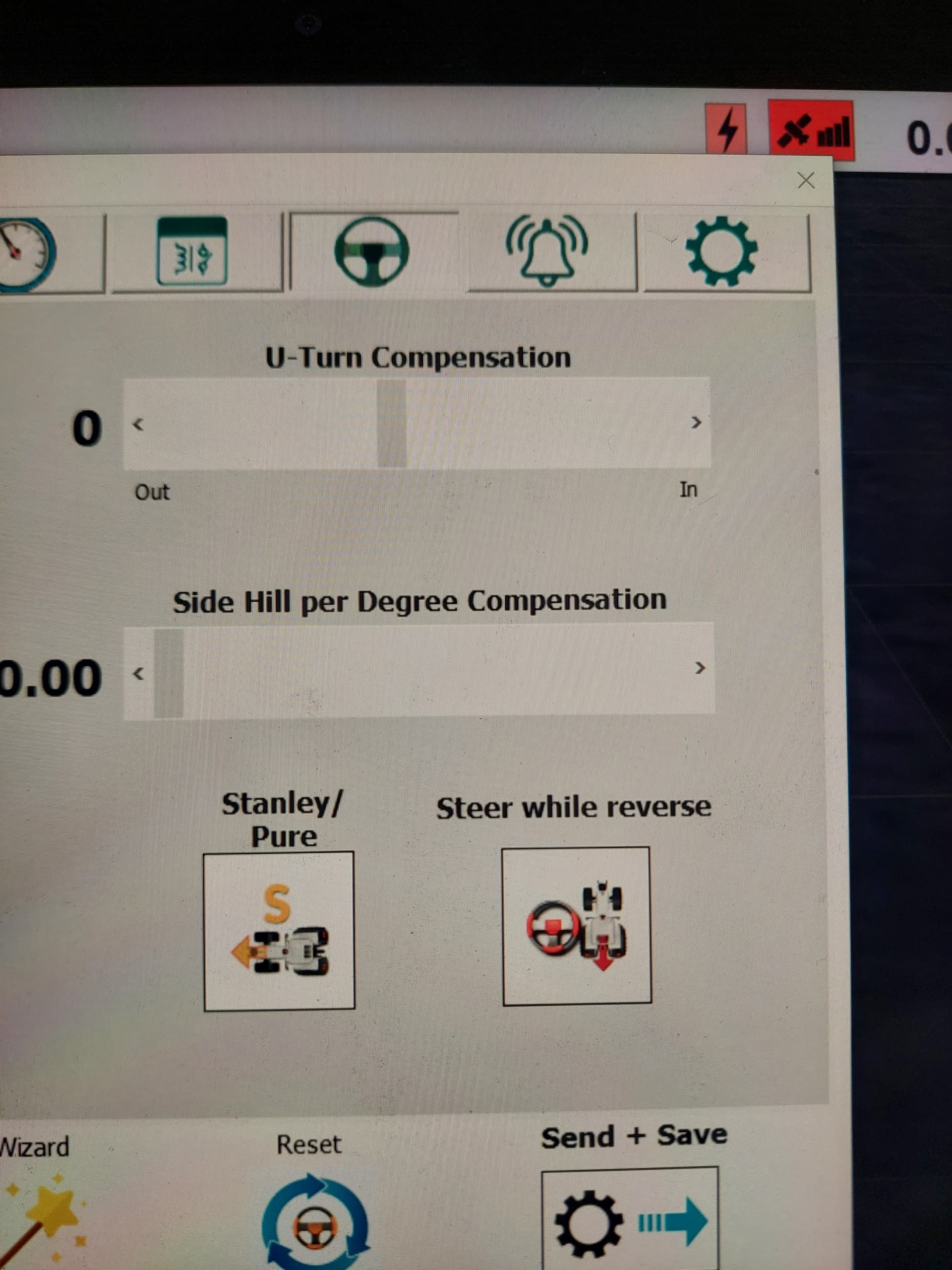

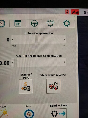

There is a setting in the steering settings pages that allows autosteer in reverse. Expand the steer menu then hit the steering wheel icon on the top row.
Ive no experience if it works or even how good it might be
