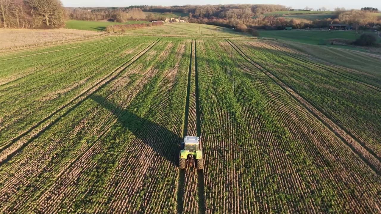

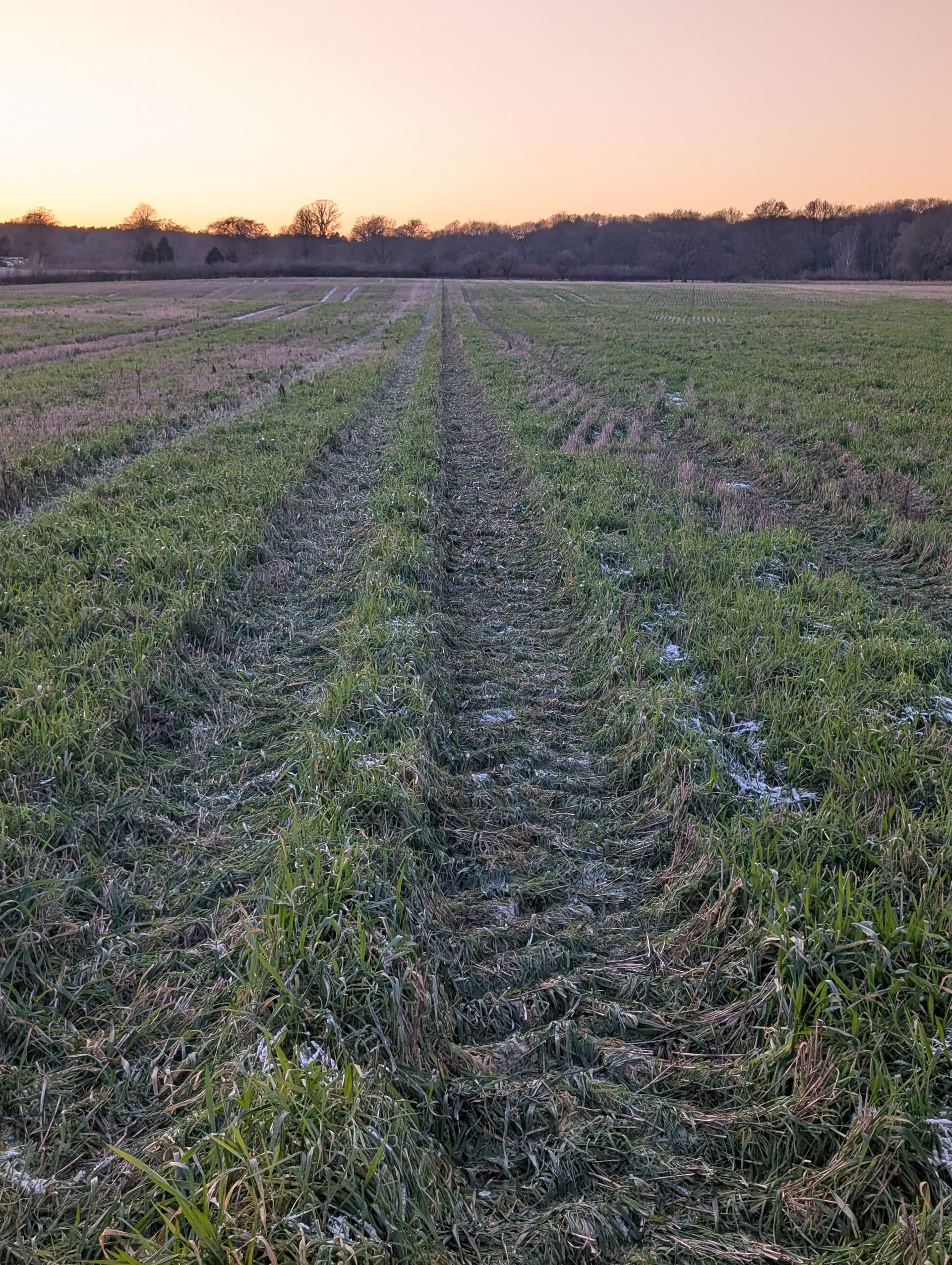

The tractor I posted a video of started as a single antenna with IMU. After a year and a half I went dual. Tuning is easier to get it to perform well. With a single antenna I could never completely tune out a faint weave of the front end as it tried to find the line. With dual the weave is gone, the tractor gets on line and runs arrow straight across the field
To keep this thread updated, I’m still really pleased with how well Dual works, find it just drives really straight,
So as long as you can mount two antennae’s either side of the cab, I’d always opt for Dual. Drives really straight AB lines, steers better on curved lines and makes neater U Turns.

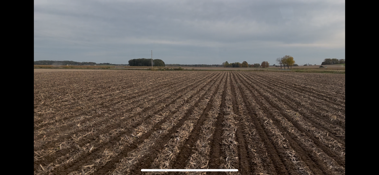

I understand the theory associated with what you are asking. I will say in practice side by side dual antennas leave nothing on the table. My average cross track error is consistently measured in the tenths of an inch (2 cm or less)
Knowing the tractor is on unpredictable ground conditions and the system has to take positioning data and translate that in to a correction for the steering system, I don’t think any noticeable improvement could made to the current dual antenna system. It will run in the same tracks all day long. The picture I attached was of a field I strip tilled with a 4 row strip till bar. You can’t tell where the guess row is. It’s perfectly even all the way across the field.
