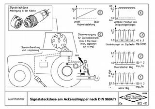

Came across this tonight https://mediatum.ub.tum.de/thumb2/732576
Din 9684-1 7 pin tractor plug standard.
Actually shows 6v on impulse’s, but it seems to work on 5v.
