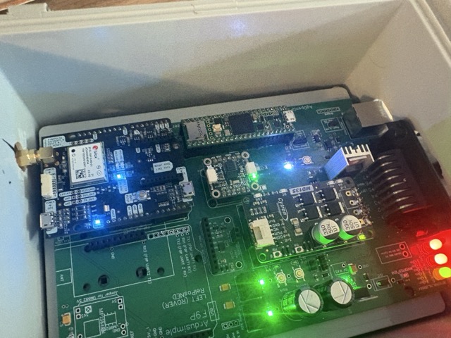

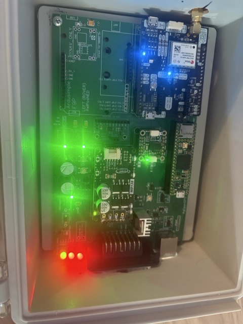

Hello. I’m assembling an auto steer system for family and have run into a couple issues. I don’t have it in a tractor yet so I’m just bench testing but when I short pin 8 to gnd the “steer” LED on the board lights up but the auto steer on the GUI does not turn green. I don’t know why it won’t engage, any ideas? The main LEDS on the boards by the connector indicate auto steer is on when I engage it with the gui but not with pin 8. I’ve attached a picture of my board, One picture with pin 8 nominal and the other shorted to gnd. I did find in the steer settings the option so set the auto steer switch to a momentary button vs a switch and I set it to momentary.

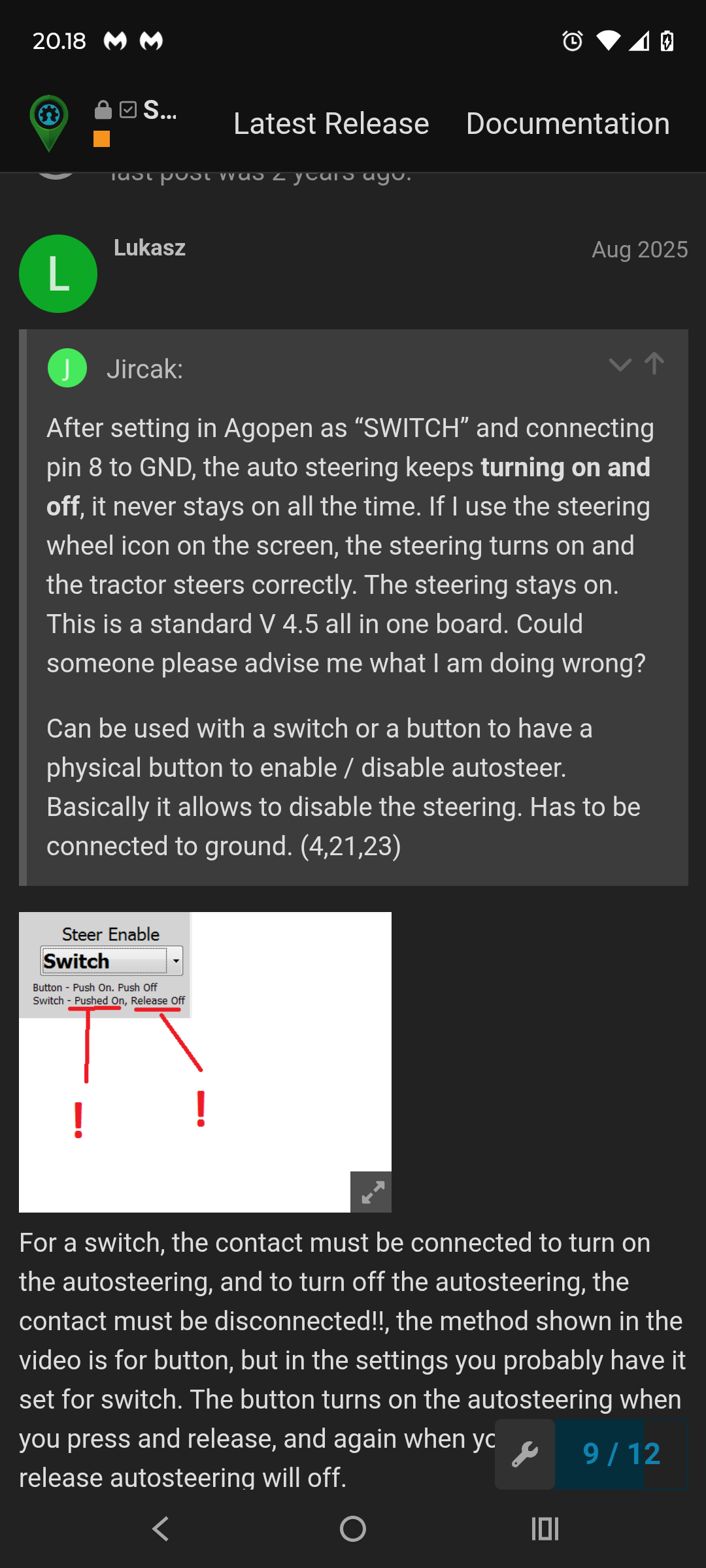

Edit: maybe you need to reconfigure the teensy, that seems to be the solution in this thread, with same problems as you described.
