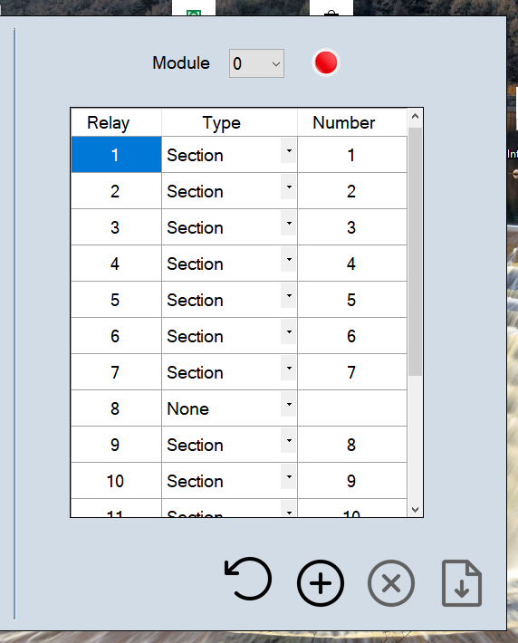

It is working somewhat, I think I’m not configuring something correctly. So I want to have control of sections 8 and 9, so should be the first two relays. No matter what I assign for pins on the remote relay I cannot get control of section 8. Section 9 works fine, it’s controlling the first relay in the board. In the rate controller it’s showing 1-8 as the onboard “relays” but you can actually have 7 functioning sections on the rc15 correct? That’s all the updated pinout indicates anyway.
Relays 1-8 are for the board, even though RC15 can only do 1-7. Relays 9-16 are remote. They require no pin assignment.
That did it, thank you!
