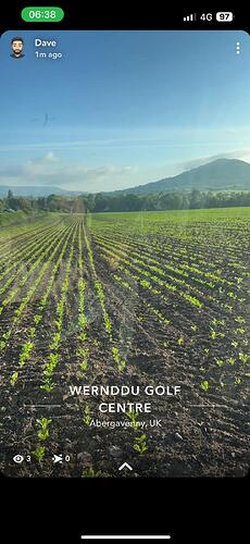

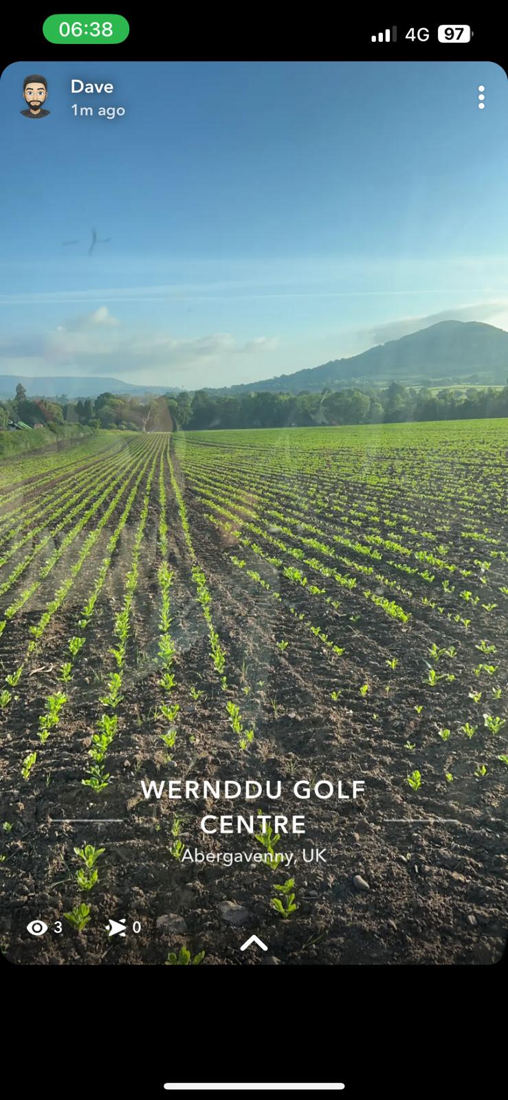

![Screenshot_20240427_142042_Gallery|225x500]
Managed to have it dropping seed 40cm off the headland row
(upload://7dqAuHTigoMh8hsI5x0MIYwdRWT.jpeg)
Very happy with the results so far
Time will tell once it grows
Many thanks for all the help and input i had

Hi, how do you stop sowing?
It turns each section off when it crosses the coverage area on the headland

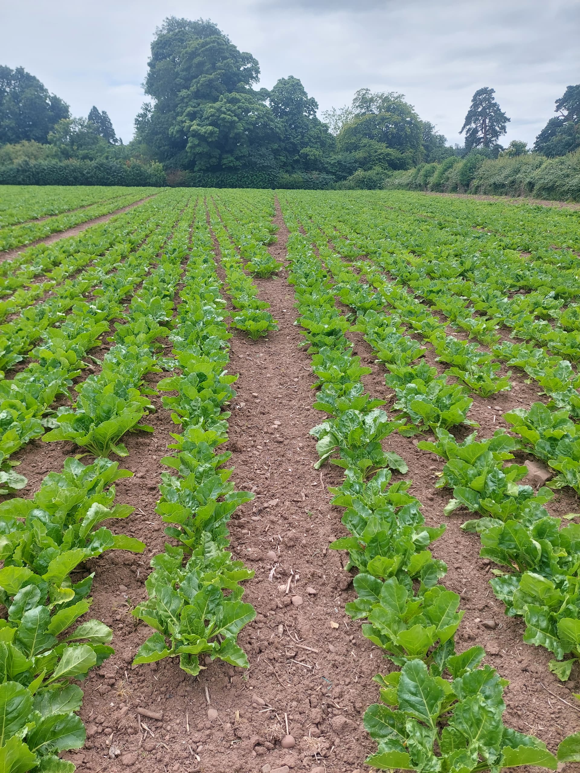

Bit of a follow up now the crop has emerged enough to see properly. Needless to say im really happy and its unbelievably accurate

did you walk round with a hoe to make it look good :rofl:
That’s great! I also have experienced similar success with this. Thanks for sharing! Works better than our commercial system. It drives straighter as well.
Bit of a follow up of pictures later in the season of the grown crop. Absolutely pleased with it. The harvester driver is over the moon and is able to rise the inner 6 rows easily
Definitely a success story
