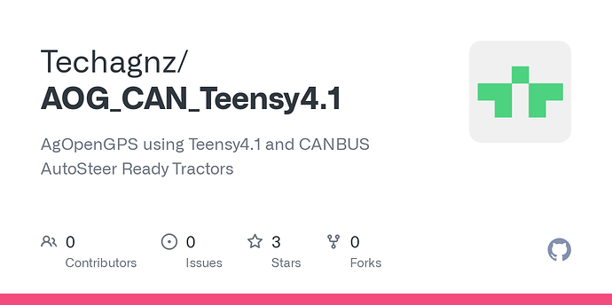

I had one that wouldn’t work with the isobus engage message. I found the engage message was different than what was in the teensy code. Once I changed the code it worked perfectly. Would have to look and see if I saved this somewhere.
Looks like I did save it to my github here if you want to try it.
brilliant, thanks for that
as soon as i grow big enough balls to risk trying it, i’ll get on and give it a go :crossed_fingers:
right, flashed the teensy with this code this afternoon, go button still no worky :man_facepalming:
did notice the tractor was running quite old software if that make any difference?
That’s odd. I loaded it in a machine yesterday and it fixed the engage not working from the TI problem.
You do need to have isobus on in the vario terminal and configure the TI sequence for one of the buttons to have the engage in it. Also need to have the steering valve enabled on the armrest, that caught me out for a minute after I had restarted the tractor. Sequence was running on the go button but nothing happened in aog, valve on and all worked.
