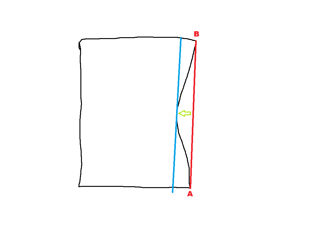

as my field bordes are not perfect straight a kind of auto shift function would be very handy.
Lets say my right field border has a concave bow as shown in the sketch.
Creating a A-B line in the editor I would run over the field border (red line).
I imagine of a function that moves that A-B line field inwards to the closest point. (blue line)
Like that I could run straight lines without the risk of running outside the borded on half way of the field.
What dou you think about?

I’m afraid a good solution is more complicated than the shift you propose if the intention would be to cover most types of odd field borders.
Do you feel a manual wayline shift is not accurate enough?
I usually do these manually but would like to see a generic (graphical) tool that can shift A and/or B points a given distance, A and B points reversed or the AB-line turned by a given angle etc. Zooming to “critical” points would help adjusting the waylines as needed.

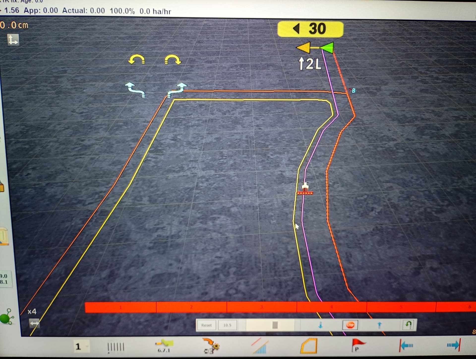

Hello, in my opinion, in the case you describe, it is best to use headland builder and, on the curve side, make a lane for 3 machine passes and mark the AB curve on it. Then you will have marked where to work according to the straight line ab determined by the straight edge of the field

I did not mean you would do a manual shift while working on the field. I would do AB-line planning before entering the field.
By the way, are you after an AB-line exactly as on your drawing or do you mean an AB-line that would be half your implement width away from the field border (at the most tight spot)?

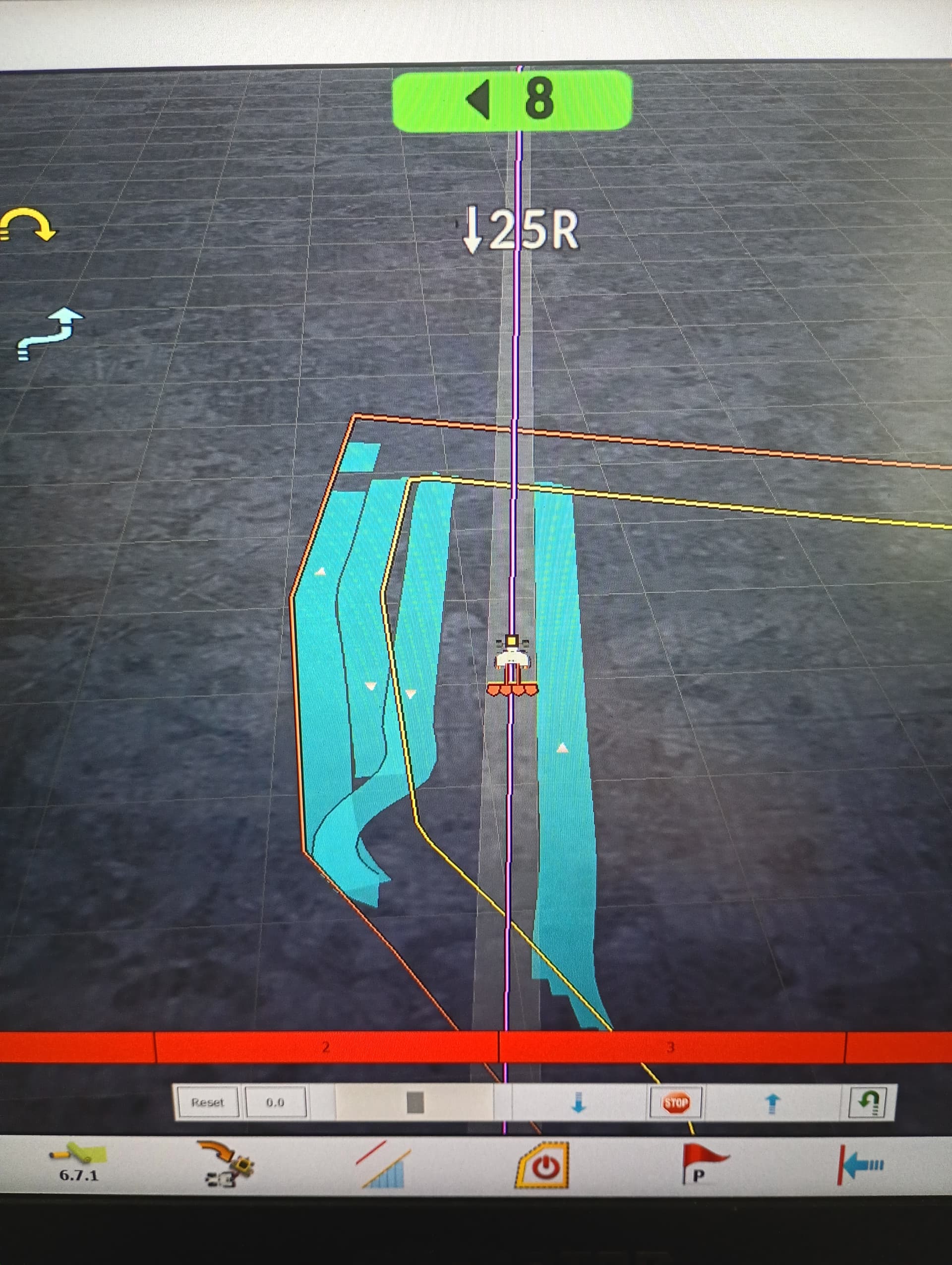

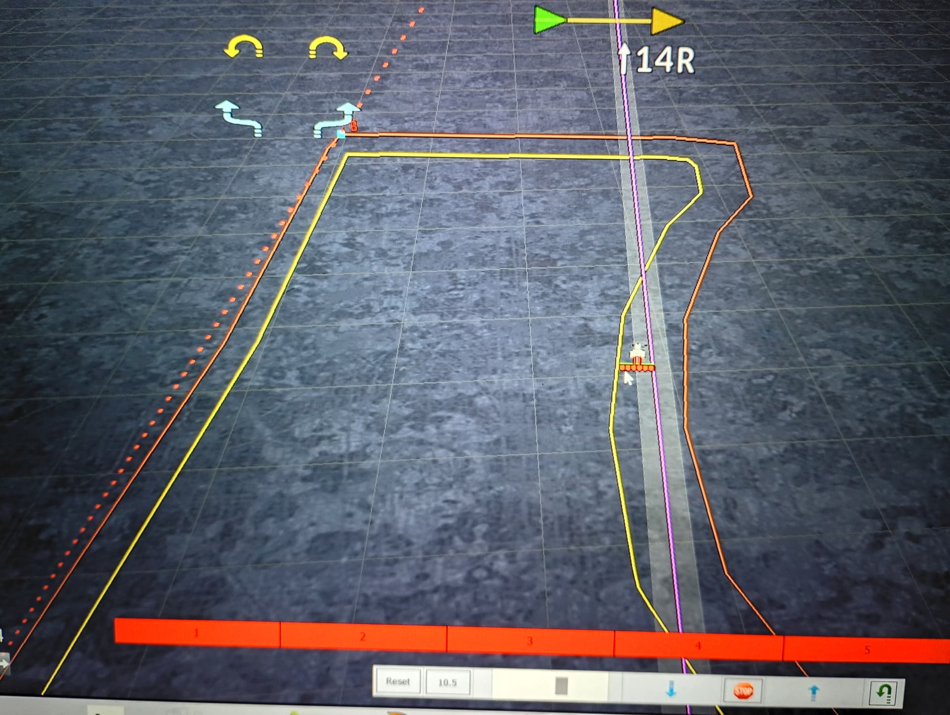

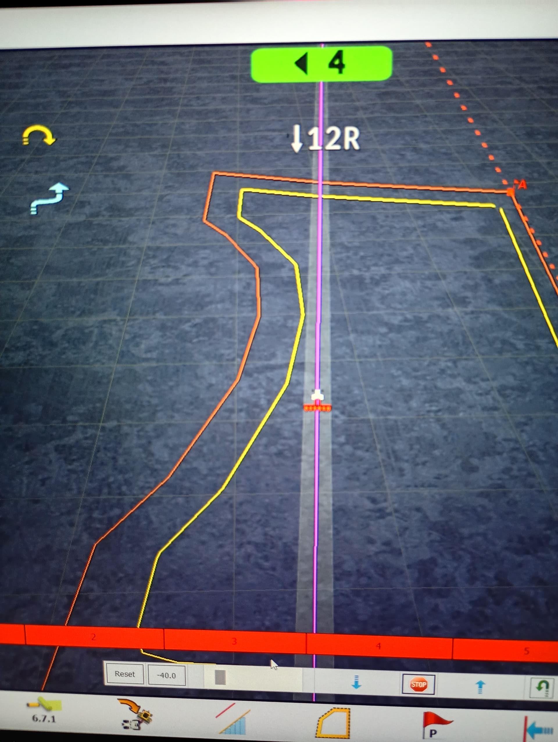

I think you can achieve the effect you want by using the headland builder, creating straight AB lines or AB curves, and switching between them. I’m adding two more photos from the simulation.
This drawing was just an example.

Here is a video about the current state of the implementation. I’m not English speaking, so I hope it’s self explanatory (a little bit at least). File selection dialogs doesn’t appear in WIN+G recorder, so… imagine :slight_smile:
Here is a video of the first rapid-test that shows the on-the-field result (next step, test with the correct tractor+implement).
Hi. I’m an italian ex-programmer, (now farmer :slight_smile: ) and lately I’ve developed a rectification system, soon available.
My app (Windows, but multiplatform cored (Avalonia, C#) can read one or more ISOXML3 fields or set of fields, show zoomable boundaries and guidance lines, clone a wayline from a field to another, and generate a set of one or more smoothing lines from irregular to straight, save back the field with this set of waylines. Tested today. It works, but some tricky operation is necessary on-the-field for centering the set of lines (because the navigation system, FendtOne, doesn’t accept grouped waylines.
So: the irregular baseline is marked with two perpendicular short LINE obstacles at selectable distance from extremes, Ref. A and Ref. B. You can view them on the map and locate the tractor over the desired centering point A or B. Every intermediate wayline is marked in the name with the cumulative offset to shift them when you (staying in A or B) center the tractor on the irregular baseline. Once centered an intermediate line you apply the shift. When every intermediate line is centered and shifted that way you can start seeding, manually selecting the intermediate lines (indexed 1,2,…) and eventually use the last to continue with self-generated parallels.
It’s not so complicated as it seems, I think this system was the best compromise.
As soon as possible, I’ll post a video.
Technical note: the rectification is performed finding a linear regression on the irregular baseline, then applying a specified and weighted max amount of correction. So you can specify a tolerance, and the algorithm chooses the number of intermediate progressively smoothed lines to generate.
