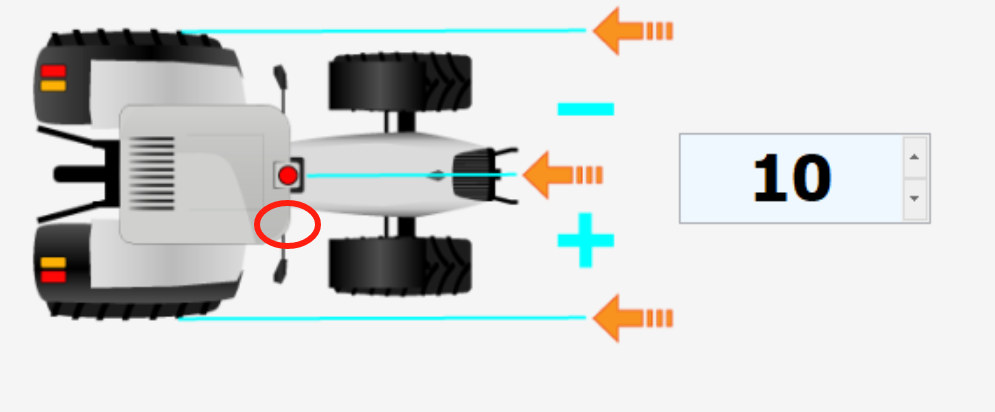

The antenna offset should be + when my antenna is on the right of axis center, right?
If you look carefully u can see + and - in bright blue. Plus being on bottom of image and minus on top and answare to your question YES.
That graphic caused enough confusion that it was changed in the newer versions. In 6.x.x, it is very clear.

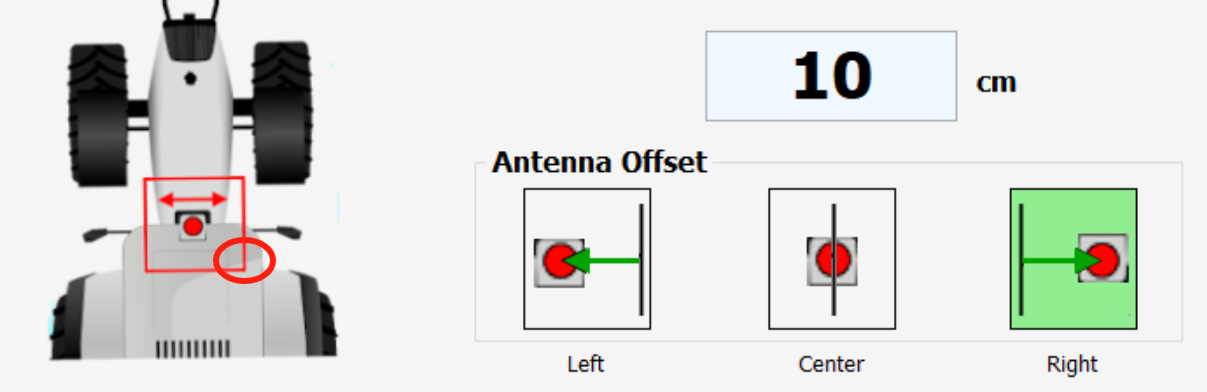

I feel confused because the value Antenna Offset is 0.1 in V5.7 but it’s -0.1 in V6.x when select Right.

Yes, the configuration is from 5.7 that the offset is 10cm (0.1m), But when I update to V6.x, the Left button is green. So I click Right because antenna is on the right. I can see the value is changed to -0.1 from “View All Settings”.
Get your point now, see -0.1 when 10 cm put in right offset. And 0.2 when 20 cm in left offset.
