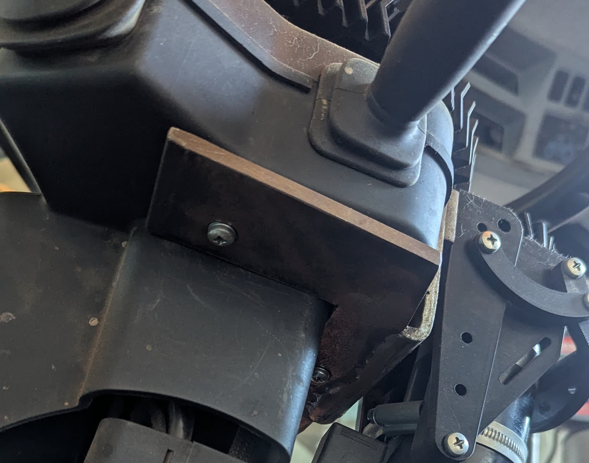

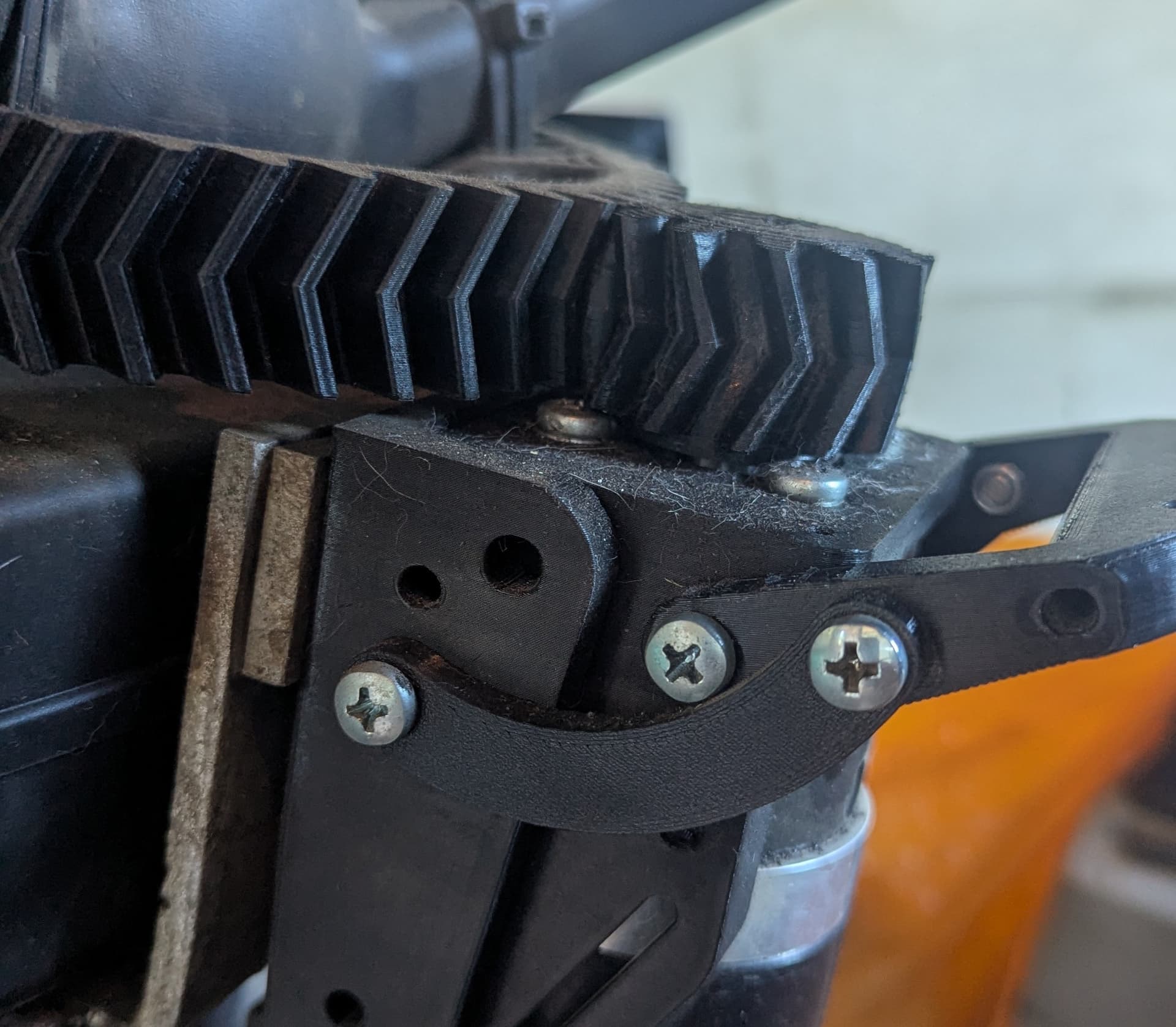

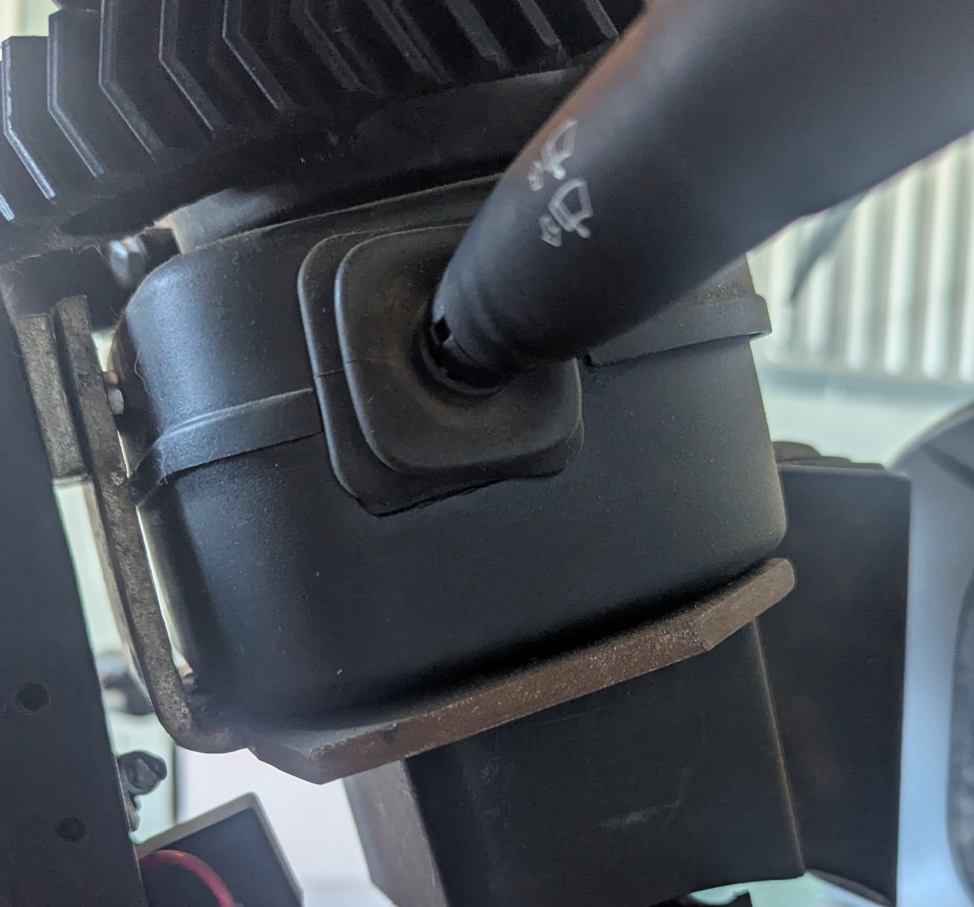

I have a non steer ready t6.180 and used the phigets motor, mounted to brickbracs 3d printed clutch with a homemade bracket to the steering column using existing mounting points. With potato farmers 3d printed gears.
Hardest part of the whole job was mounting the motor in the right place to align the gears up. The bracket I made holds tight around the plastic steering column to stop the rotation, and the 3 screws I replaced with slightly longer ones only hold the plate up tight to the plastic covers. Working well so far…
