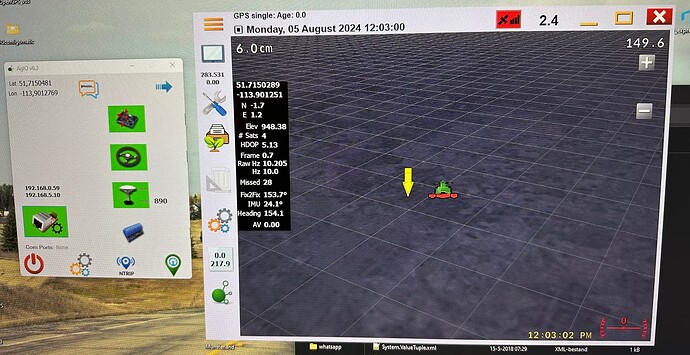

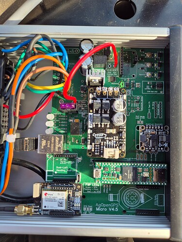

I installed a micro 4.5 pcb on the tractor. I created an AB line. I press the steering wheel at the bottom right but I have no 12 V on terminal 7 (6/2 unlock). what did I forget?
Are you missing an mosfet on board? The one with heat sink?
Do you have a cytron board to run the valve? I don’t see it on the main 4.5 pcb?
what do you think ?
