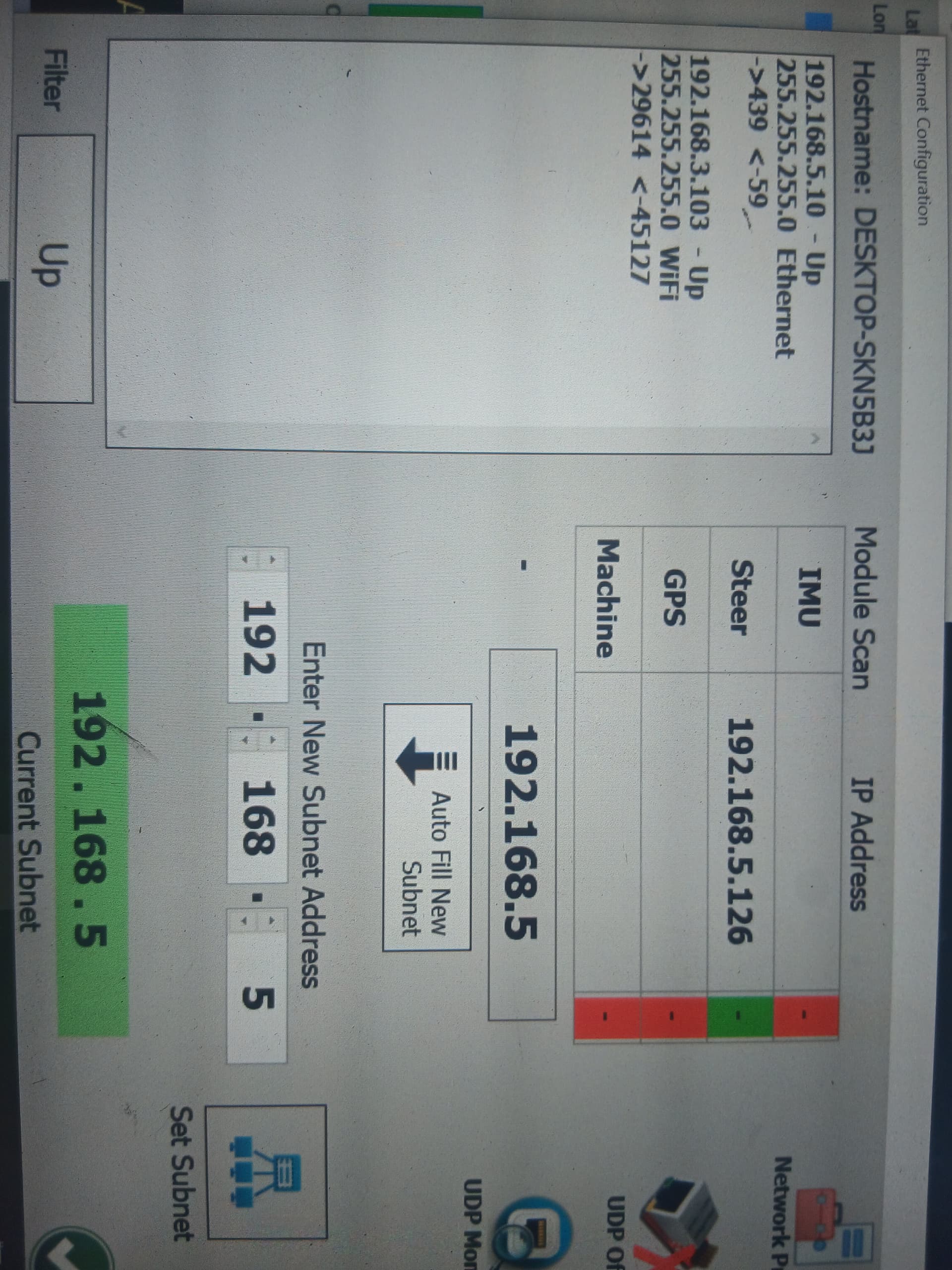

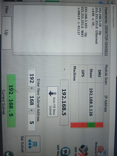

Are the gps and steer green in this screen?
Only steer is green
This is fine, open aog now?

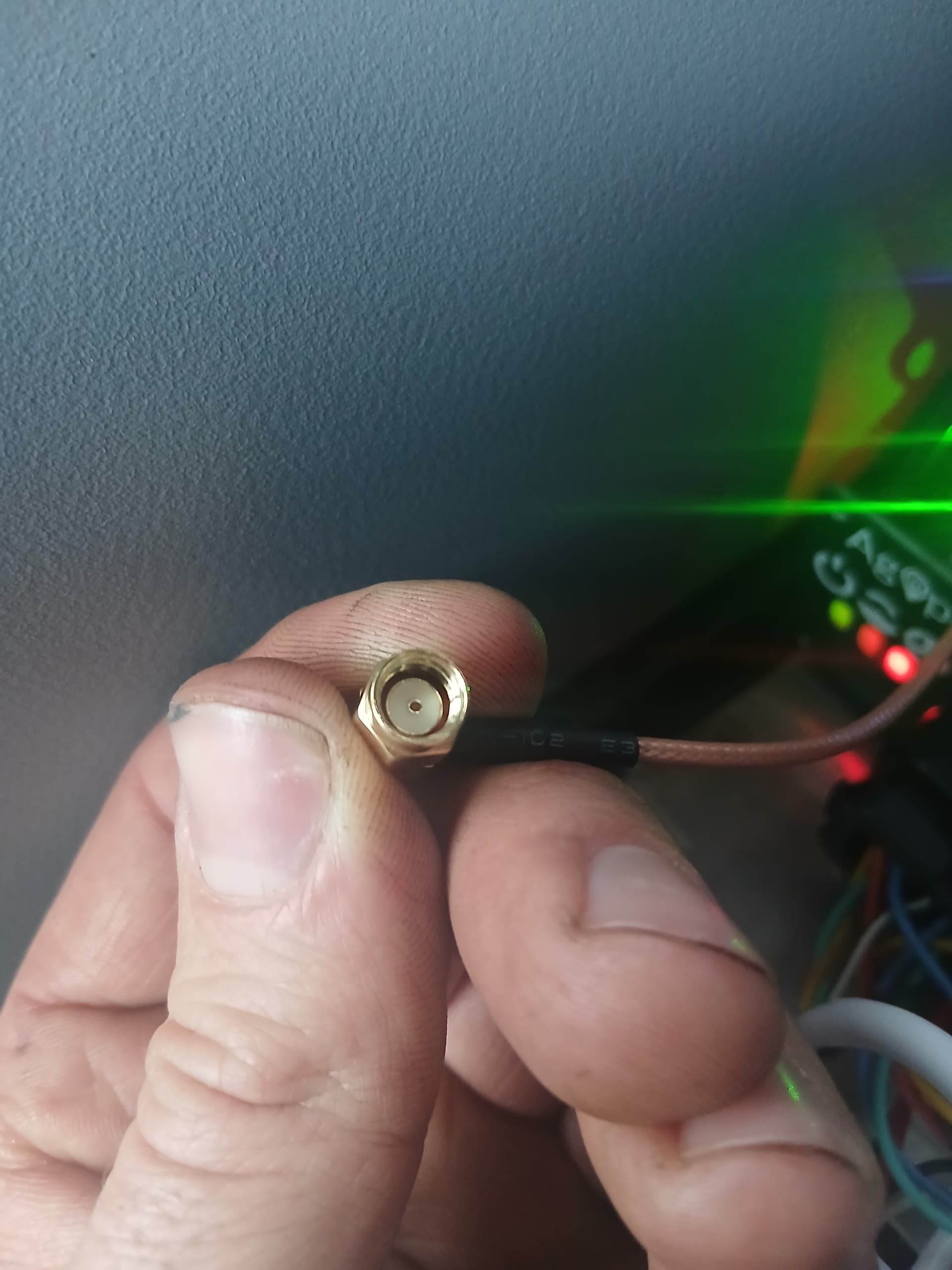

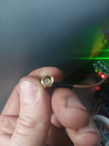

Ok so ive had a bit of a dunce moment! These connecting wires i was using for the antennas are female instead of male :upside_down_face:

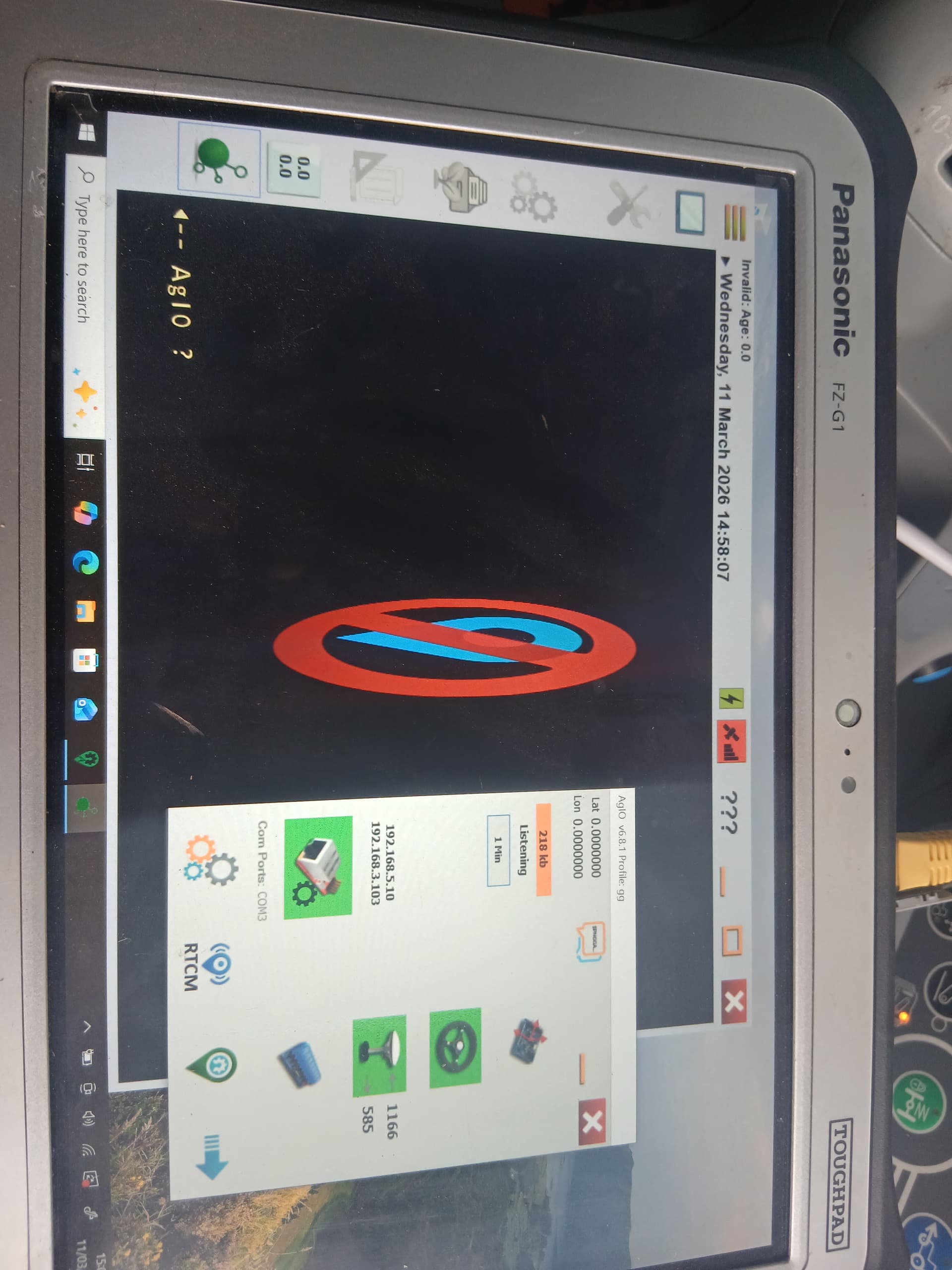

However i dont seem to be out of the woods yet. When i program one f9p to single it connects and works fine. Then whenever i program them to right and left for dual i still have no connection like the picture above.
Sort one problem at a time
Sorted now. I took the right f9p out and swapped it with another one. Programmed it to right and it worked. So I will try configuring the one I have taken out to single and try it in the other tractor.

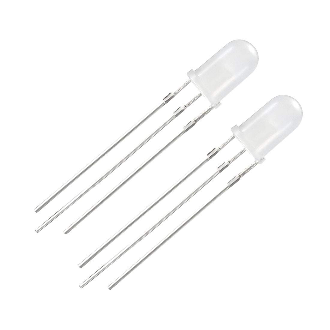

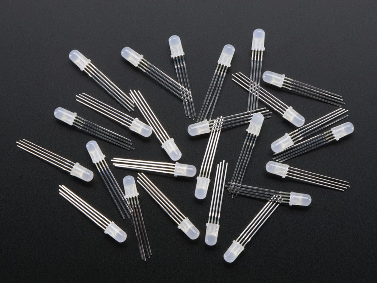

Would these do?
Do I understand that you are talking about the indicator lights for a standard all in One board? If so you need a bicolor common cathode one. It will have three leads coming out of it instead of four.
Yes, a V4.5 micro board.
Thanks, that’s a name for what I need now that I can search for hopefully.

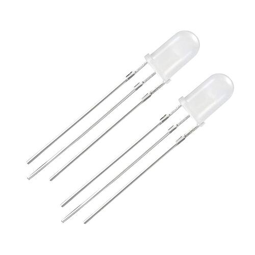

This type?
That looks right
Thanks again.
