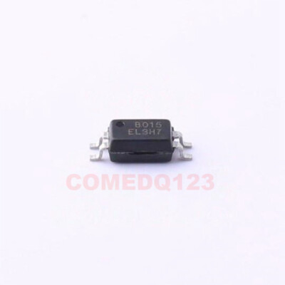

Hallo,
ich habe mir nun Die Platine bestellt. da ein paar teile gefehlt haben wollte ich diese seperat bestellen und selber darauf löten. Das Problem ist nur das das teil c32565 sowie das teil c2883741 nicht mehr verfĂŒgbar sind (nicht mehr produziert werden). Gibt es hier Ersatznummern die noch verfĂŒgbar sind
MfG
You are right no similar items available at the moment.
But try search for the part name: EL3H7(B)(TA)-G from Everlight Elec Or order another optocoupler like it.
Same for the 24 pin header or buy a longer header and cut it.
Search google or Ebay for X6511FV-24-C85D32

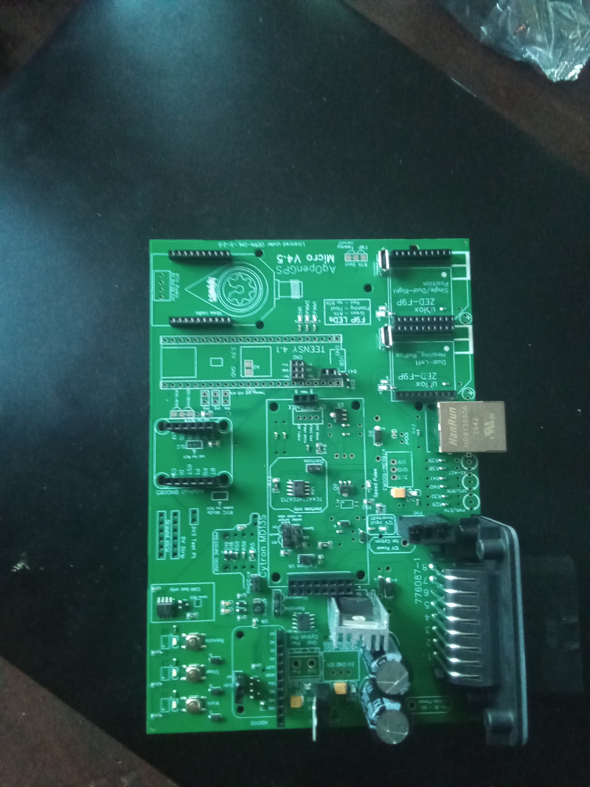

So I ordered the v4.5 micro boards, was a few shortages & I think I have most of it ordered from elsewhere, just waiting on a few bits to be delivered yet.
Only thing I need is led’s, what is needed in led’s, as in specs or where does everyone get them from?
May need a few other bits but will see later when I have it all together.

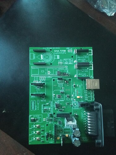

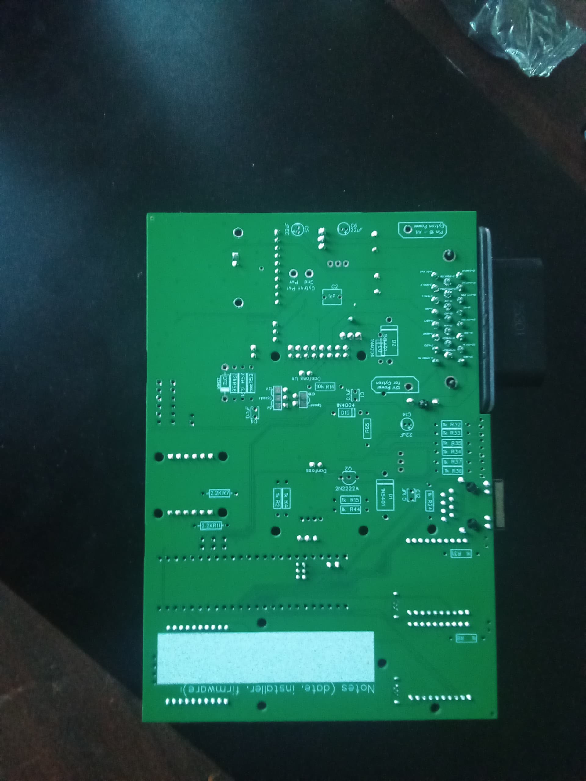

Hi, I am new to this. Just got my boards from jlc, I thought they were finished but now i am confused. Can sombody tell me whats missing on my board from the pictures? I haven`t got anything under the board, but today i managed to look at an 3d model of the pcb. and there was many components under.
You have teensy headers missing
3 led lights at front of the board
3v and 5v regulators
Possible some resistors
To start with
You would’ve had a parts shortage when you ordered your boards and options to replace missing out of stock components
Check the inventory
Header pins easy enough to source and soldier, regulators ok aswell. Not sure on the 3 led lights
what do you mean with inventory? How about the backside of the board, there I havent got anything soldered on. Is that right?
Nothing to soldier on the rear its just showing you what through hole components to use
When you ordered your boards from jlcpcb you would’ve had a list of all your parts shortages. You had the option to replace with another option or carry on with the part shortages.
Look back at your order

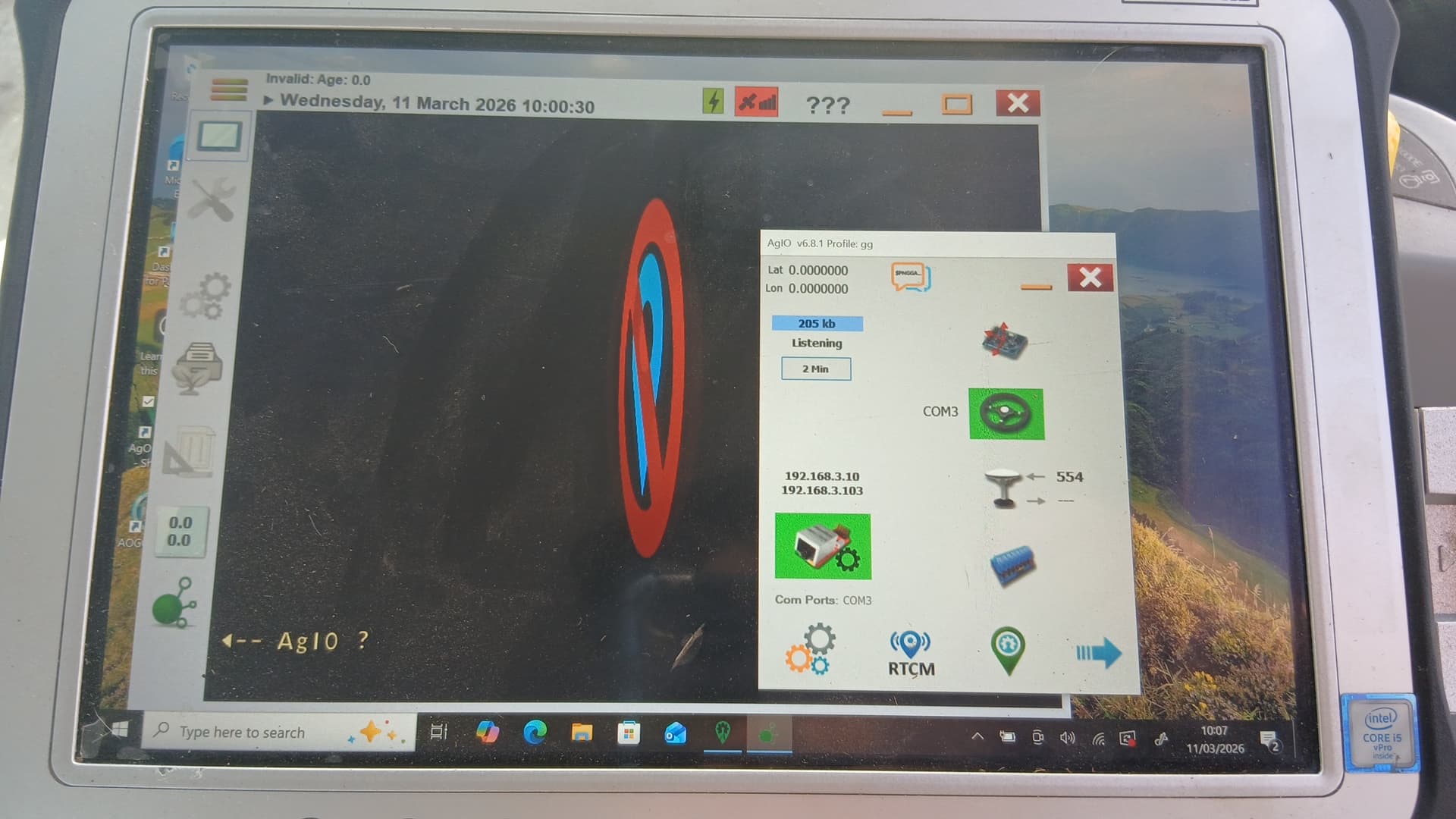

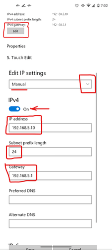

Any have this trouble connecting? First time setting up this 4.5 dual and i cant get it to connect to anything.

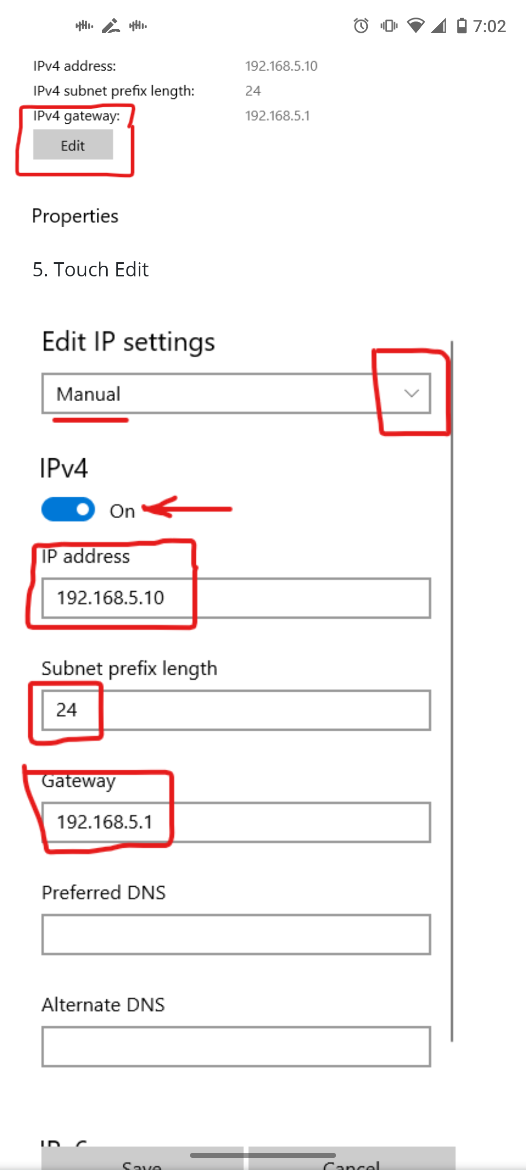

Go through the network settings again. Ethernet Setup | AgOpenGPS Documentation You shouldn’t need any com ports if you are using an Ethernet cable.
It connects to another board I have in another tractor no problem. I am not sure wich teensy firmware to select for dual?
Check the network settings in Windows. It is probably set on automatic IP assignment (dhcp). Set it on manual and make it look like this and I bet it will work
I have never done a dual system but I’m pretty sure it’s just the regular firmware.
Thanks. I have already done all of these settings.

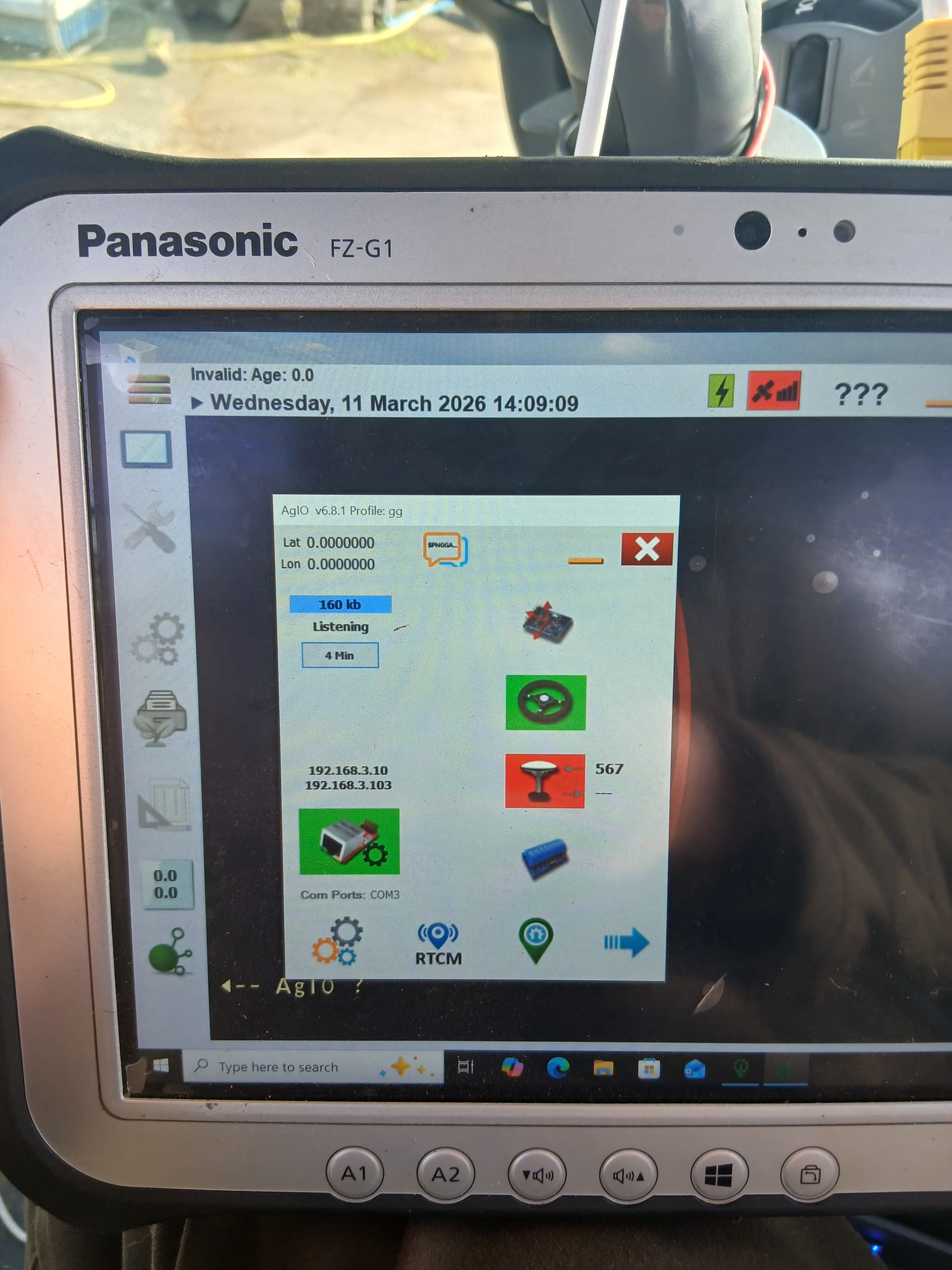

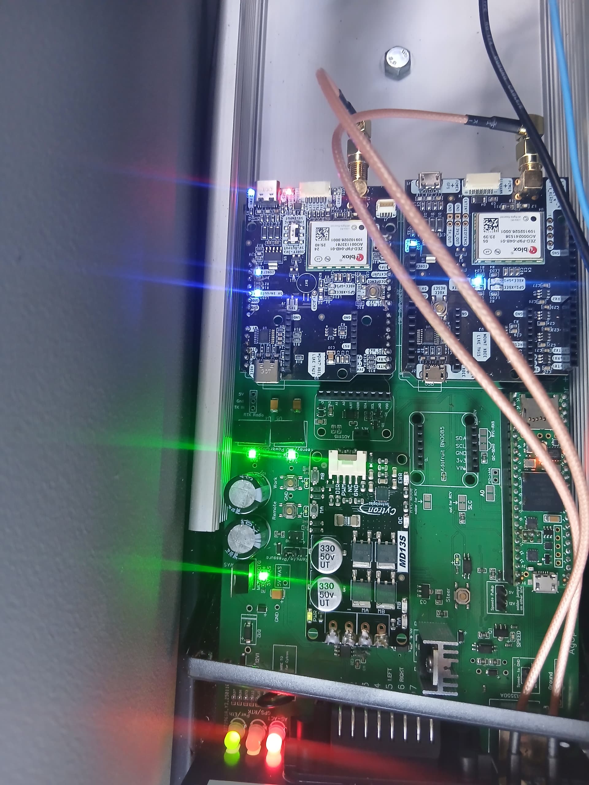

Are your antennas outside in full view of the sky?
It will act like this when parked inside
Yes parked outside. There is no was readings shown either.
This is all i can get. Parked outside. Is there nothing else i have to change for dual?
