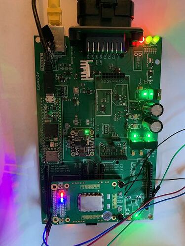

Shiny new v4.5 board up and running on the bench. The new UM982 support is the bomb. Access to COM2 & 3, remote status LED’s, solder jumper for power and clearance for the antenna connectors.
