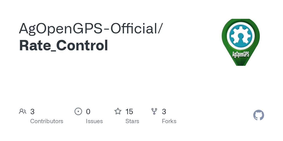

Here is the rate control site. You will need to assemble your self.
