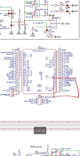

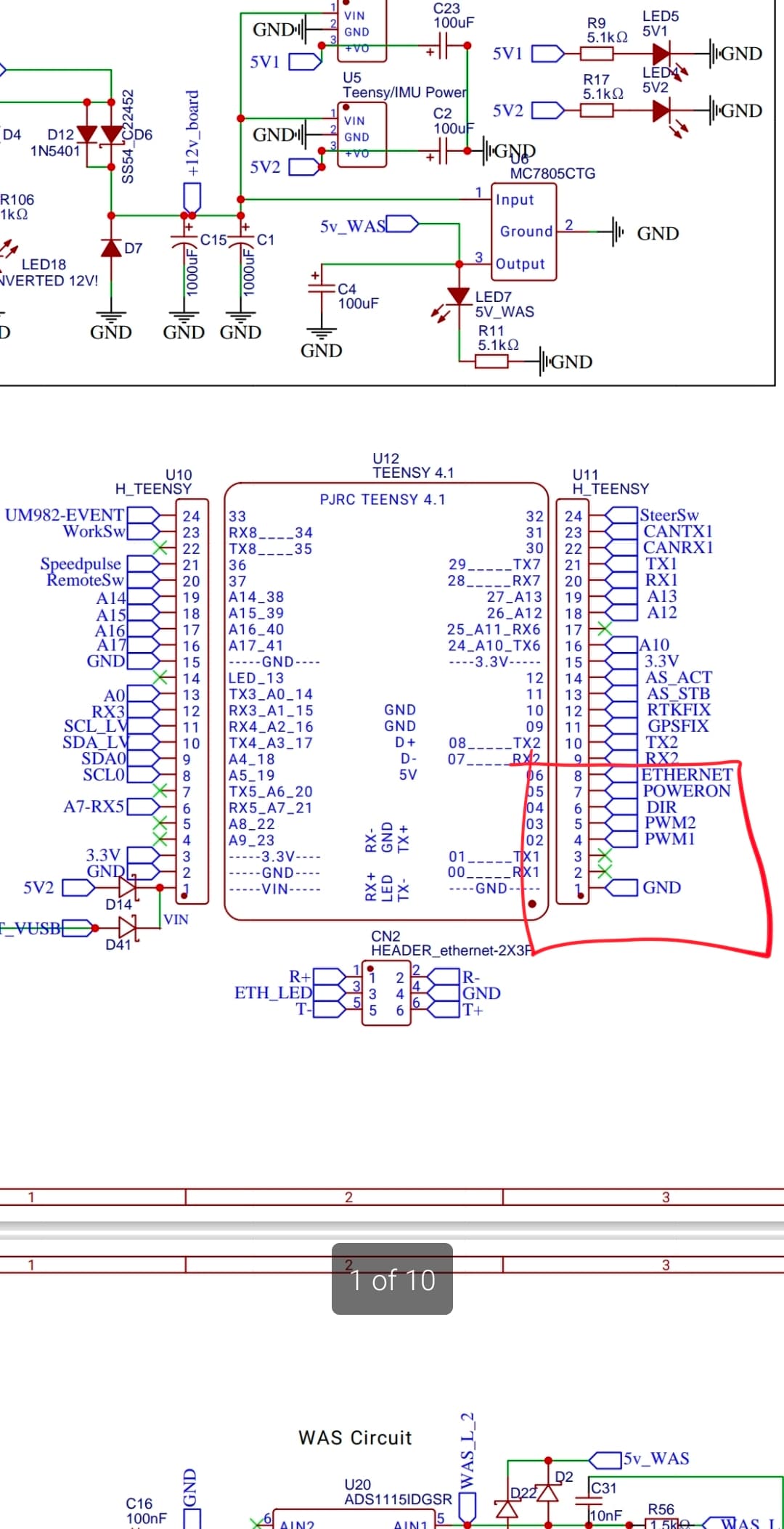

Thanks for the tip, I will try a couple older revisions and see if any of that sticks. I ordered a new Cytron board so maybe it is just that. I checked the continuity between the PWM and Dir on the Cytron and any of the teensy board pins and I got nothing. I couldn’t find which of the Teensy pins that is supposed to be connected to.
Check the picture.
I found the issue … the trace on the pins on the cytron for DIR were damaged. Hence getting no continuity. I had a cable connector lying around and tried that, immediately started working. Appreciate you helping me with this, I’ll wait to attempt the free wheel mod until i get another cytron board in !
