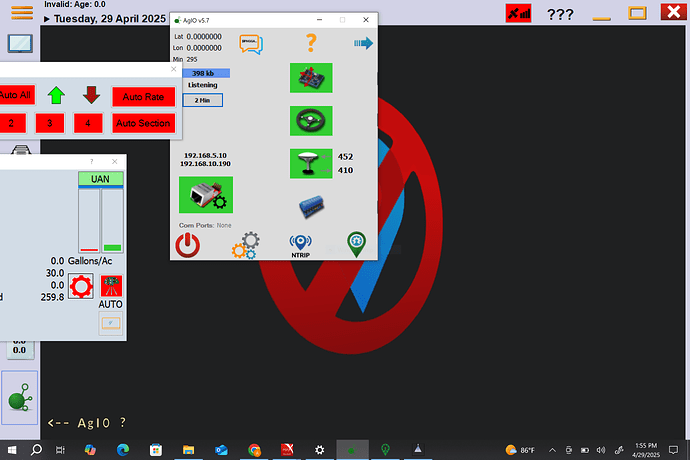

This is now what I get when the board is connected. New antennae will be here in a few days. Could that be it?
I cant tell from picture, did you contact ardusimple, they will ask for some video proofs and diagnose the problem
