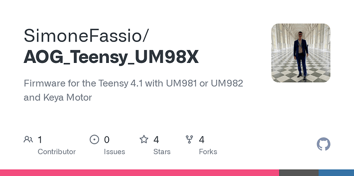

One guy has made a version that doesn’t use a WAS on the front axle.
It uses a keya motor with his encoder and UM981 or UM982 receiver.
It’s Simone, I don’t know his GitHub repository.
Has anyone successfully used this firmware?
Is there a video clip of someone who succeeded?
I tried using the firmware. I couldn’t get it working with a gen 4 keya . Have to play with it for a while. There was no feedback to was reading
