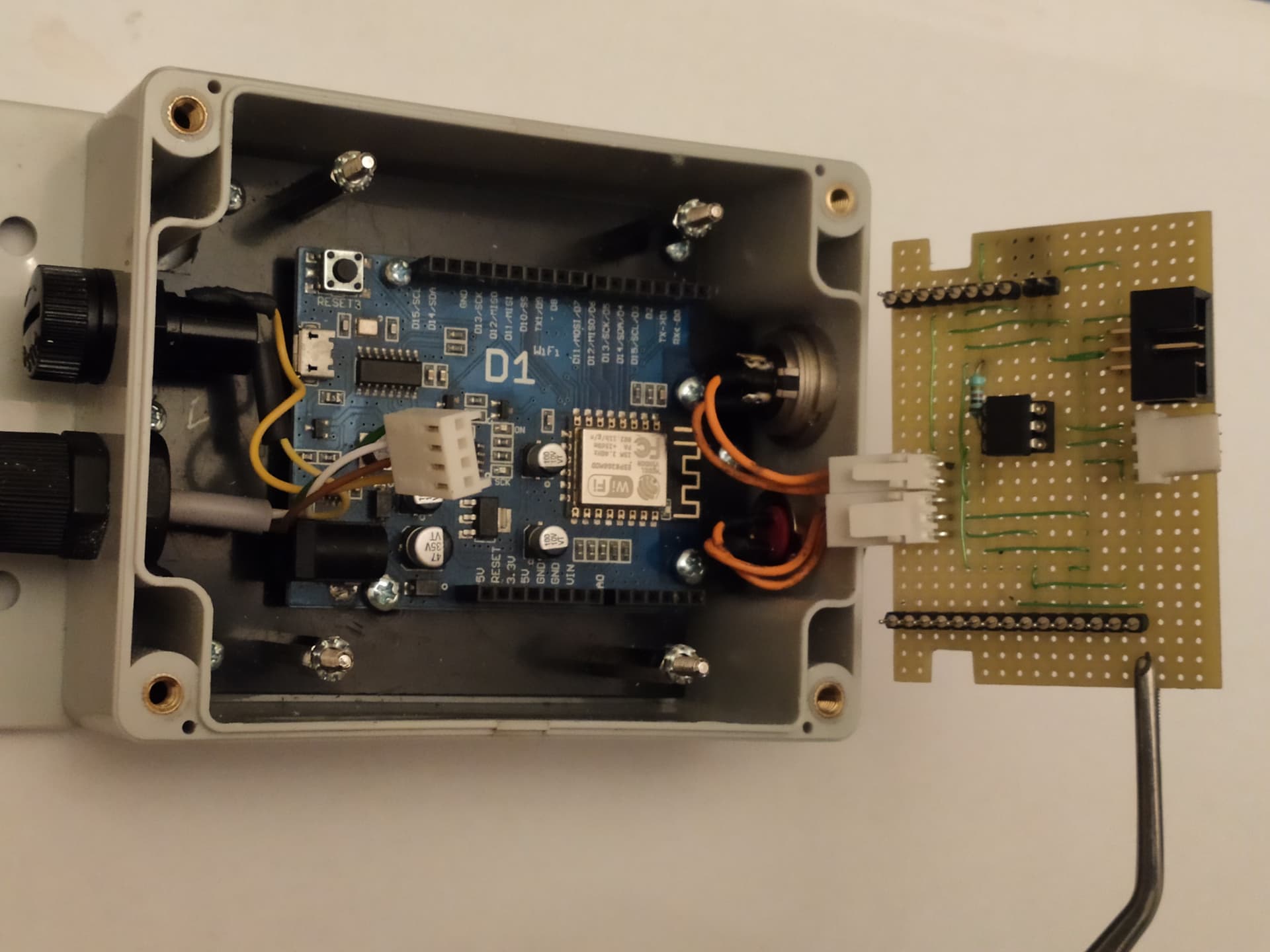

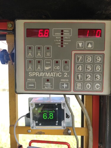

I need that because I’ve developped a UDP Wifi Display which generates the tick for the sprayer (based on ESP8266) See picture below.
(Previously tick was generated by magnet on the front wheel axle but was subject to slipping when muddy or uphill) Now it’s the “real” speed.

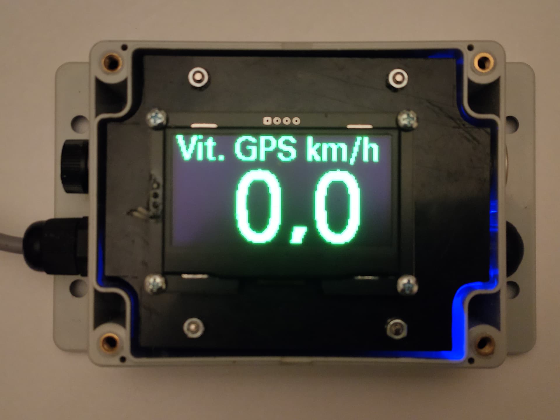

My system is full Wifi, so this small “box” does the following :
  • it receives the UDP Wifi PGN 254 bytes 5 and 6 from AOG
  • displays it on a I2C oled display,
  • generates PWM tick trough an optocoupler (to simulate the speed sensor on the wheel of the tractor)
I’ve used (less than 20 €)
  • ESP8266 Wemos D1 R1 because it has embedded dc dc suply
  • Green I2C oled display
  • optocoupler 6n137 on GPIO12 of ESP and on input of Spraymatic regulator
  • plastic box
Electrical connections are only 12 V supply and connection to input of Spraymatic regulator speed sensor.
On the fertilizer, it is used only to indicates speed because the 40 years old mecanical speed/rpm indicators are very inaccurate.
Francois
