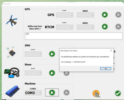

It will be impossible to connect to AGIO and also impossible to upload sketch in arduino IDE
but in serial monitor of arduino IDE we can see some message
AGIO message

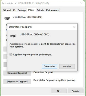

a second solution ( thta i can garanty) is to remove all drivers from the device manager
uninstall and suppr the drivers
and reinstall old driver 2023
