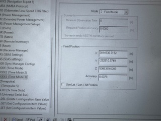

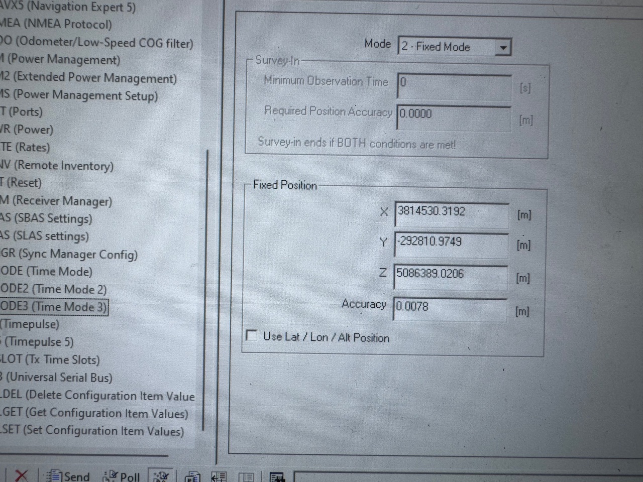

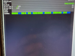

Hi, i’m new to RTK. I surveyed in and have used the coordinates to create a fixed base. Running the most recent firmware on both rtk2b and wifi master. But in the fix mode I’m getting time/dgnss. Is that right?
Your picture is blurred, but it look like you have put comma instead of dot in the position. Always use dot.
But use comma between two numbers in lat,longitude system numbers.
IF you used comma then your position of base is some hundred meters off, and that will cause float
Sorry i had to reduce the quality to upload, ive used dots.
IMG_0631|666x500
