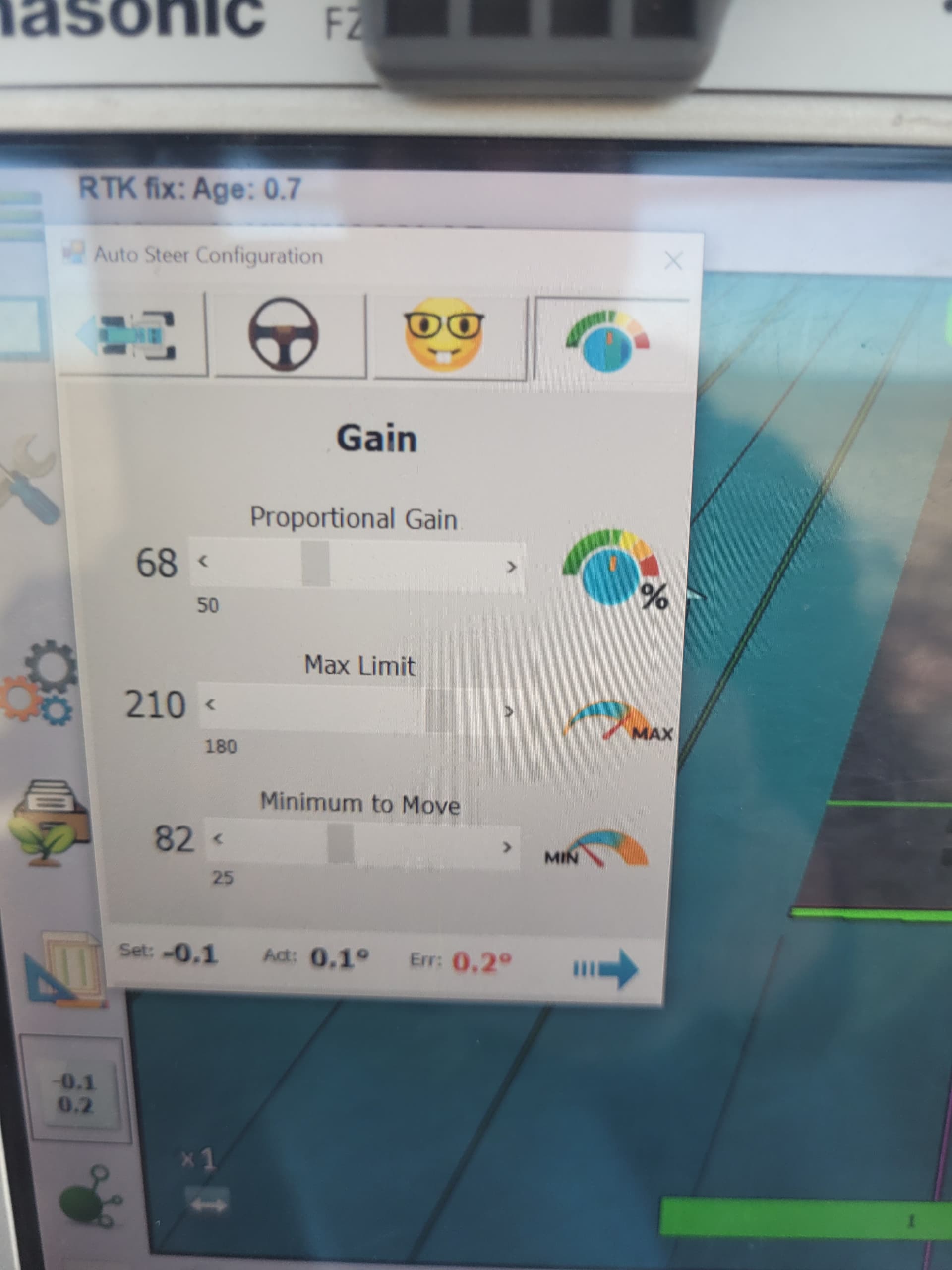

Does anyone have their settings that they could share? Seems like I’m missing something and can’t get it to drive straight. It always over corrects so it goes 2 inchs side to side.

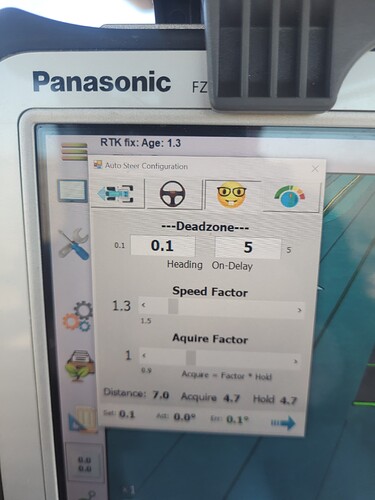

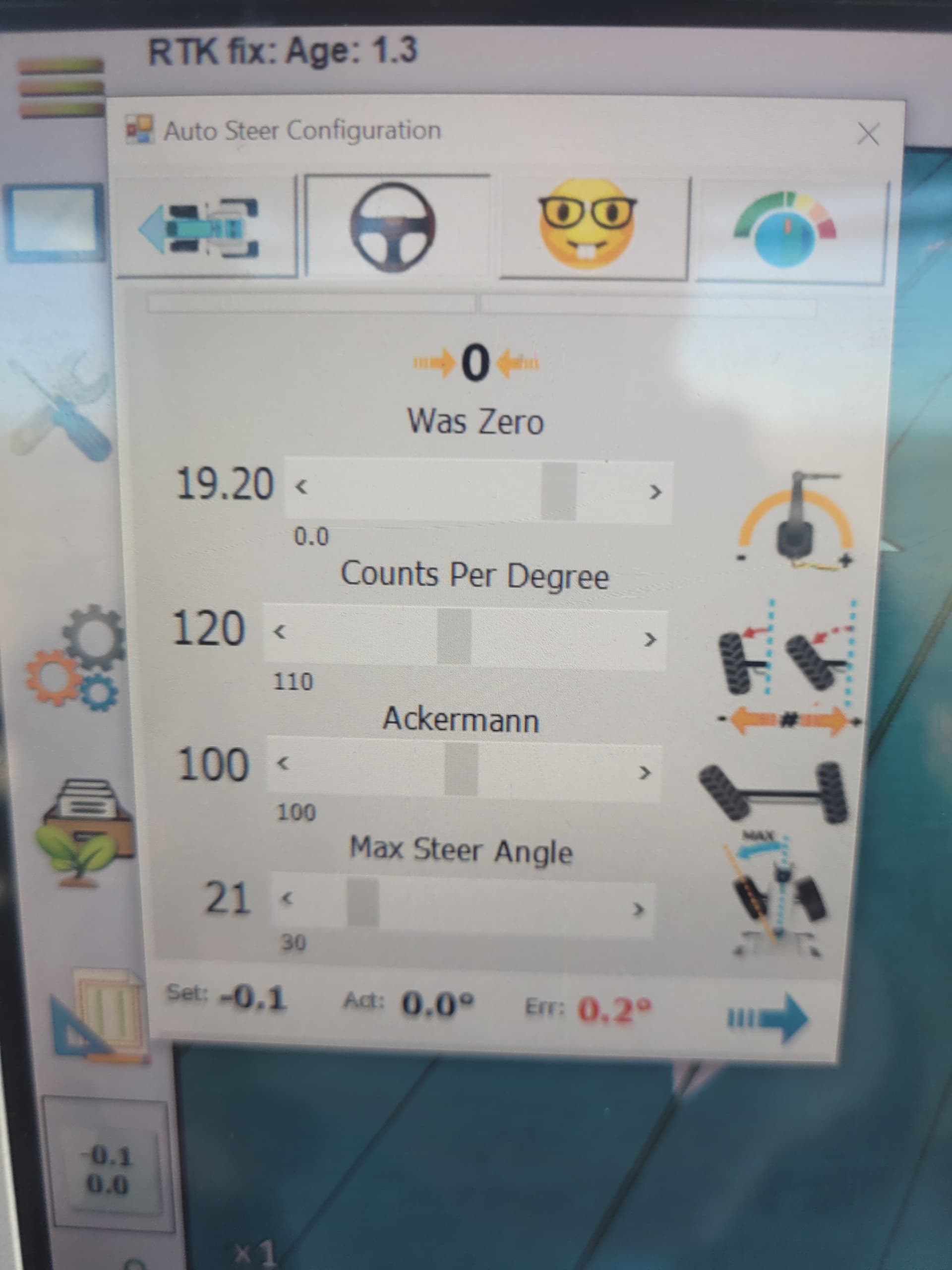

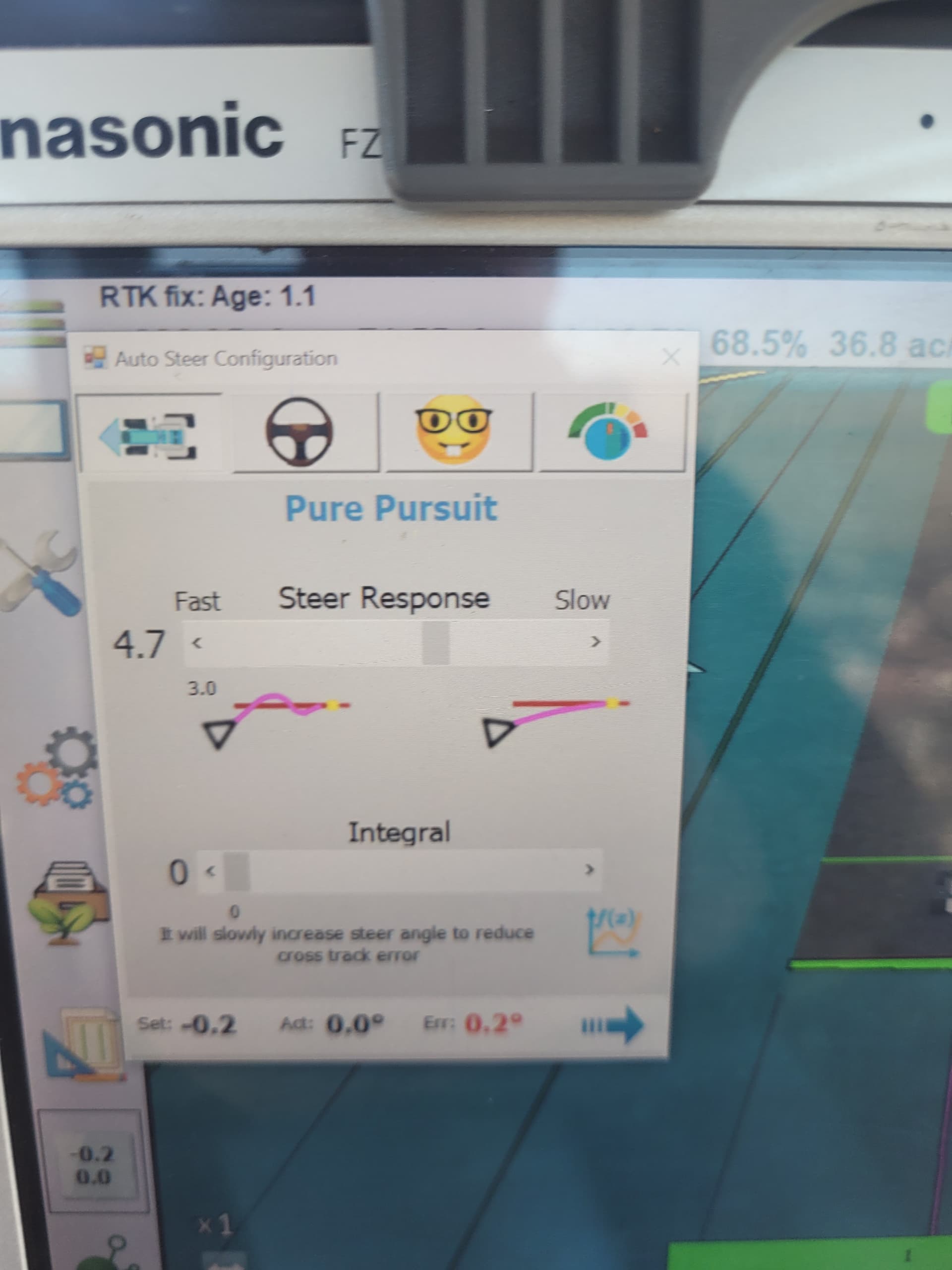

Here’s one more. Quad track with a Danfoss valve. Super happy with steering performance
Thanks for that. I turned up my max limit and it sure helped. What size valve do you have. I would like to add one on mine.
