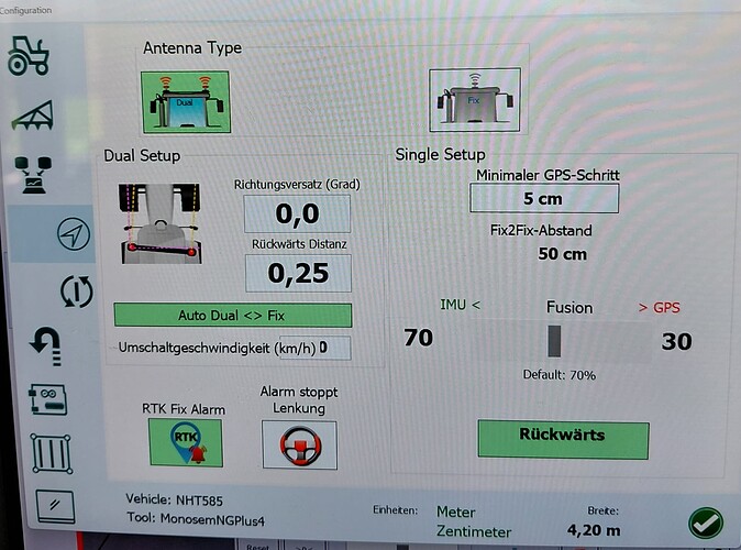

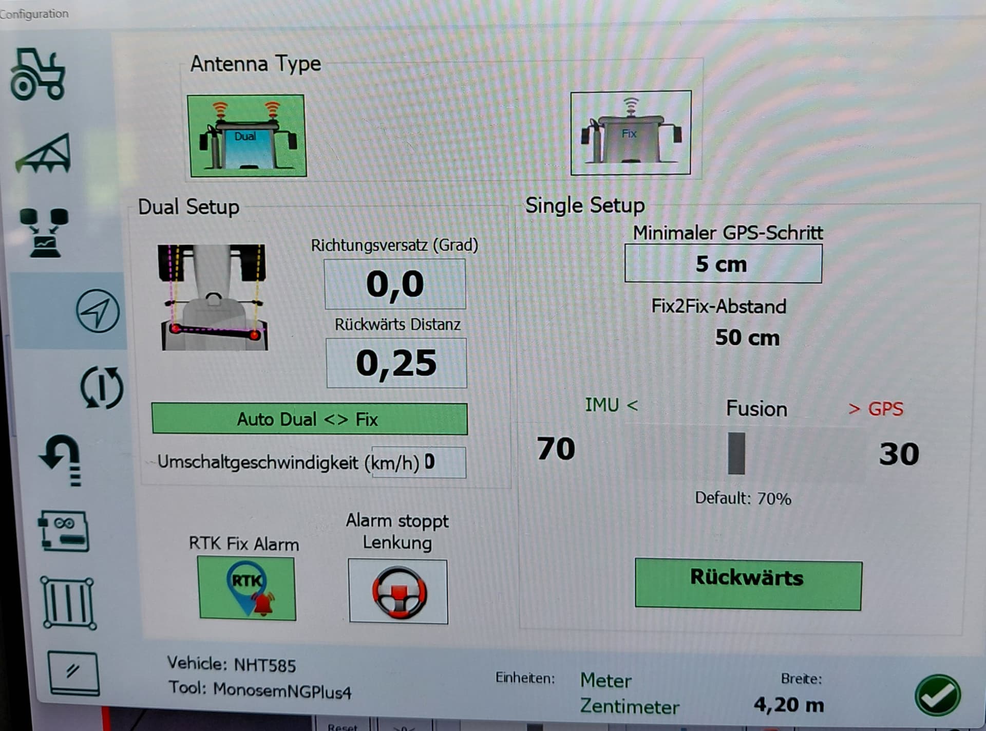

I have read about the auto dual fix setting, and that it could help in the sidehill as the heading is calculated from Gps and not the dual heading.
However i dont fully understand it, when i activate auto dual fix, the fusion slider appears. Does it have any effect in my dual system?

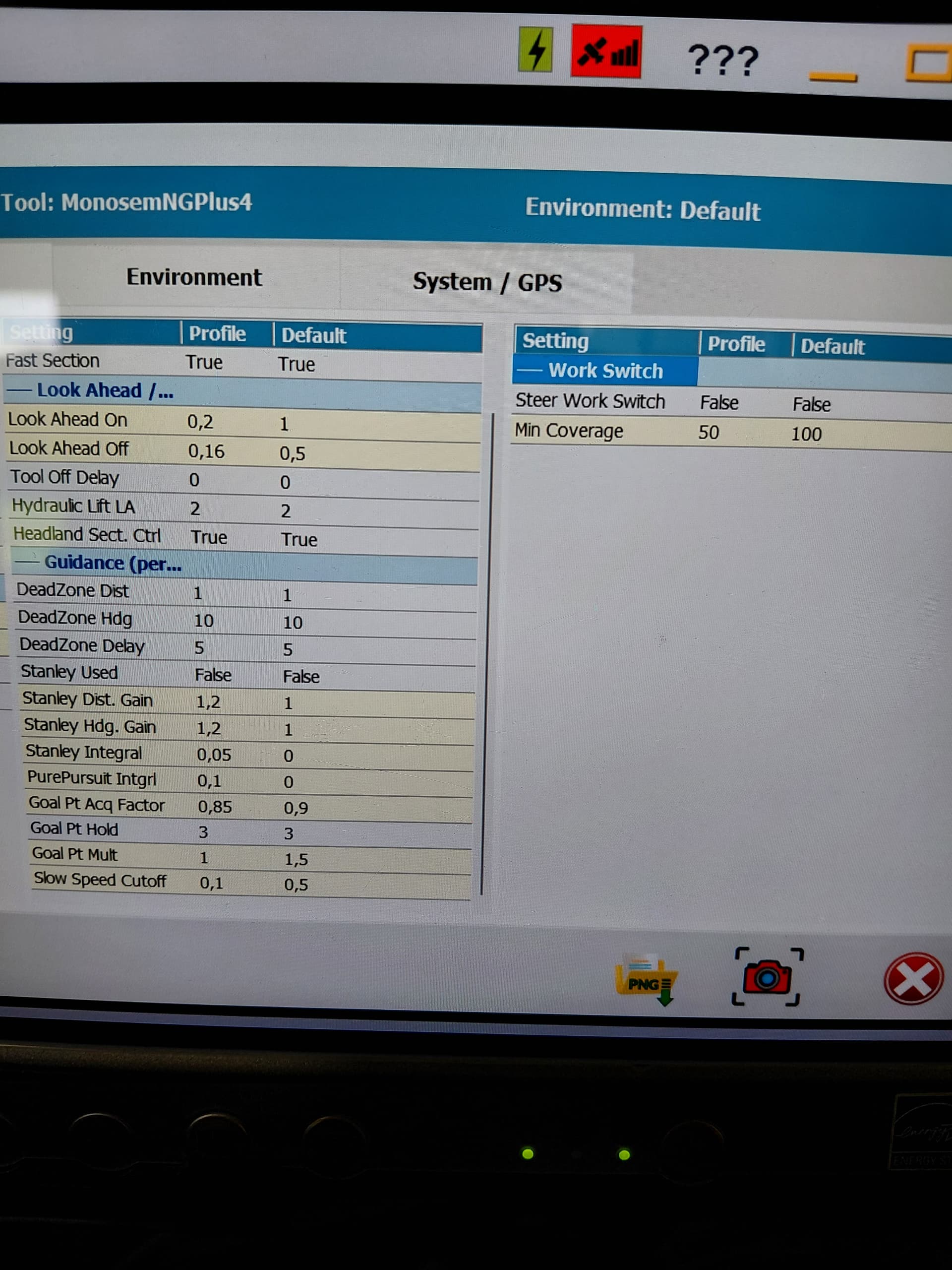

These are my system settings:
Please let me know if you have any idea how to improve the sidehill behaviour.

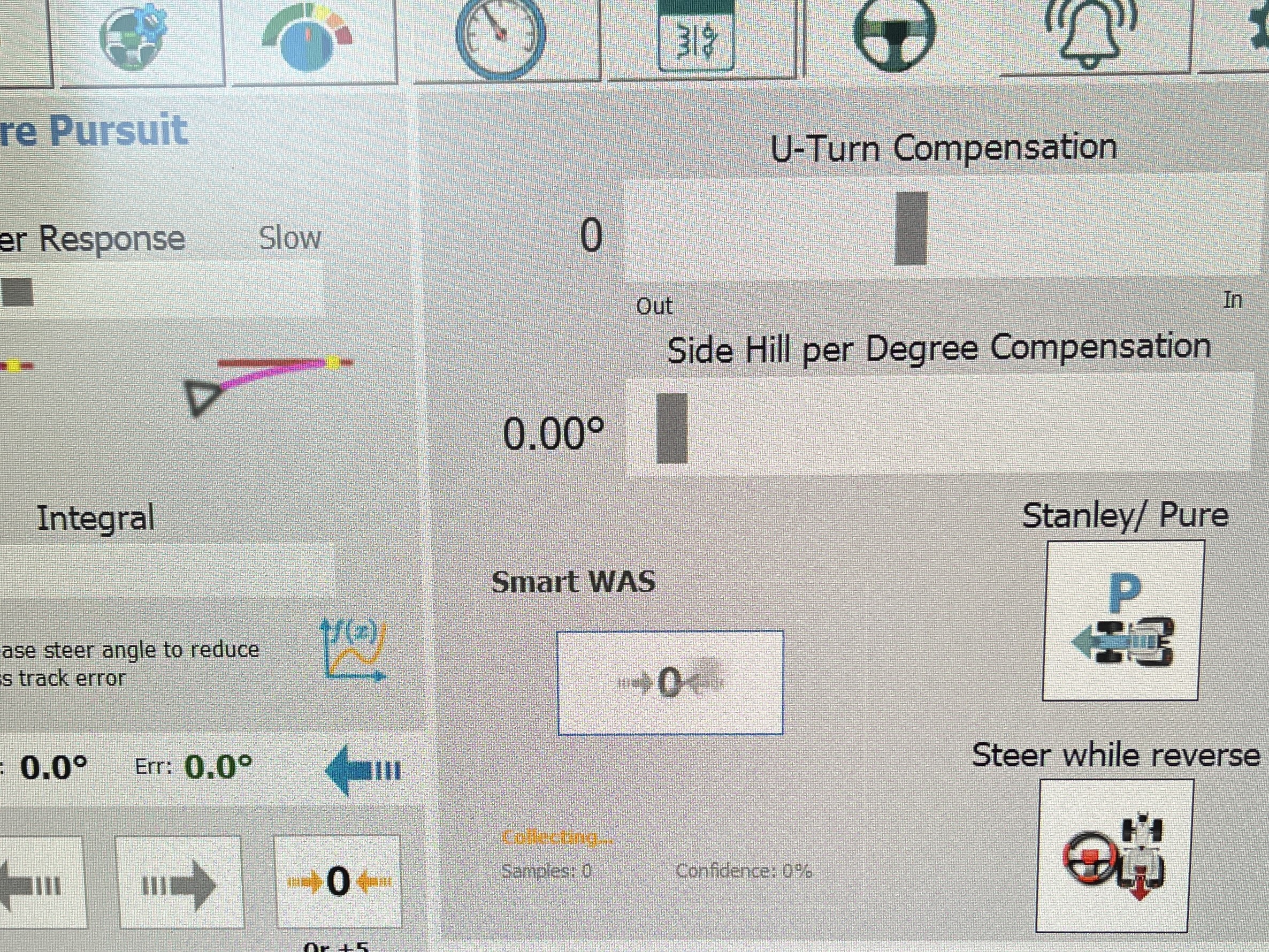

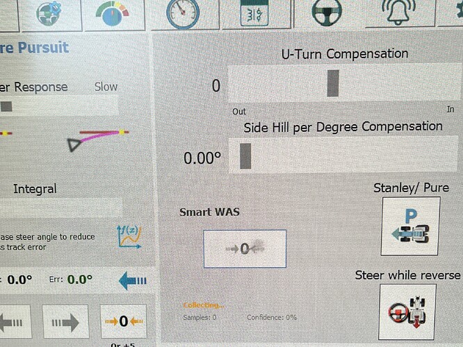

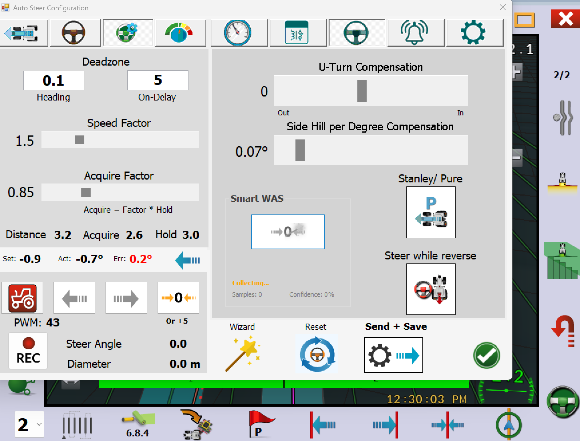

I don’t have experience with side hills but did you try , side hill per degree Compensation
Me either but i’m just trying to experiment and see how this works. I can’t find anything on how the setting effects the correction. I’m on a ~2.5% slope right now and I have this setting … I just guessed at this point. It is definitely not perfect but it is better. Any Idea how that correlates to slope directly?
I use dual setup, it needs a integral around 25 to use in slopes. You can try it
So integral in pure pursuit around 25. I will give this a go and see how it pans out.
