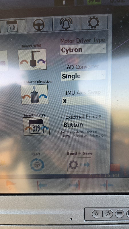

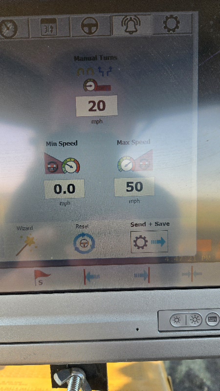

Ive got my autosteer on but the wheel motor won’t turn. Had it working yesterday. Don’t believe I’ve changed any settings. Any suggestions… I’ve jumped the on off switch for the motor and it still doesn’t changed anything.
Does it steer with the buttons on the cytron? I would look for connection problems. I don’t know what motor you have or how it’s wired.
Was a setting issue… reset to default and got it going again
