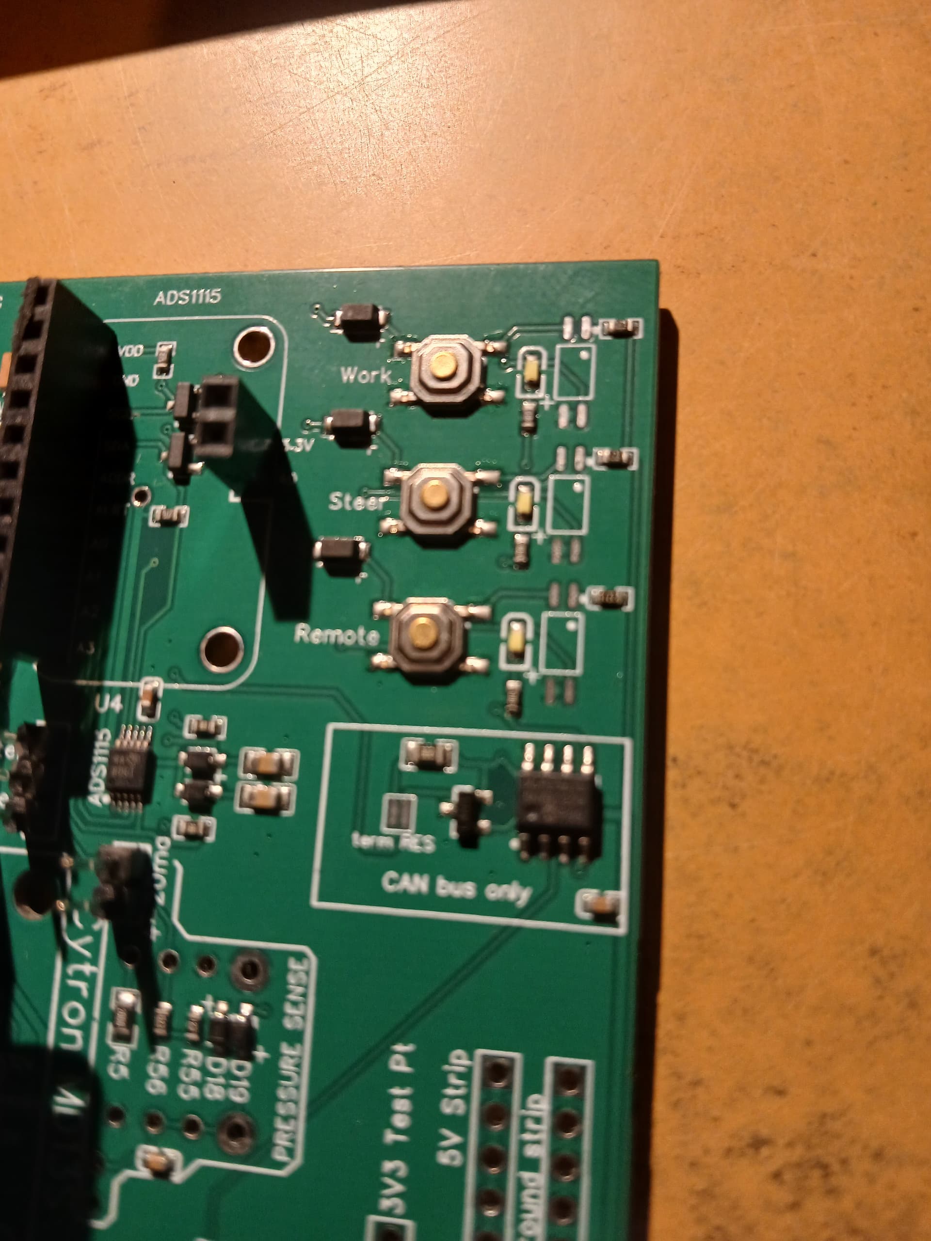

hi, I was wondering could anyone help me, I built a micro board, and can’t get autosteer working.
I have a phigets motor connected to cytron MD13S, when i press MA, MB the motor will turn, when i use steer wizard the motor wont work. the pwm1 led doesn’t light up , should it do so.
also is there any jumpers needed , thank you

If you are using the 4.5micro board set the engage option to “button” press the on board engage button. Do you hear a sound? If so set back to “none” for engage and power cycle the teensy.
On the valve settings page tap the fly out when you hit the tractor icon and it turns green does the PWM change?
yes its 4.5 micro board, there was no sound when i pressed the steer button, i then turned steer engage to none and then the motor started turning when engaged, so thank you i now have steering. it looks like my steer switch is faulty but i can work on that
Sometimes you need to select none send and save then select button again send and save. Might need a few cycles
What button are you using and how have you got it wired
its the button on the board i was using, when i got the board from jlcpcb there was some components missing which i ordered separately. the isolator next to the work, steer and remote buttons (el3h7) was missing i soldered them on and the led next to the work and remote buttons light up but not the steer one so i will replace that isolator and retest
Yes those isolators are needed for a remote button to work as well.
