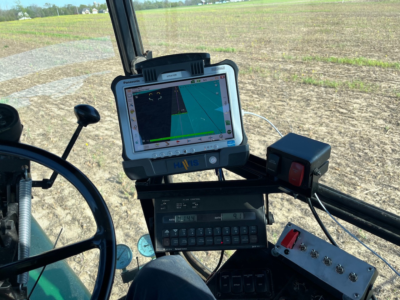

Sk21 rate control works well but if you disconnect the same thing will happen with the sections. I use getacs with the havis dock and had the same issue. I just cut two 1” squares of intertube and stuffed them between the top of the tablet and the dock so it couldn’t move at all in the dock. Seemed to solve that problem.

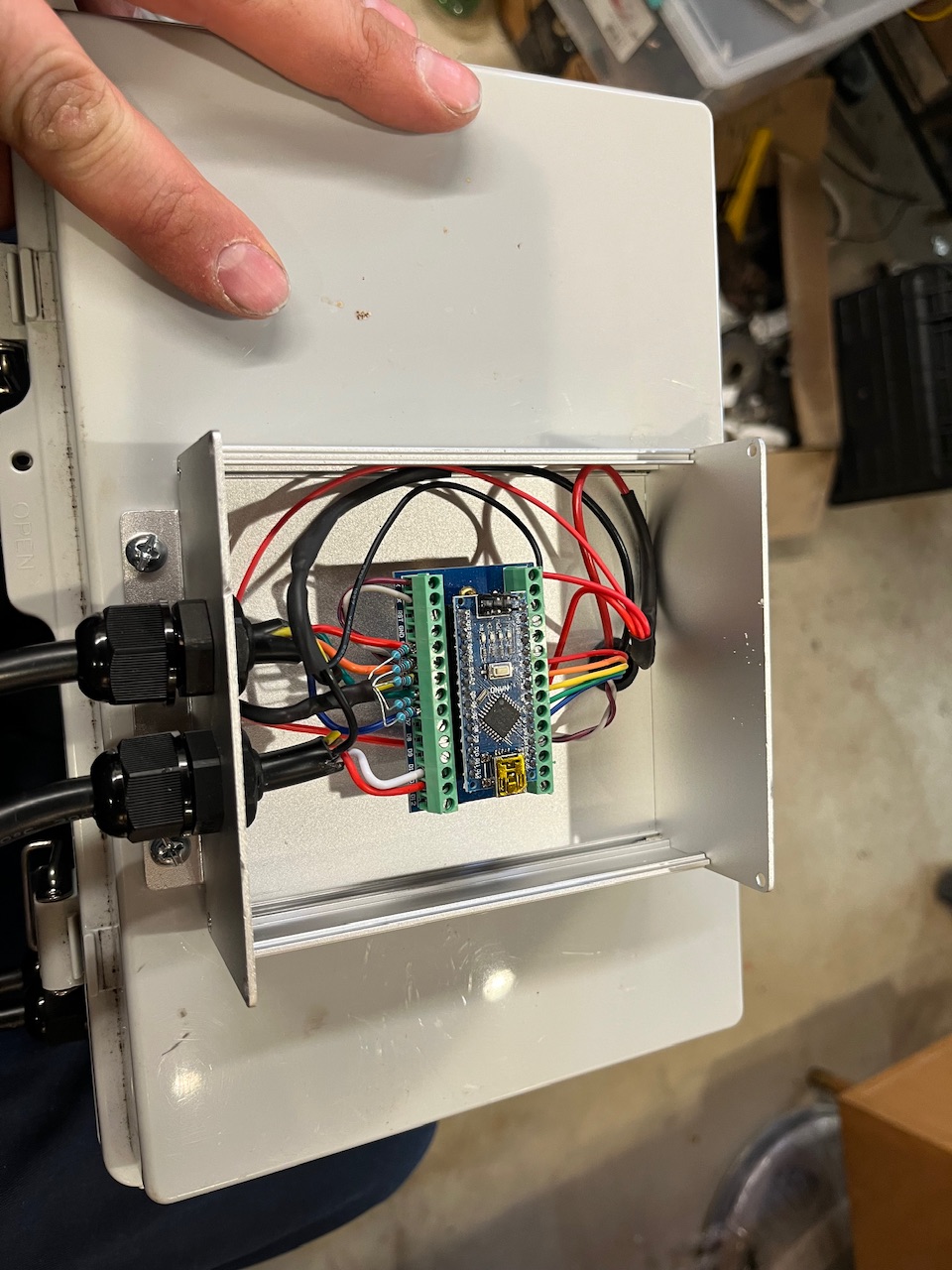

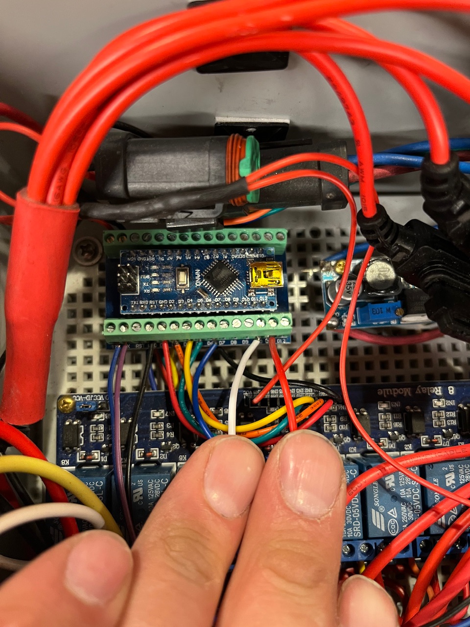

Thanks for the replies. I had some time to work on it today. The arduino nano used to be mounted in my section control box packed in tight with the relays and buck converter. I began thinking about it and thought that’s probably an electrically noisy environment. I moved the nano out of the relay box and placed it in a separate aluminum enclosure on top. I test ran it a while tonight and it seems to have solved my issues with the arduino locking up.
