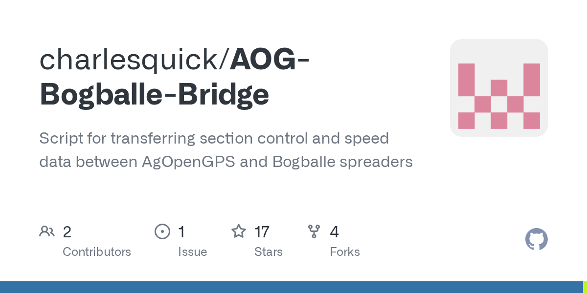

There is a post about using bogballe spreader with agopengps here but I don’t know more
It wouldn’t hurt to try, in theory it should take gps speed and start spreading when gps tells it to. In my case i used the charlesquick bridge last season for well over 900ha and it worked flawlessly. :slight_smile:
Update it to the latest firmware, can share a link if u want.’
Thank you, can you send me the link please ?
I will try
the same github link that u sent :slight_smile:
OK thankyou,
What controller are you using with your spreader ? :smile:
I have calibrator uniq controller. Just update your controller to the latest software before trying with AOG
I tried but it looks like doesn’t work with the ICON, how did you install the bridge ?
Did you follow the github instructions and updated your icon controller to the latest firmware?
Yes I upgraded it but I can’t execute the .exe, I can’t run it with python
