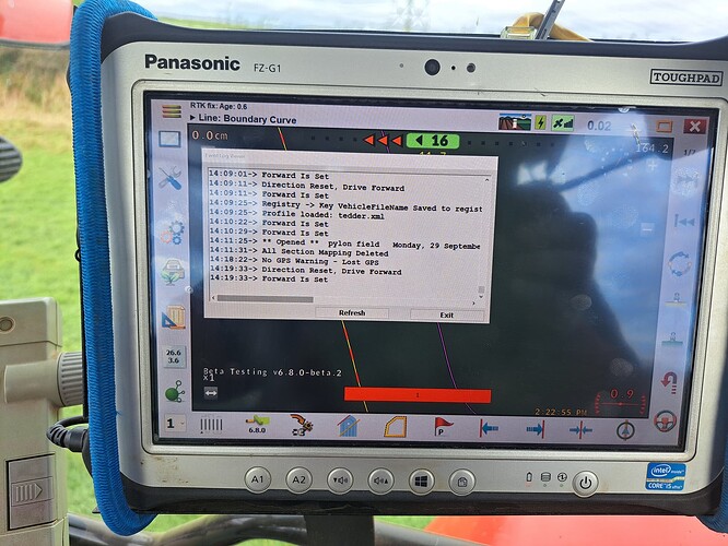

Just a quick 1 about 6.8.0 beta

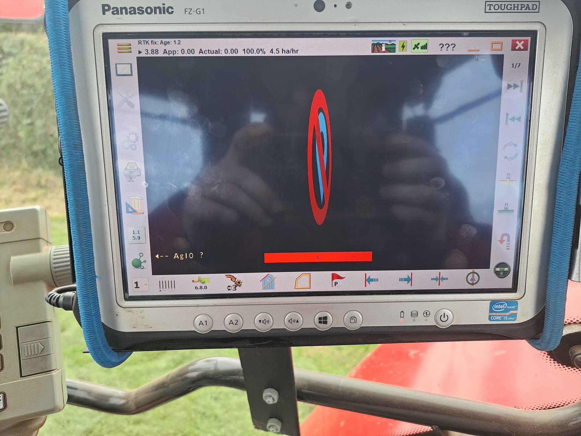

Think it was 3 time yesterday and twice today ill be workimg away then sterimg goes awol
noticed today rtk bar goes red but as soon as i look at it it goes back green and everything back to normal​:man_shrugging::man_shrugging:
This does not happen with former version?
seen it happen then 1 time

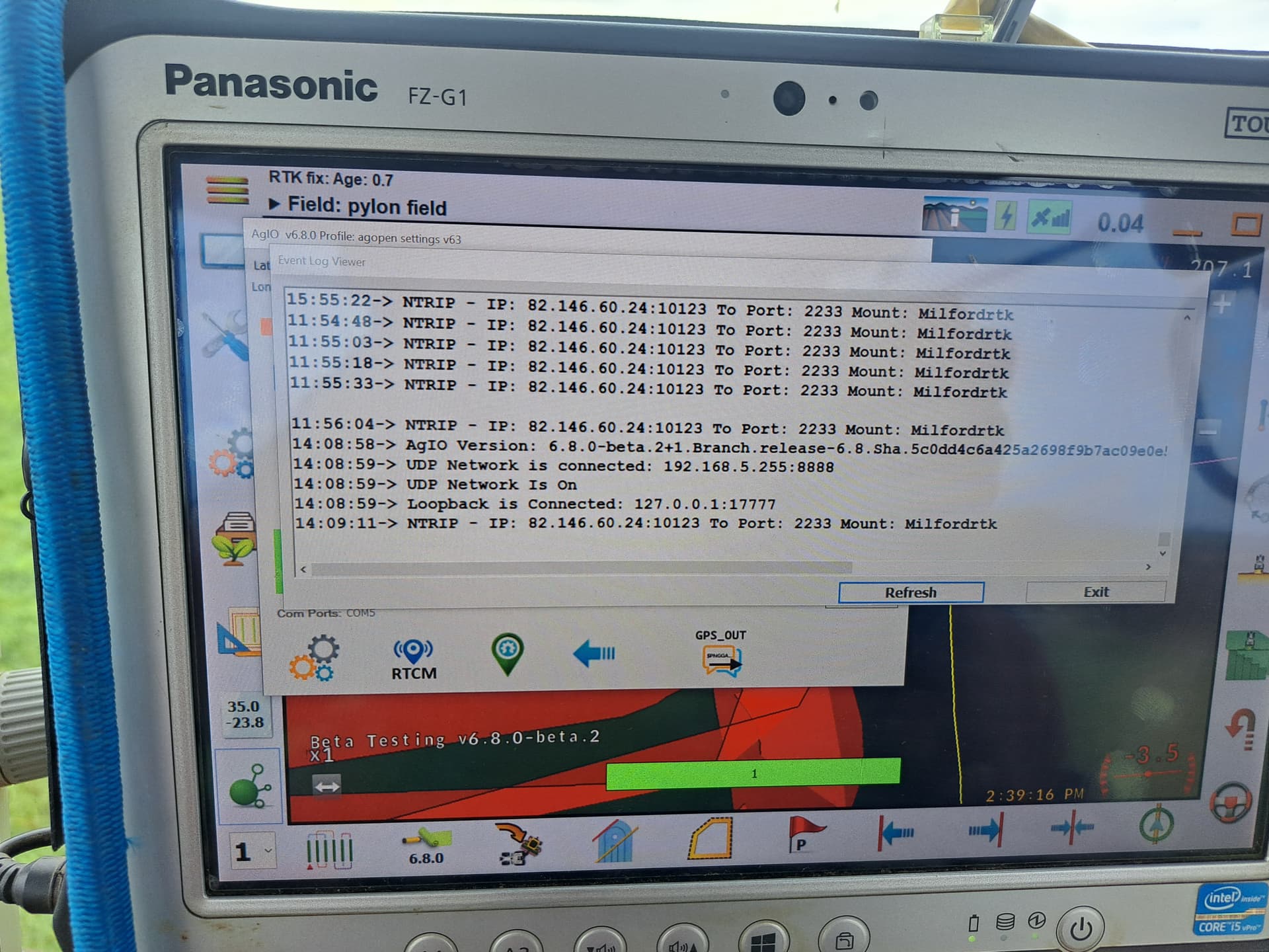

Agio went offline and restarted a few seconds later
no, not done this before

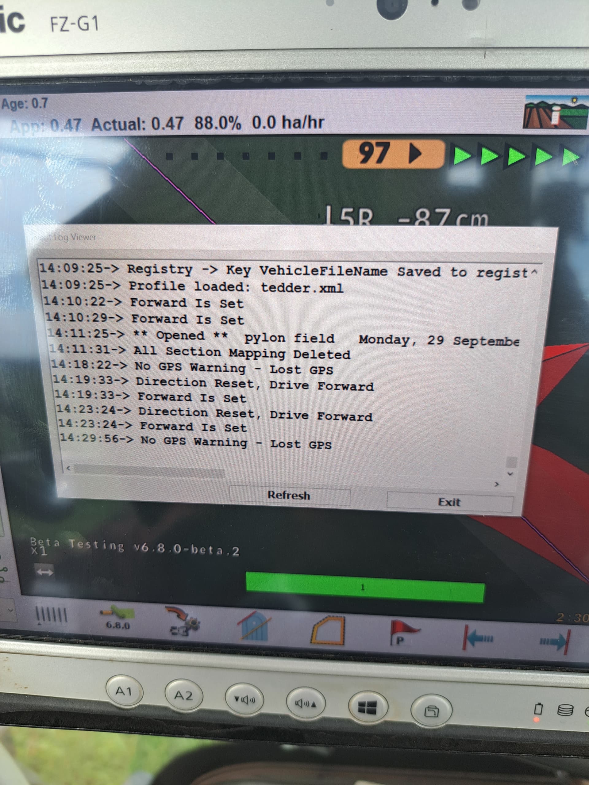

Does this help any?
EDIT
think ive.found the issue my end with a loose fuse by battery
