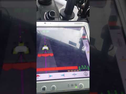

I had the main master switch on the pillar on and lite up. Tried with and without the faststeer button engaged. Ive had everything steering but could only engage via the tablet.
Had joystick button set to autosteer aswell.
