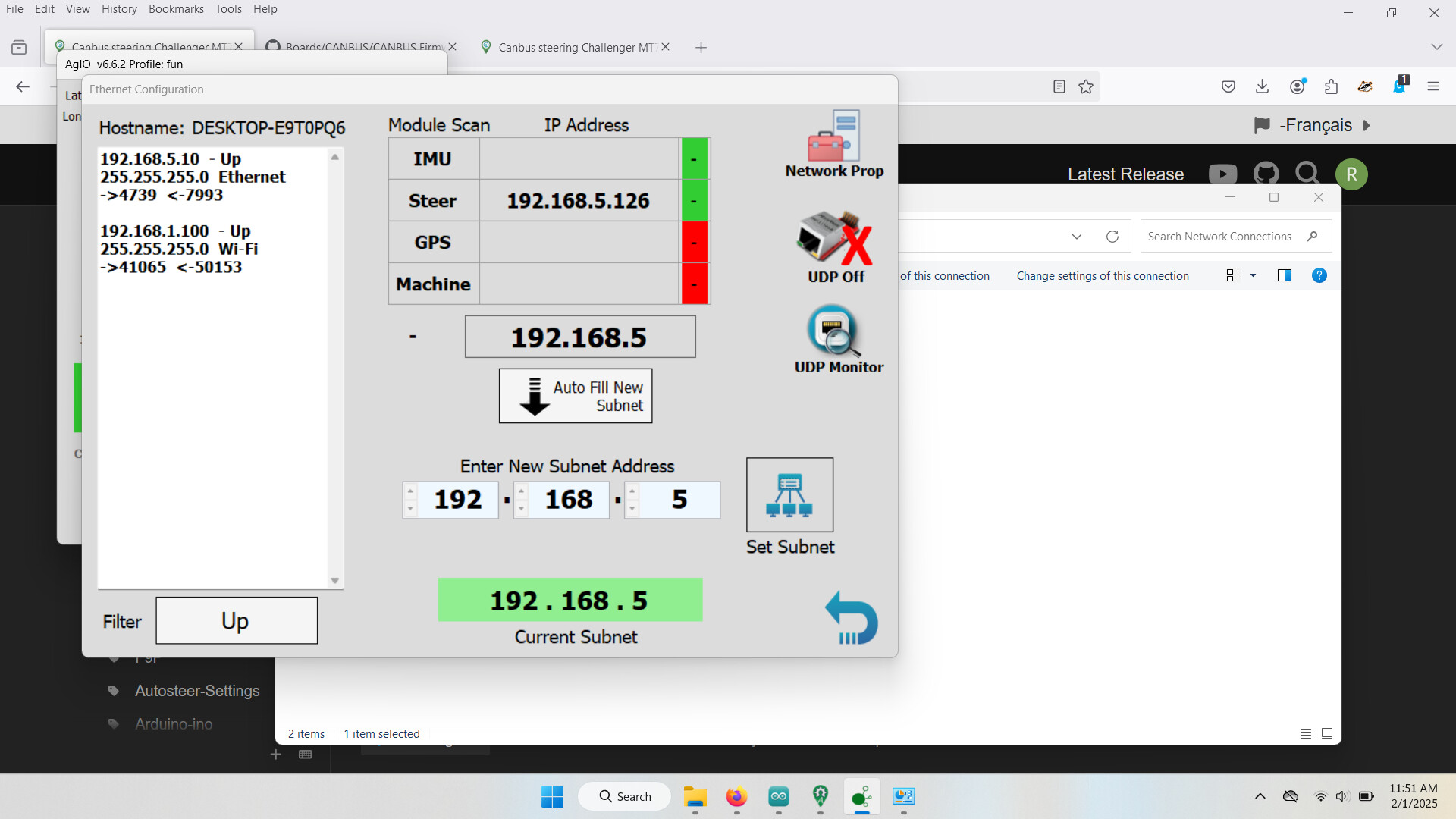

I got that the program loaded for the CatMT late. I get the steering and IMU to get a green light but I dont get a gps and machine.
Turn the udp on?
Did you set panda mode in serial monitor? P then send for 406800

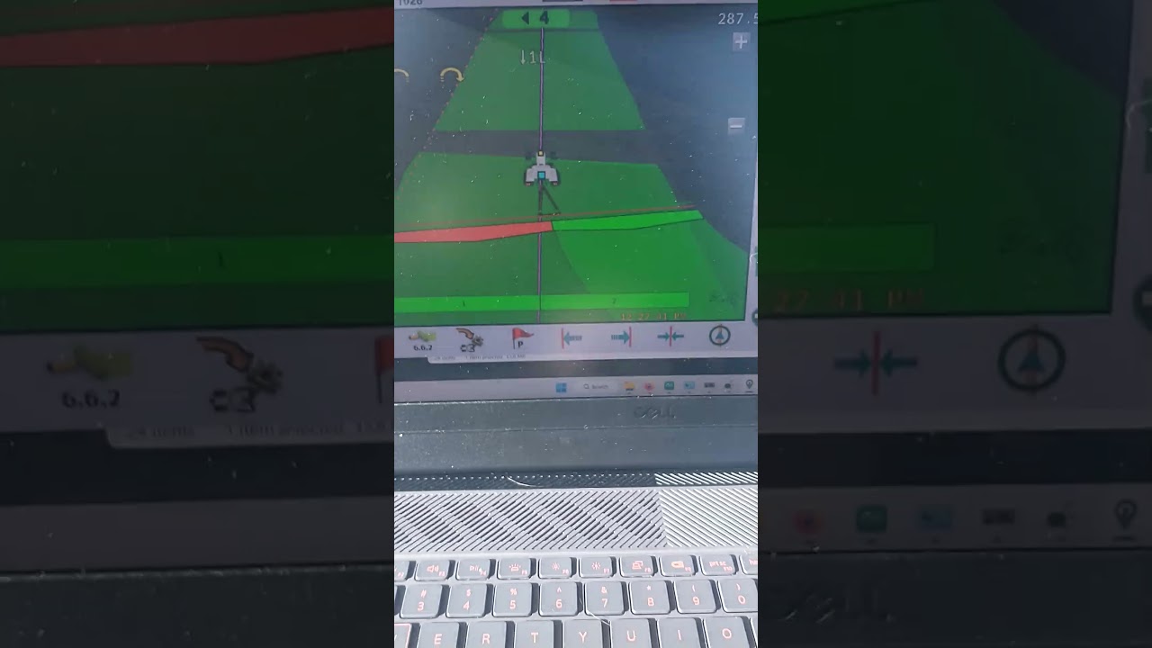

Thanks for the help. I got it work. I got a crappy video of it going that I’ll try to get posted. I’ll get some more later.
What was the problem after?.
Looking forward to pictures and videos :ok_hand::+1:
Had to get the Panda set. I wasn’t getting a GPS signal and I had read in one of the forums somewhere that the MT doesn’t put out a WAS reading unless the tractor is moving.

I got the joiner in between the plug and tried different ino’s and tractor types with no luck. just noticed that in your video your roll indicator goes green mine doesn’t. seems like maybe I’m not getting through to the tractor.
Bear with me its been a hot minute since I’ve messed with any of this. After setting your brand you need to set the panda and baud to match your F9P. As for the 4 pin plug, the green(low) and yellow(high) wires are the can wires, red(12V power I power my board from this), and black(ground). I put an inline fuse to after the pigtail to protect the AIO board.
