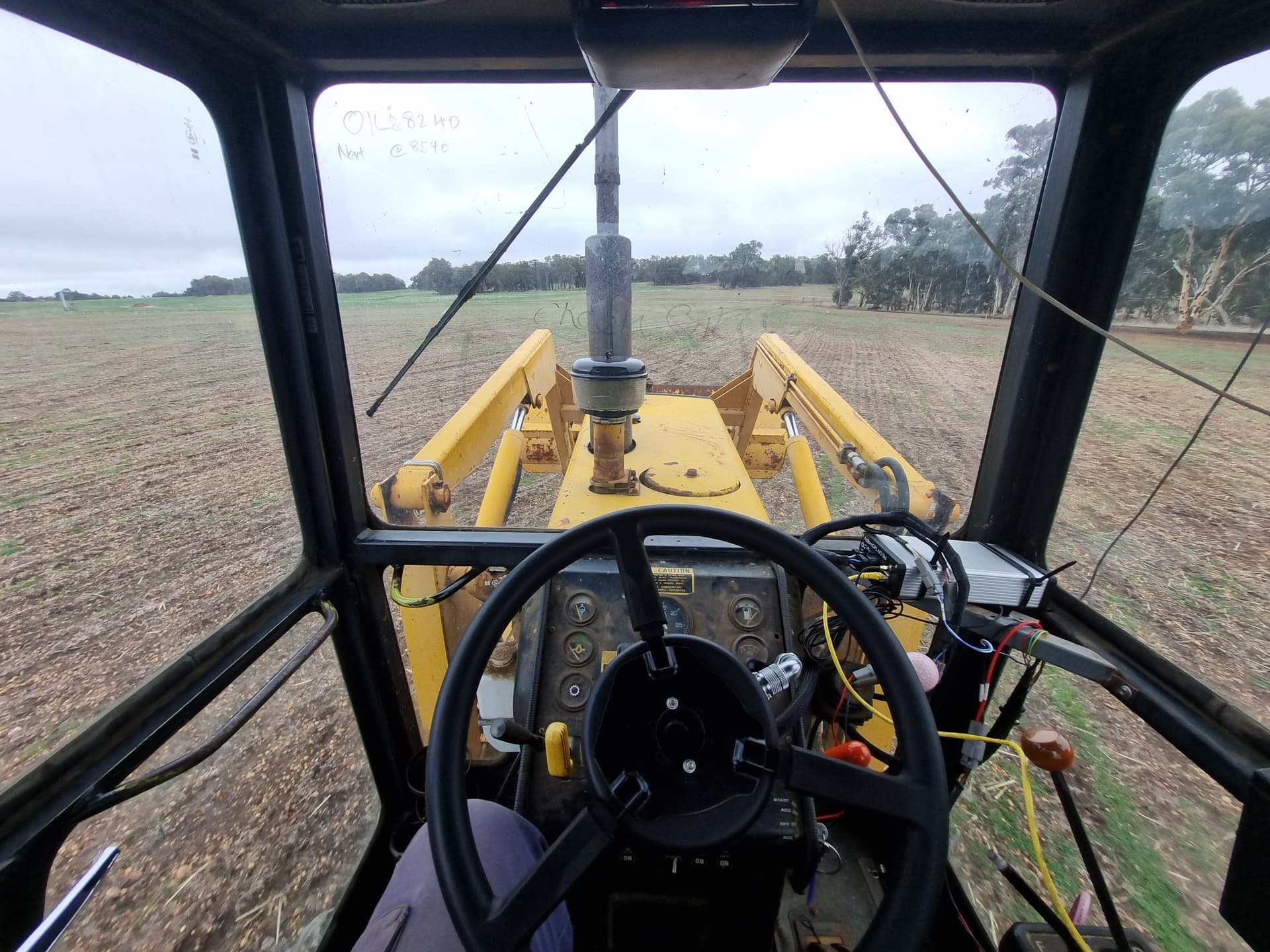

After a few months of testing software, wiring, etc. I finally was happy with it and threw it all at my tractor, a Chamberlain 4080.
Details are:
• Keya gen 3 with John Deere style adapter

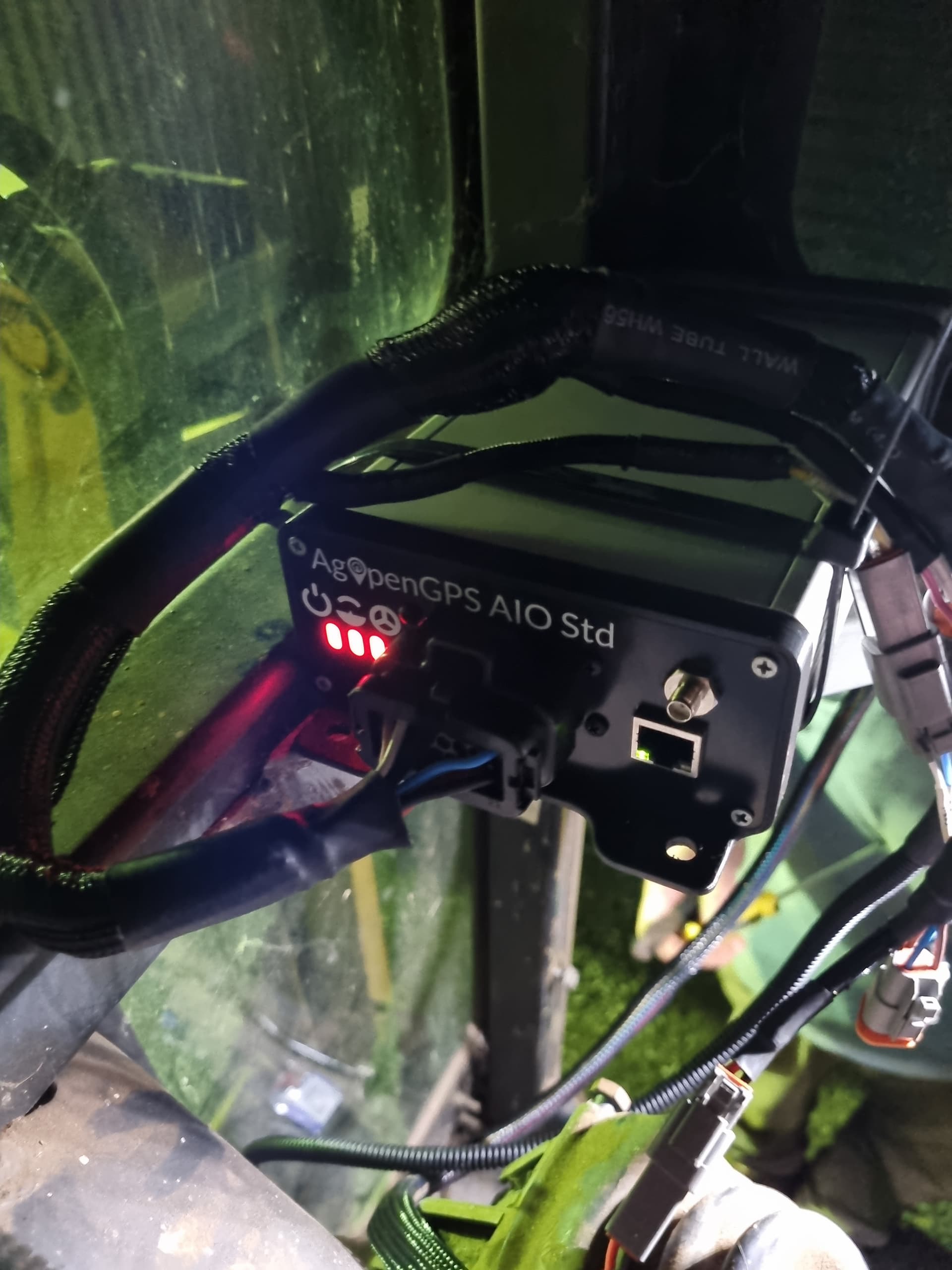

• PCB v4.5, F9P, IMU (running free to air/no correction)
• Dell XPS15 (temporary, a dedicated tablet is being decided upon)
• Land Rover style WAS
Some more time spend dialling in the steering settings are needed, to get the driving a bit straight and accurate is needed. I had some problems with the steering wizard so another go at that to help.

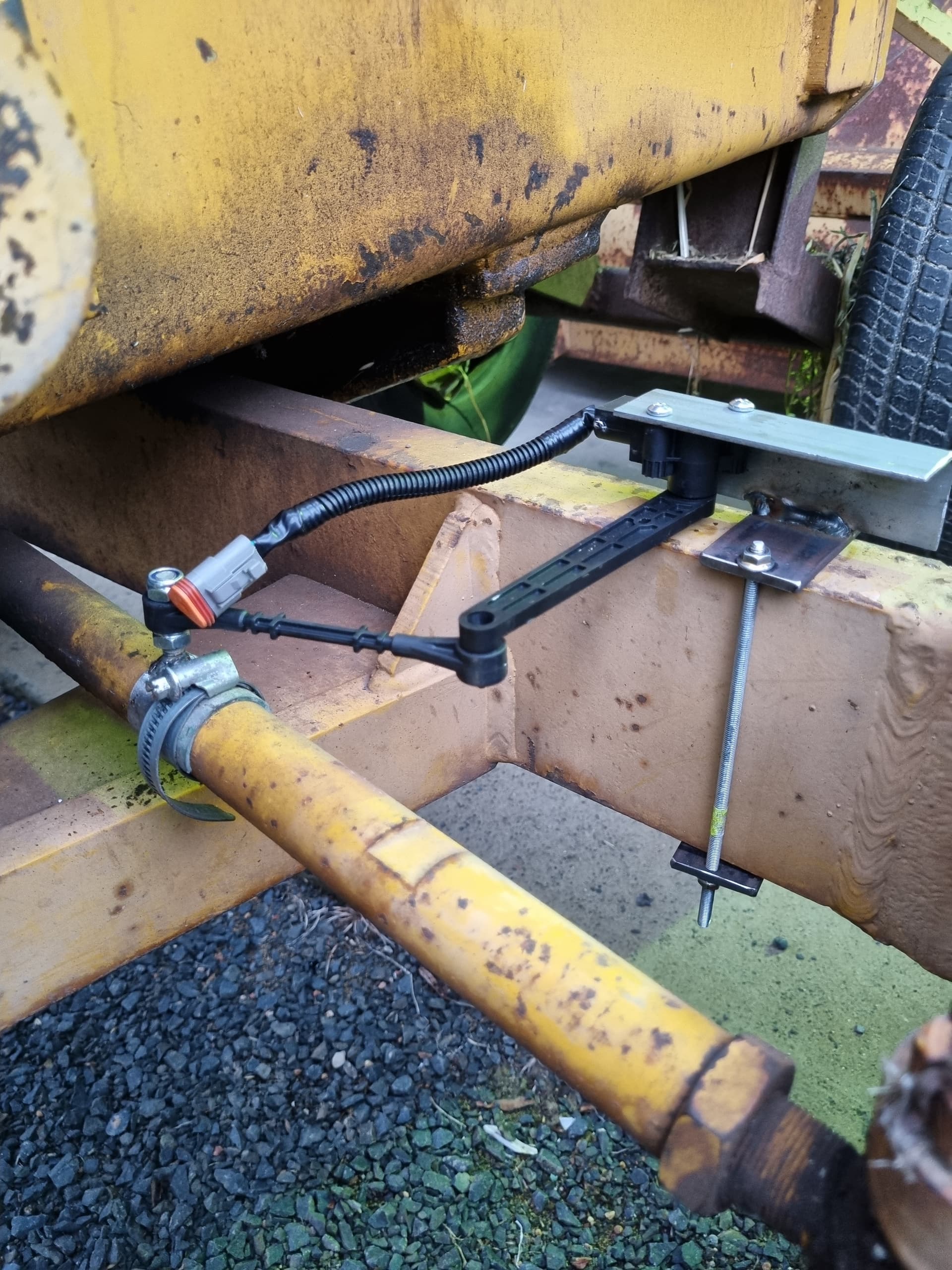

My WAS bracket isnt lined up properly, as at full left lock the sensor goes backwards and doesnt read, and needs to be physically reset, so some fiddling with that to get it working in full range of motion is needed too.

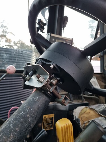

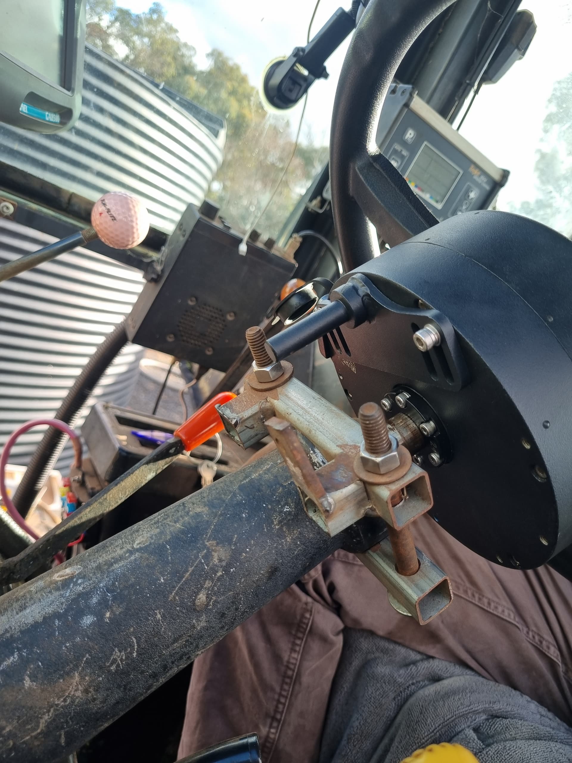

The Keya motor is a great thing! Super easy to wire up using the provided harness, flashing the teensy is the hardest part! I was able to repurpose a bracket i had made for an ATU200 that was used with a Leica MojoRTK system (that never actually worked).
I had some issues before it would actually work, dont know what the cause was, but eventually got it going. In the future, I think some keya specific settings would be great (such as motor driver option, to help with confusion if nothing else), and a way to tell from AOG that it is communicating with the Keya, to help with trouble shooting and fault finding. They provide a nice, trouble free, OEM style option that makes installs neat and clutter free, so I think further incorporating them is a no brainer.
I cant quite seem to dial the manual override in to the point where it can steer properly and I can still grab the wheel to over ride it, again, likely more trial and error.

Install version 2 will include relocation of all the wiring and PCB to the roof to get it out of the cab, just having keya wiring and an RJ45 passthrough for the tablet so that there is almost no trace of the system.
As well as a DB9 serial plug to provide gps signal to my Rinex section control box, before i dive fully into AOG rate/section control.

Whoever is running a AIO board and a Keya and don’t like the current cutout give this a try and see what happens.
Note: You must use the serial cable and there software to turn the max current down to 4-5 amps (enough to turn wheel, but be able to stop by hand)
Set the current cutout option in AOG to about 15, then it should only stop when you turn the wheel by hand. It’s speed related not power/current.
Ive read about this new firmware for the keya where the overide setting is changed to make it easier to disengage so might be worth looking into.
