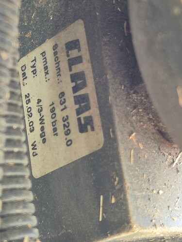

I have a Claas Lexion 480 with the factory autosteer but want to set it up with an AIO board, has anyone done it and how straight forward is it?
This is the valve that is in it

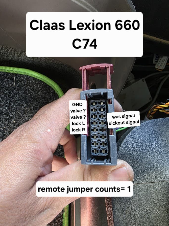

This was pretty straightforward:
