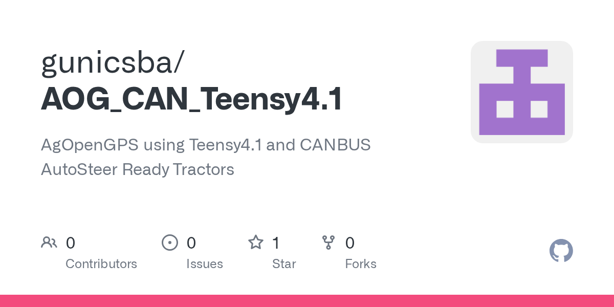

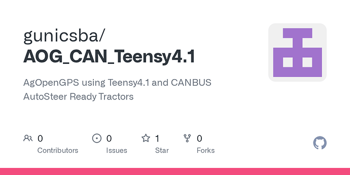

I gave Claude a task. Not sure if it works or not but feel free to try:
