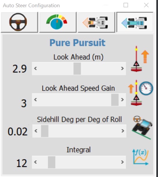

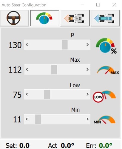

Thanks for that. This is what i have so far. It holds the line right up till about 10 mph before it really starts wandering.
