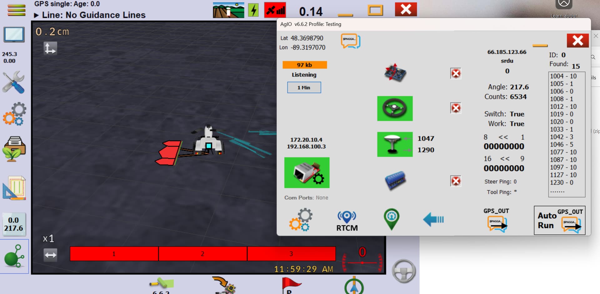

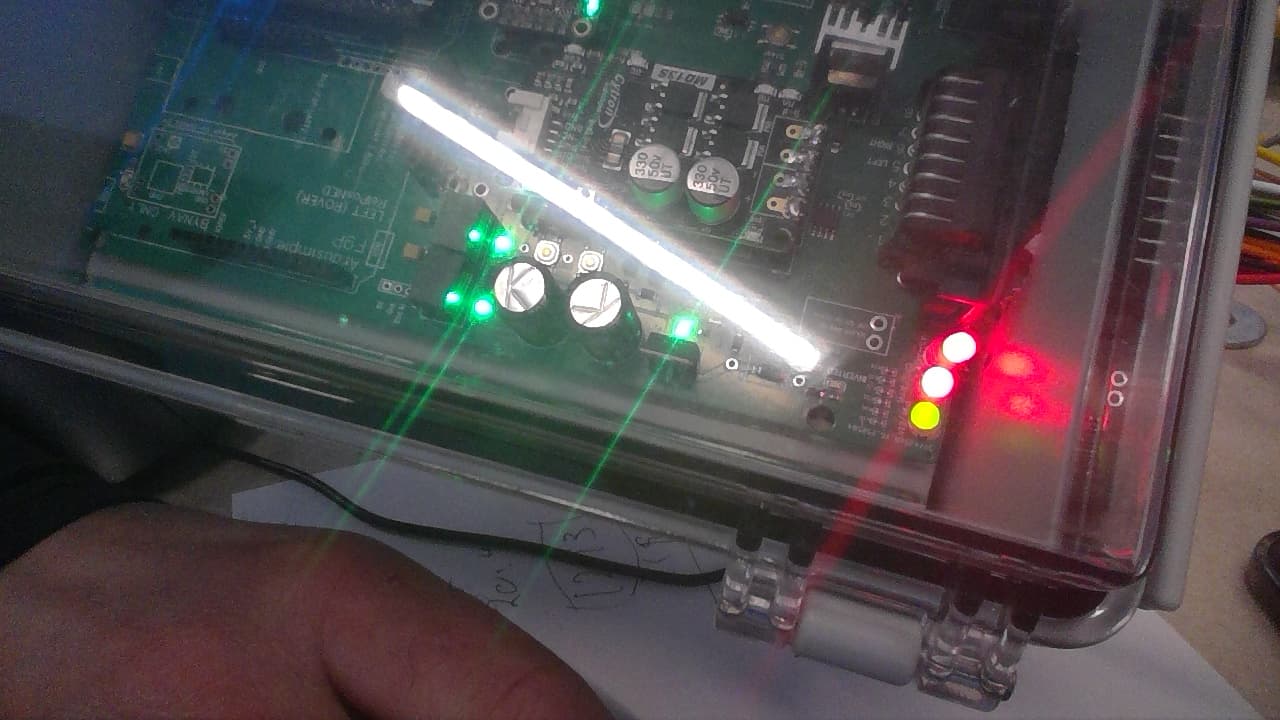

I’m trying to set up a RTK base station using centipede. I have not registered my base station with centipede yet because I’m still testing stuff and it’s not in it’s final location. Despite this I think I’m still accessing the data but I’m not confident, the AGio application shows up as connected like the doc.agopen website shows but the board LED status is red for GPS with no RTK. Am I connected to RTK data or do I need to register with centipede first?
AGio
Board LED
No you don’t need to register the base to start using it.
It doesn’t look like you have any messages coming through there.
Maybe try connecting to another base locally.
I’ve tried to connect to your base with the ntrip checker app and couldn’t.
Maybe show the ntrip page.

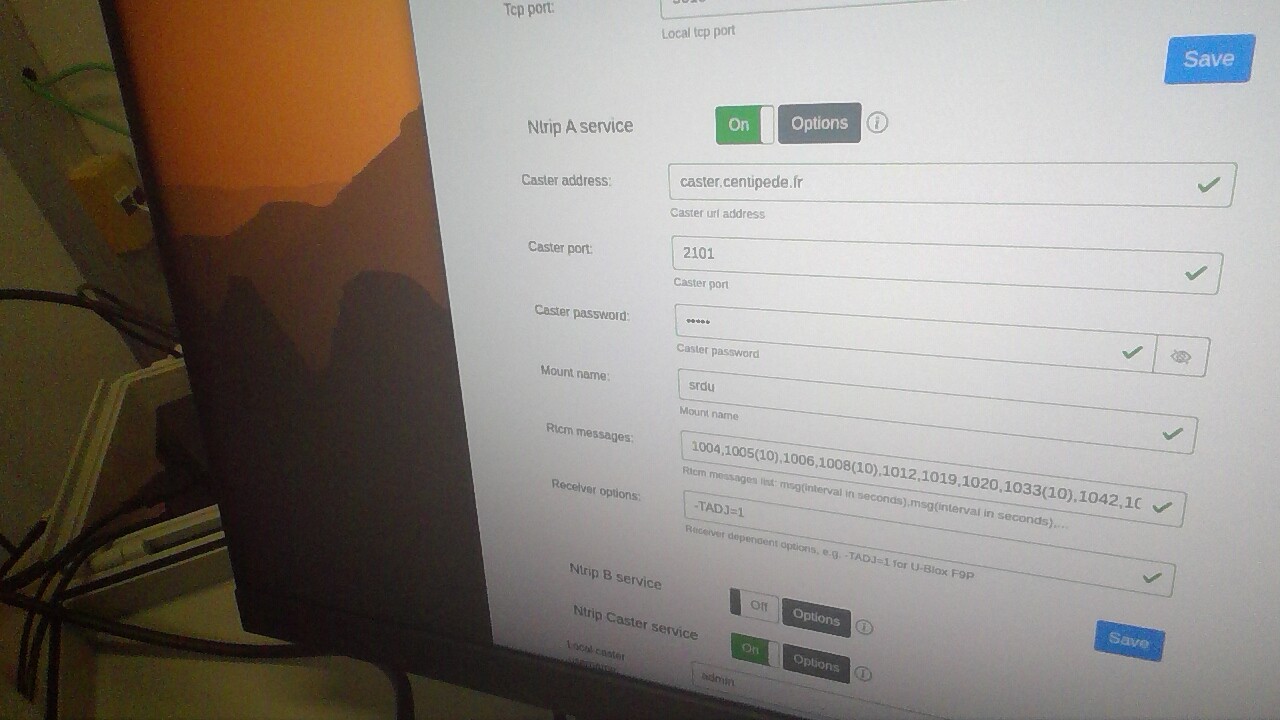

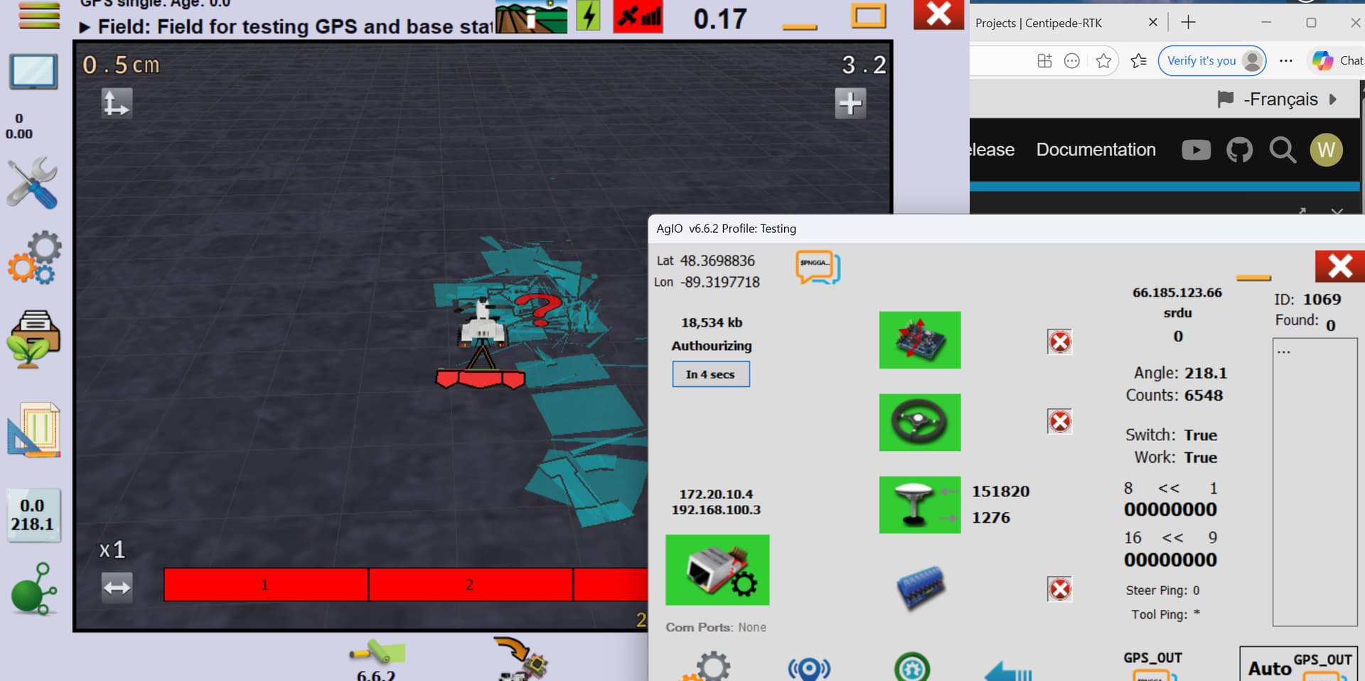

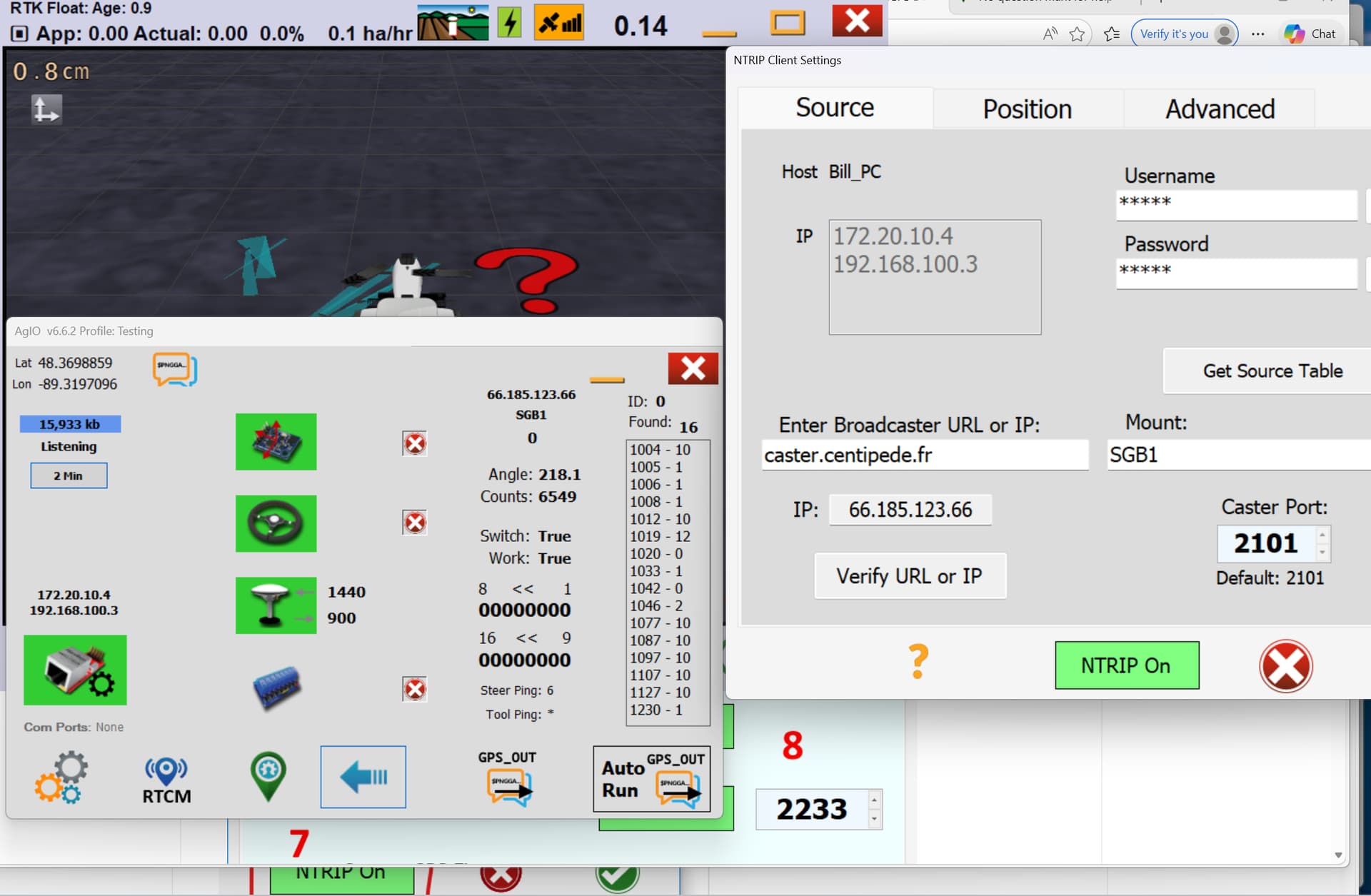

Hey. I tired using an existing base station and it seemed to work. The LED status in the board did not change to green but the age of the connection started to climb. Here’s a photo.

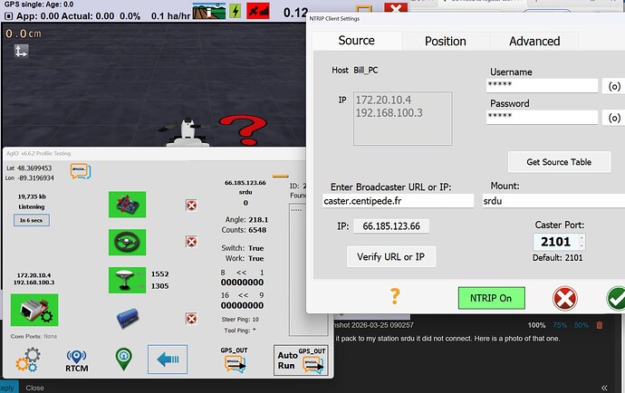

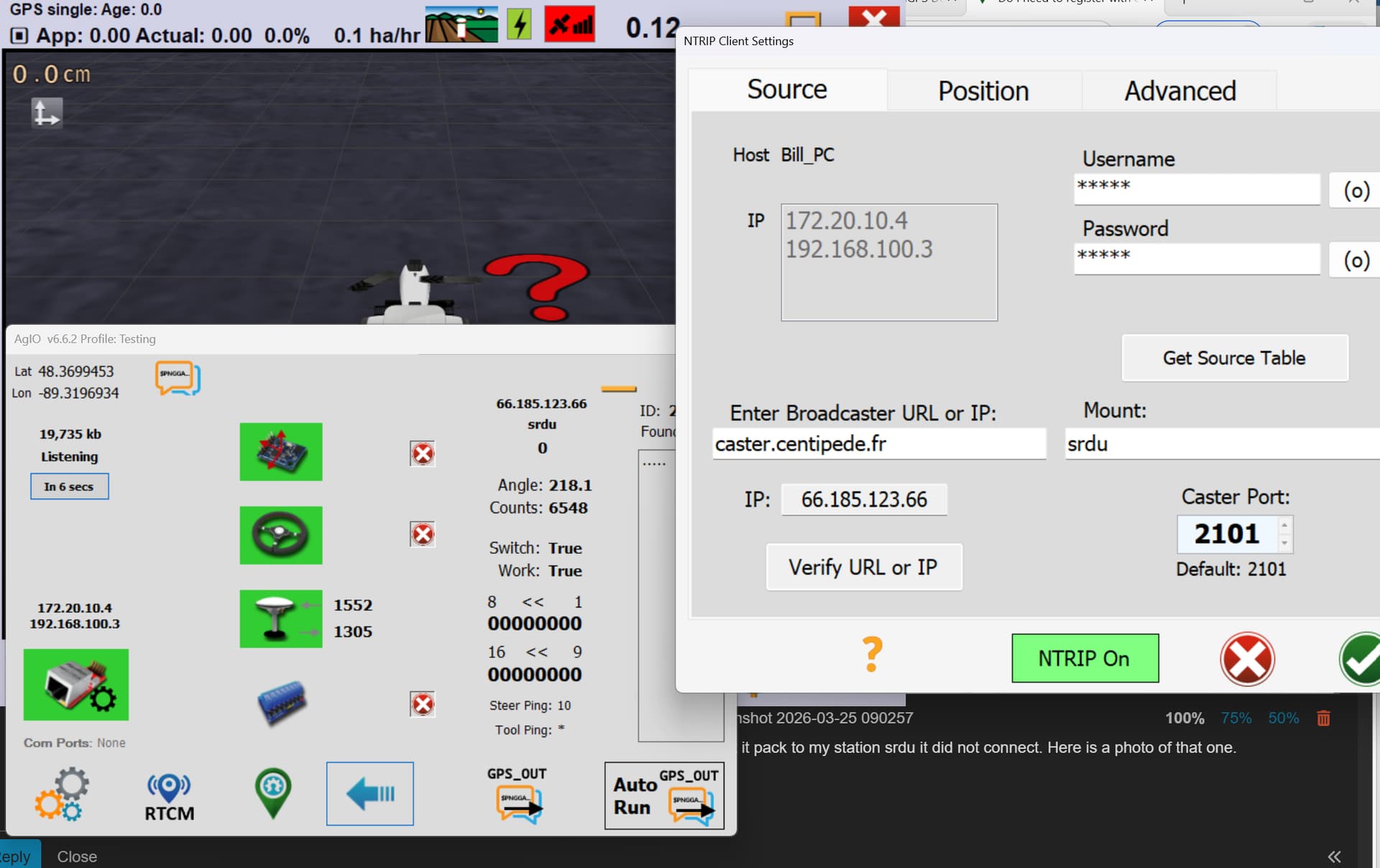

When I put it pack to my station srdu it did not connect. Here is a photo of that one.

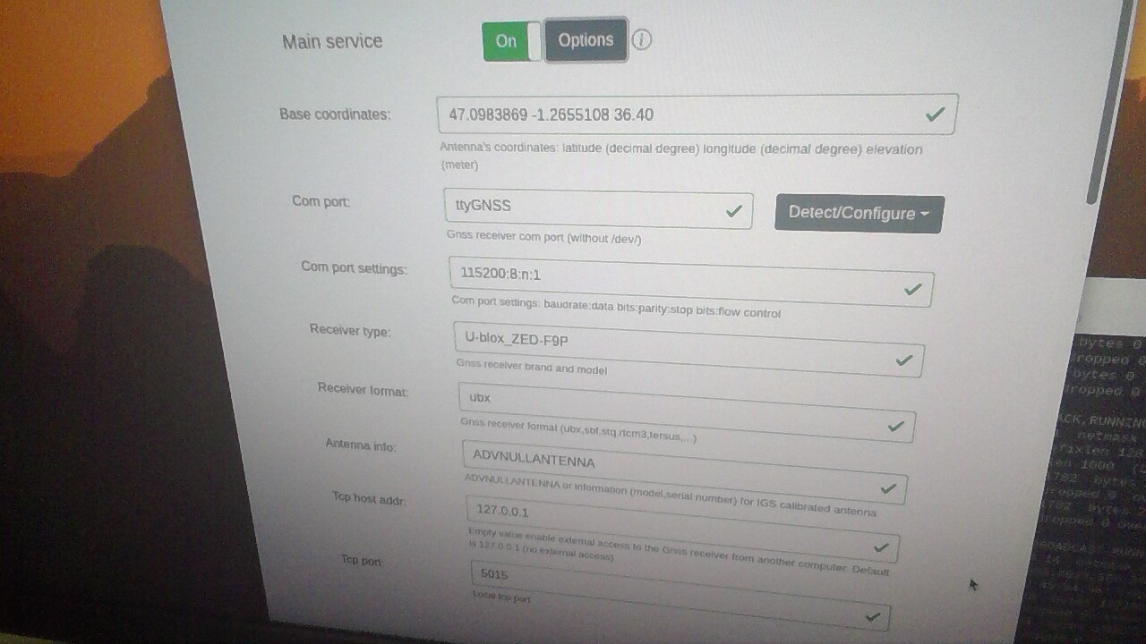

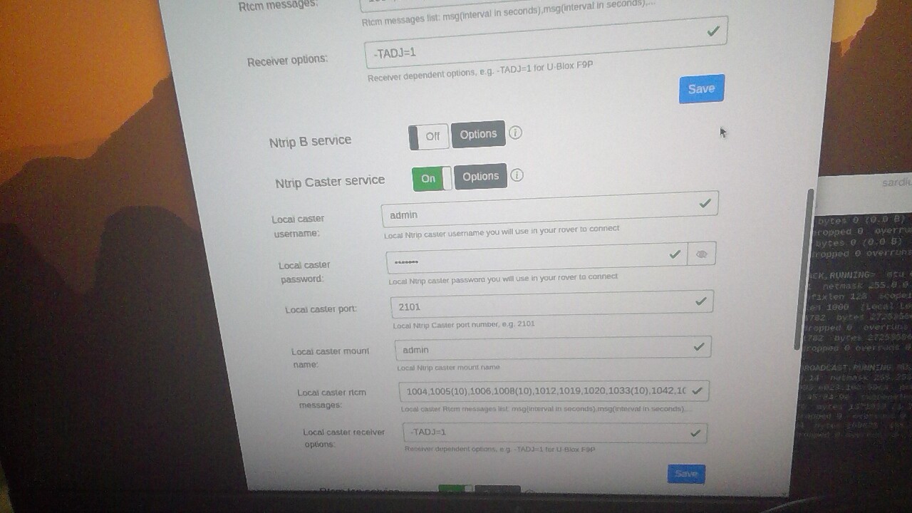

These are the settings on my raspberry pi running the base station.
In the first picture click get source table and see what’s showing in there and maybe connect to the nearest one.
In your base settings I think you’ve got the wrong caster password it’s usually username centipede, password centipede.
In the first picture when I clicked on the source table, the SGB1 was the closest one despite being 750km. My base does not show up in that list.
It’s fixed! You were correct about the password. I got mixed up with which settings were local and which where for the caster service. I’ve got my GPS inside so it’s been a bit inaccurate and it corrected a bunch when it picked up my base station. My base still does not show up on the source list but I’m guessing that’s because I’ve not registered it yet. Thanks very much, that was a huge help and I appreciate you taking the time to browse the forum and help!
