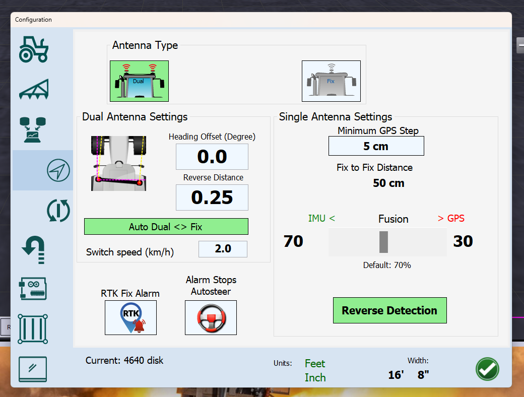

I have been running AgOpenGPS with the IMU but thinking about trying out the dual antenna setup.
I see in Configuration where to select dual antenna, but I am wondering how to go through the Wizard since the wizard is based on having an IMU for tilt.
Is there something different I need to do to zero my roll and stuff? Do I still go through the setup wizard?

Wizard works same with or without imu. Just make sure your antenna offset is right

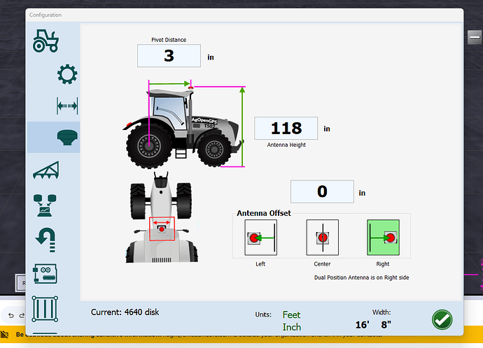

Sorry a few more questions.
So if the antennas are straight across then the offset is 0, right?

In the antenna setup in the tractor page you will need to enter the antenna offset there, usually the right offset option then your measurement
Turn auto fix off aswell
Oh I see.
And this would be for the “moving base” antenna position?
Select right antenna offset then your figure
