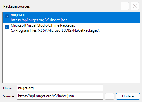

Hi @FantasyTeddy thank you very much for the response. It helped me solve the issue. I had updated to the latest 17.13.6 version of VS (still getting the errors).
The issue was the package sources. I had nuGet.org listed but somehow the Source URL was missing the /v3/index.json . Mine stopped at xxx.nuget.org
Once I made and updated the changes I was able to successfully build and run the app from source code!
