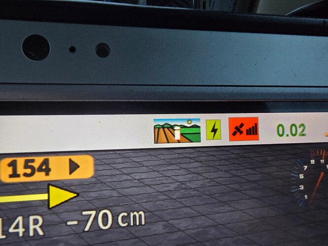

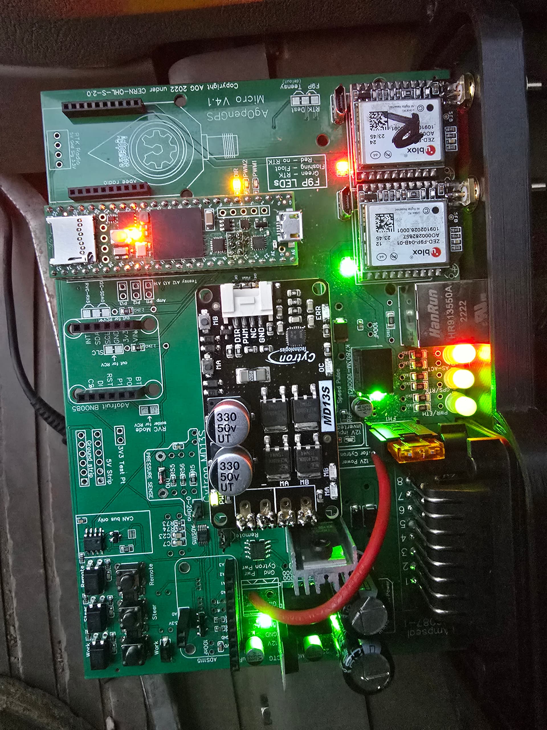

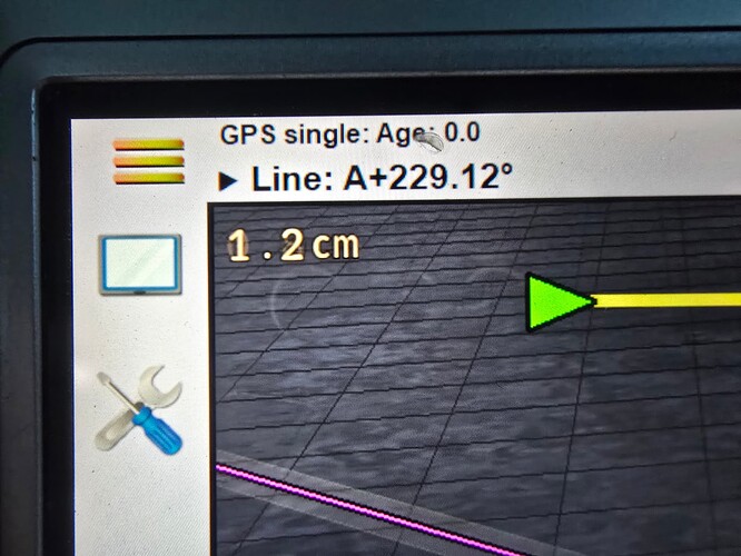

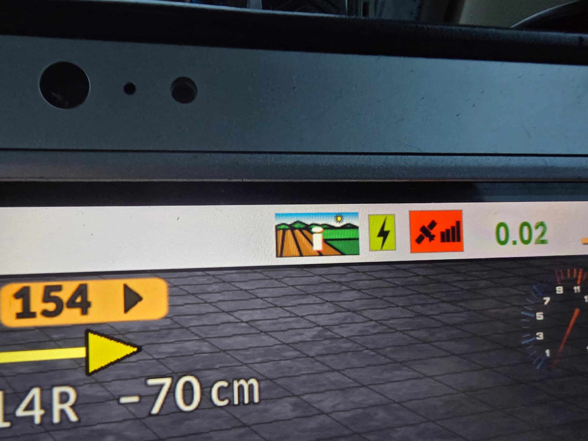

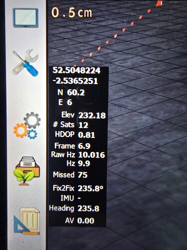

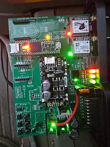

I have Ntrip all set up and working, and it will steer automatically as it should, just the one led on the right hand board is red and the left hand one is green. In AOG in the top corner it says GPS single even though it is set to dual antenna, and the little satellite at the top stays red. I Will check on my other system too see if the LEDs are the same. When i unplug the dual left antenna i lose all rtk signal, but when i unplug the right hand one it carries on as if i have changed nothing
Ignore the lights on the board for rtk as i think when you use dual the rtk stays red but i might be wrong
If youve got rtk the gps satalite picture should go to green so sounds like something isn’t quite right.

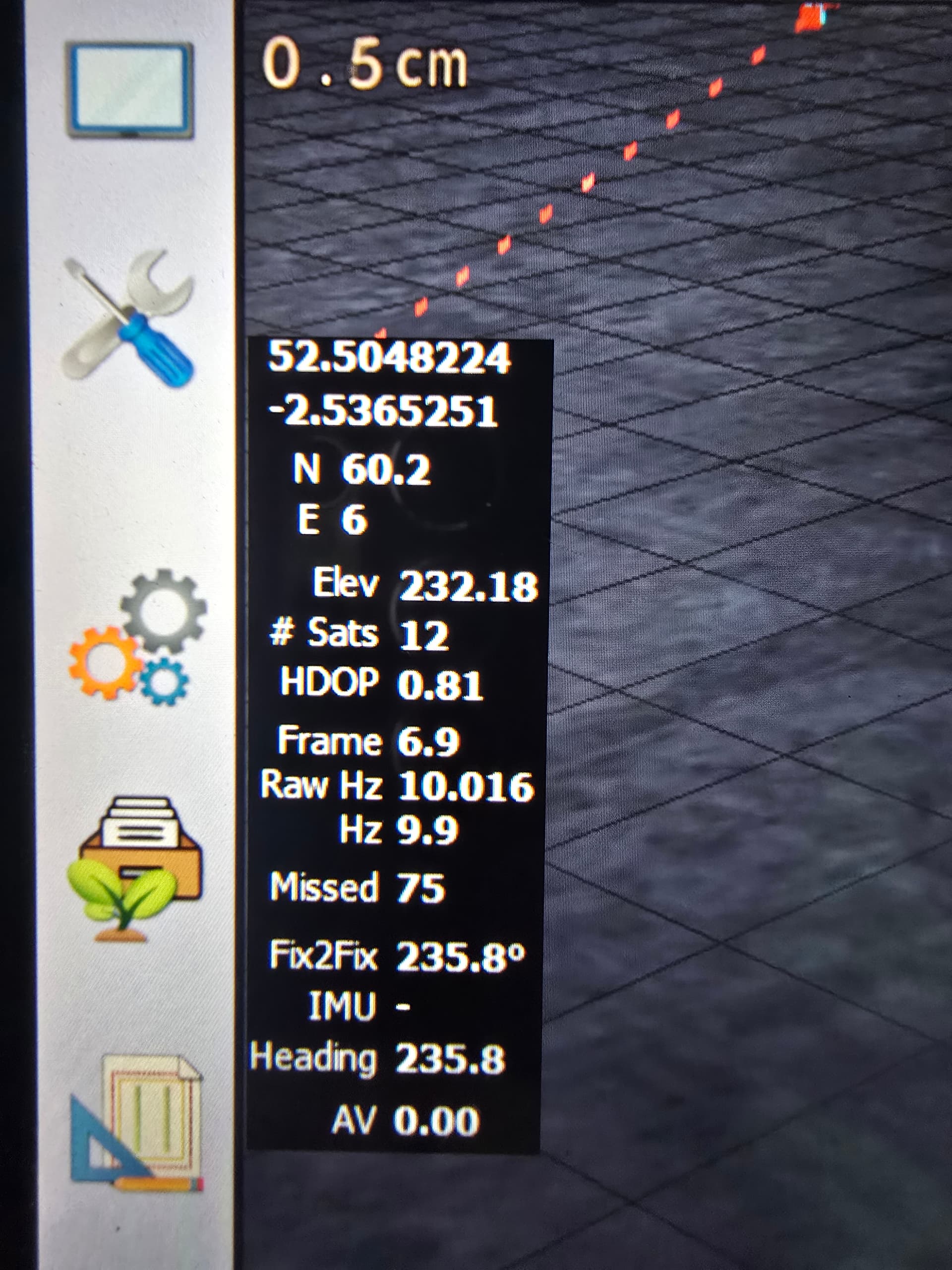

Maybe put some pictures up of your setup and some pictures of the agio page
Are you getting a steady roll indication in AOG?
Yes it senses my roll even when i remove the imu board so i beleive that is working but the f9p still gets no rtk
This is in the software
This is my board

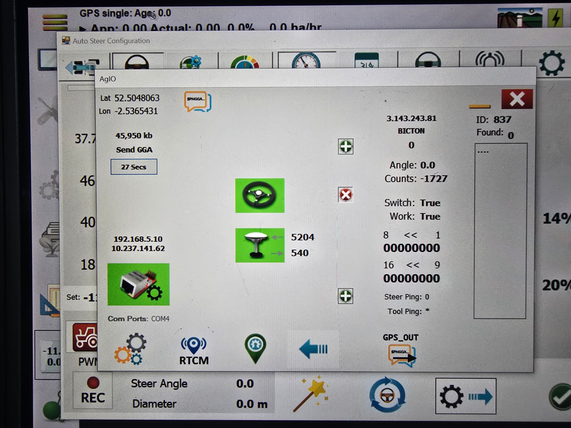

And you have set the way ntrip is sent from agio to aio. Either USB or UDP?
You can see no data is coming from the base station.
So I would look at the base station and or the Ntrip settings in AgIO.
