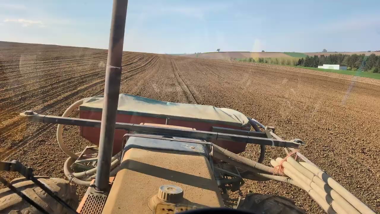

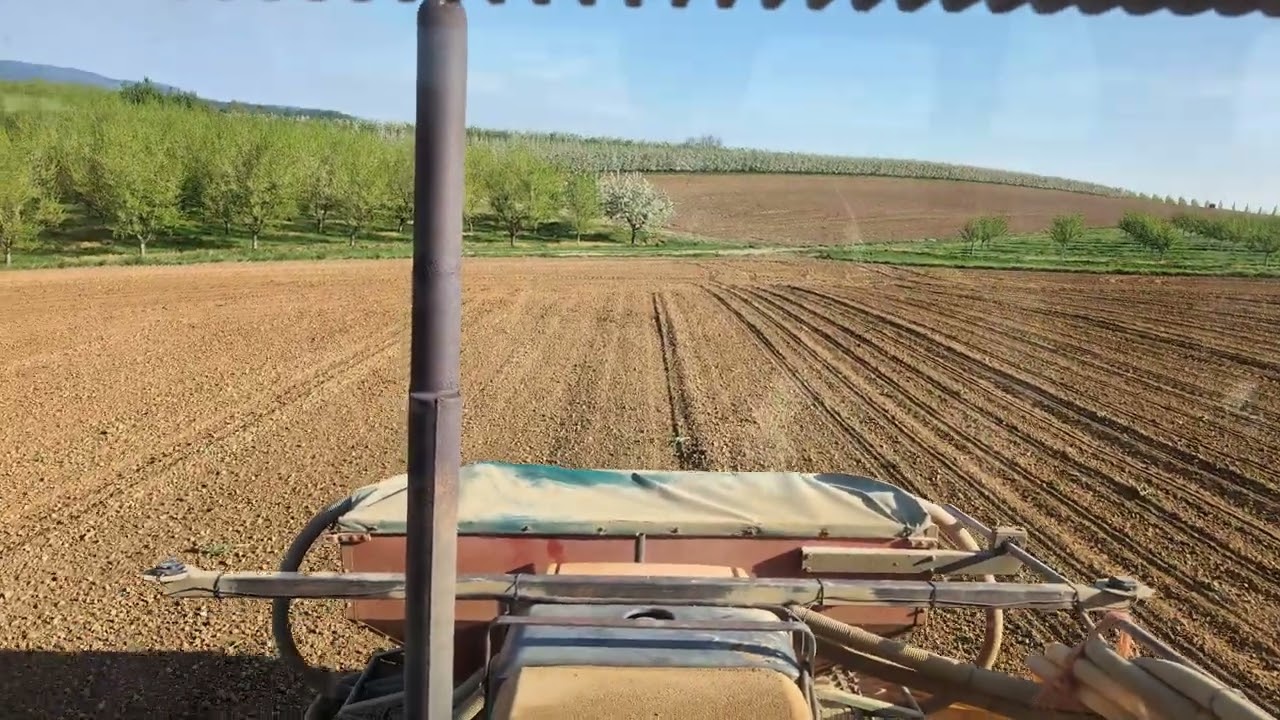

Last year I installed Agopengps to plant my corn, but I ran into a few problems.
My tractor has a front-mounted fertilizer spreader, which puts a lot of weight on the front, and when the planter is lowered, there isn’t much weight on the rear axle.
This makes the tractor quite unstable in terms of roll and on top of that, it has an older-generation suspended cab that moves a lot from side to side.
I tried mounting the antenna on the cab, but it was a disaster, so I immediately moved it to the front of the hood. It worked but there was a lot of lag on sidehills.

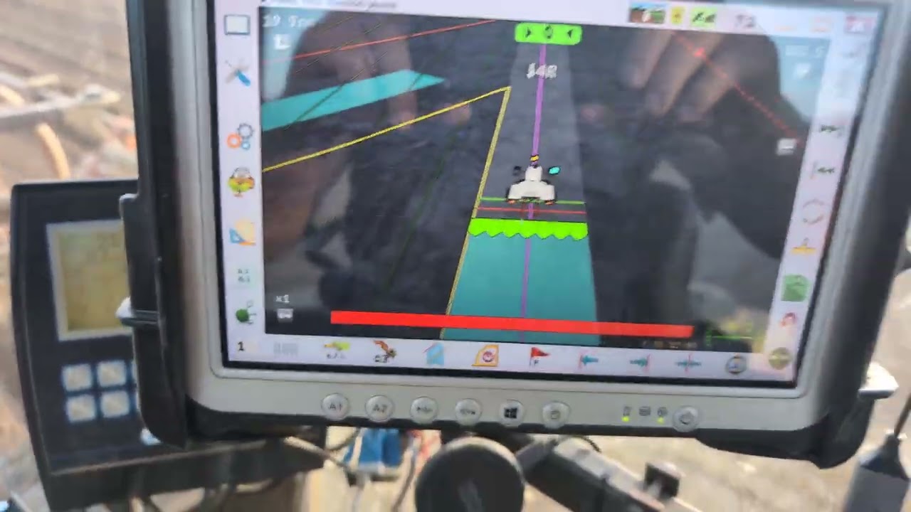

This year I tried using dual antennas on the front and it’s completely different from what I’d experienced before. Very stable even in the worst conditions, good stability on sidehill, and really great on U-Turn.
I’ve made a few videos in the worst possible situations. I hope this will be helpful to some of you.

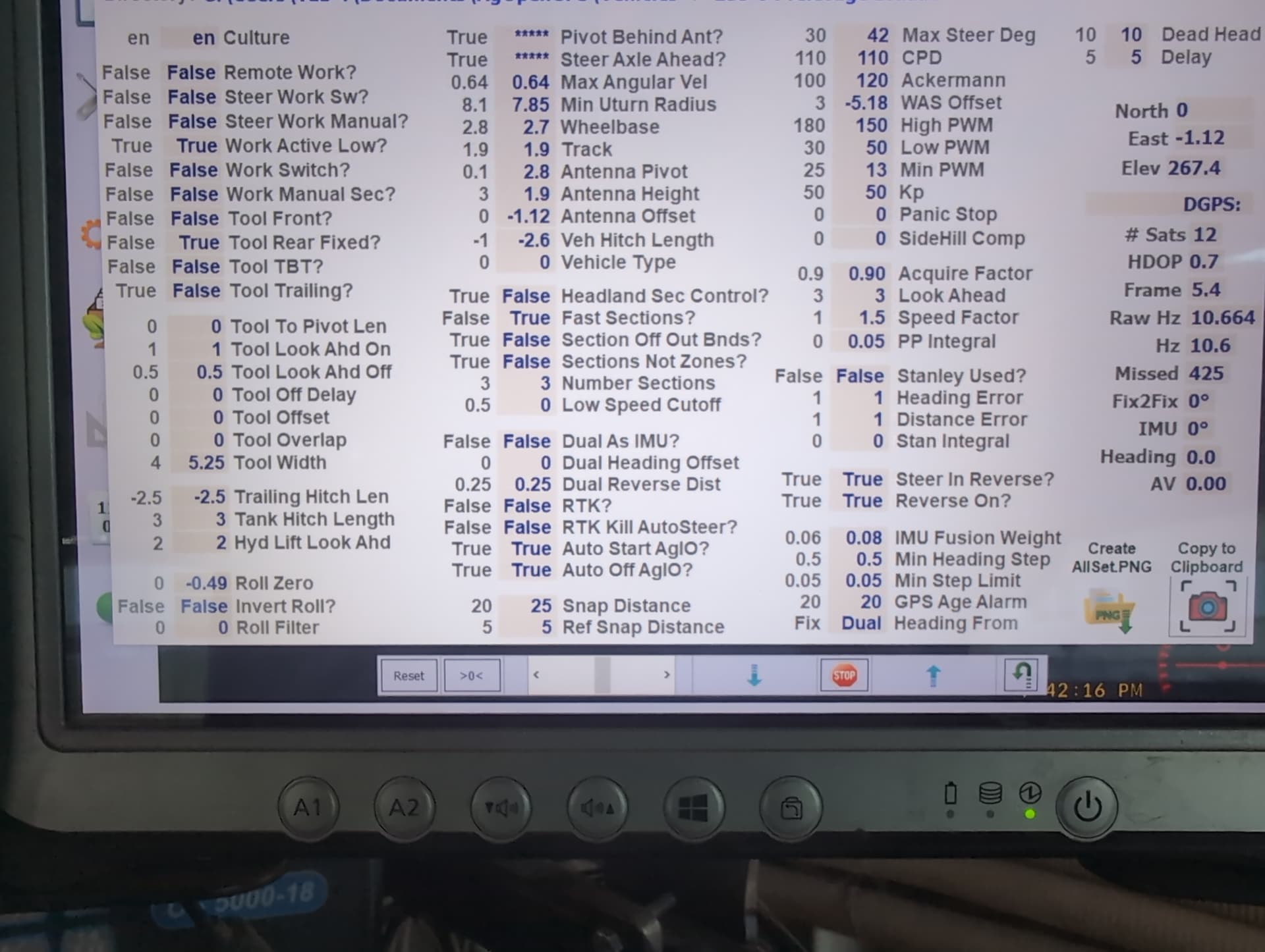

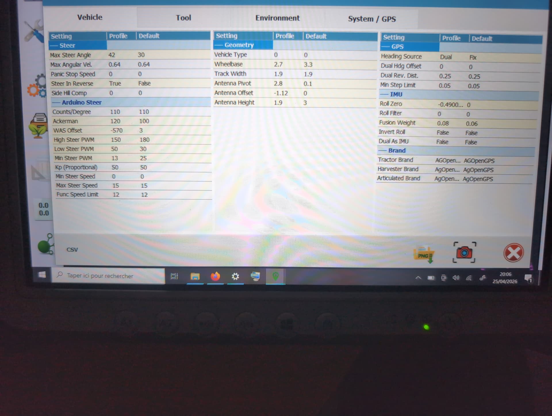

What are your settings?
I work with AIO v4.5 board with 2 F9P and a Keya motor.
I have version 6.7.1 on this tablet
I have uprated to 6.8.4 It’s easier to read
Usually I work with Integral at 5.
At the field with the sidehill I put it on 10 but at 10 it only work with straight lines not with curves.
