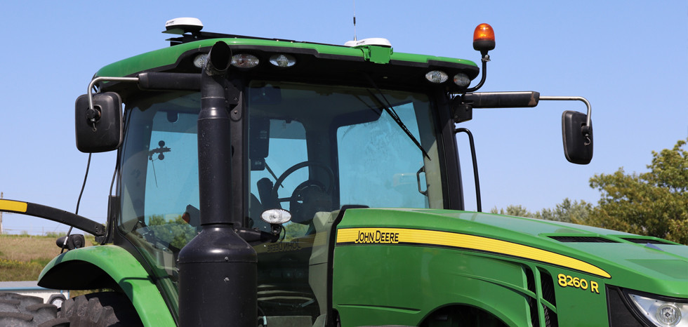

Loud thinking: With dual gps calculated heading and heading generated out of moving point (like it is done currently in AGO with single antenna and without BNO) you could subtract the drift angle. Together with roll could be a automatedsidehilldriftcompensation. Isn’t it?
Yes, just math! AOG already has sidehill drift comp. It just adds a bit more steer based on roll to turn uphill.
I do wonder about dual antenna and drift though, you would think it would want to steer downhill since the dual antenna heading wouldn’t be the same as the ab line, but try to make the 2 the same. Going to have to do some careful testing @MTZ8302.
With a single antenna the heading is still the same as the ab even though the tractor is on an angle pointing up hill, but fix to fix is straight. With single antenna, all of that is self compensating.

Our 15+ year old (so old it still only uses GPS) Autofarm systems use 3 GPS receivers for roll and heading. The main position receiver is L1/L2 RTK, the other two are L1 only for heading and roll. Works well for slow speed and very stable steering once configured correctly.
