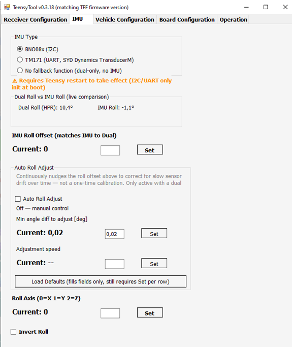

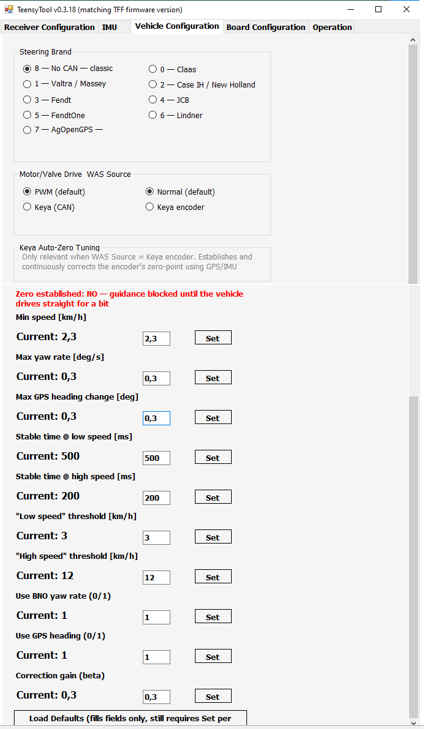

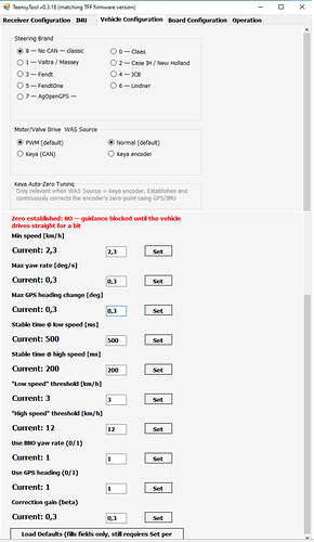

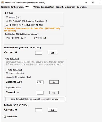

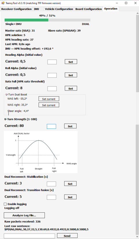

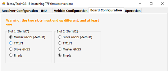

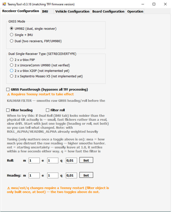

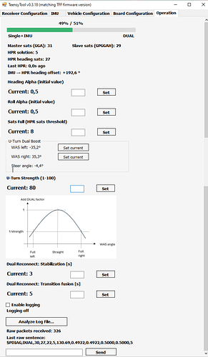

I found this concept pretty nice. I have now collected modules for the Teensy that I belive is working. Also, I tried to move the TeensyTool to c# in order to simplify an eventual integration of the Tool into AOG. I have tried to reuse code from AOG such as keypad and layout design.
The code now setup most common AOG installations. A lot of tuning is added as well. Going DUAL and IMU it is now possible to calibrate IMU with DUAL for both heading and roll. To start with here is screen shots of the new TeensyTool. On the last tab I also included system logging and file interpeter for system trouble shooting. I will post the files on github instead. Any comments?

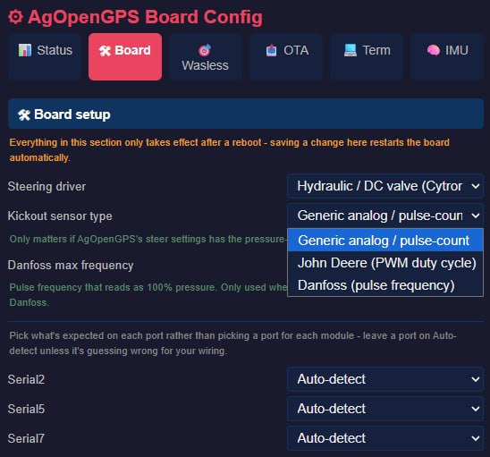

Teensy can also host a webserver maybe this side app could be integrated into there?
I started to play with Claude but I only managed to flash it haven’t really pushed further:
Yes, kind of the same concept. I thought of a future integration with AOG. Don’t know anything about the webserver stuff. One problem seems to be that firmware versions seems to be all over the place
