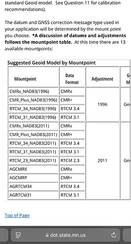

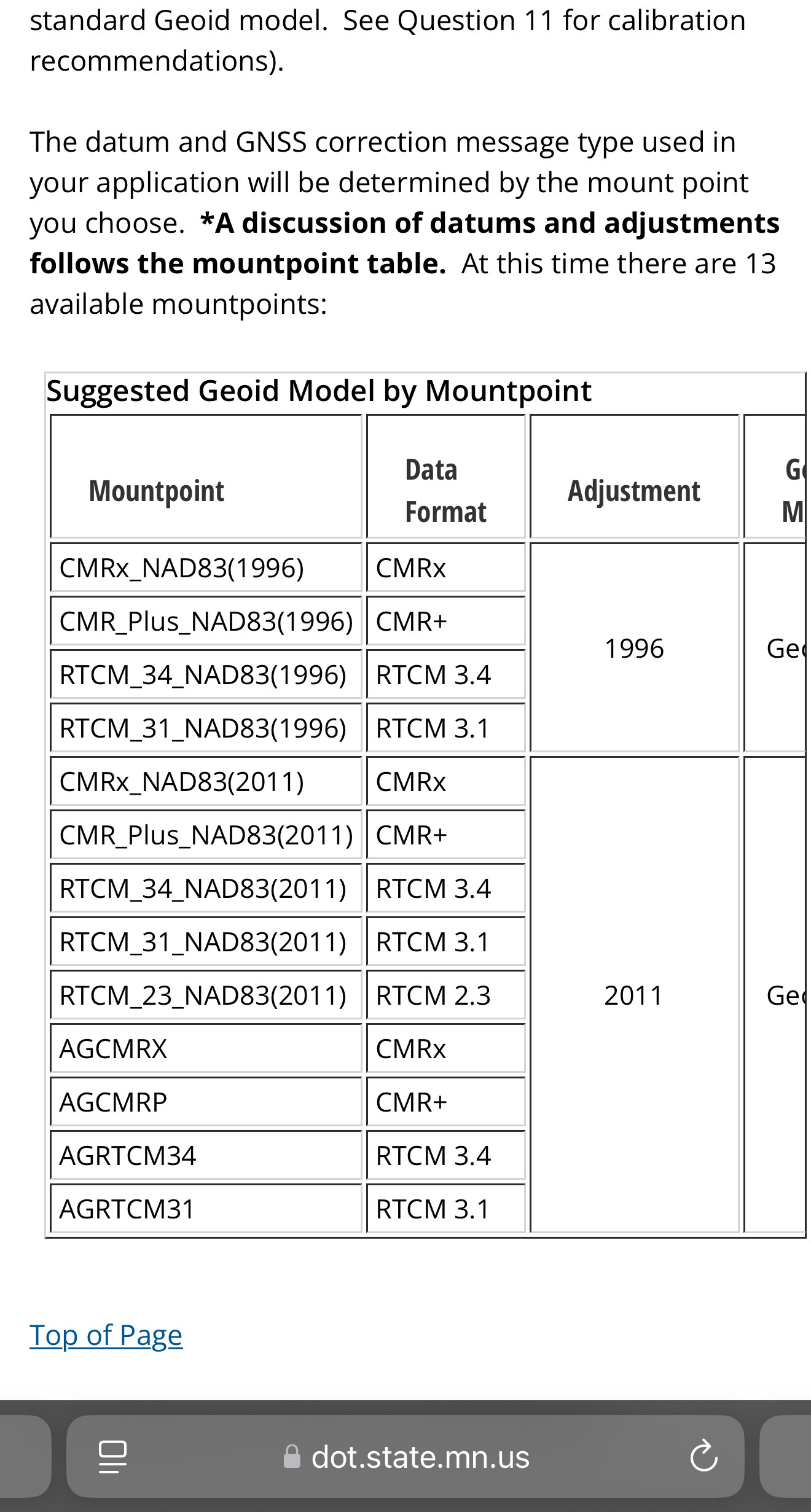

So I found AgOpenGPS about a month ago, and got an f9p and antenna from ardusimple right away and have been playing around to get used to the software. I’ve hooked up the gps and gotten signal, but cannot get it to connect to rtk. I created an account and gotten my login info and everything from the state website to get access to MN CORS- but not sure what selections to make. Here’s a list of the mount points to select from- any help would be appreciated, as without RTK it’s reading about 20cm accuracy at 5 mph, which I’m not comfortable with not using markers when planting at that accuracy.
Try RTCM3.1 or 3.4
I would suggest AGRTCM31 or 34
CMRx CMR+ are for Trimble, mosaic X5 can use it too.
