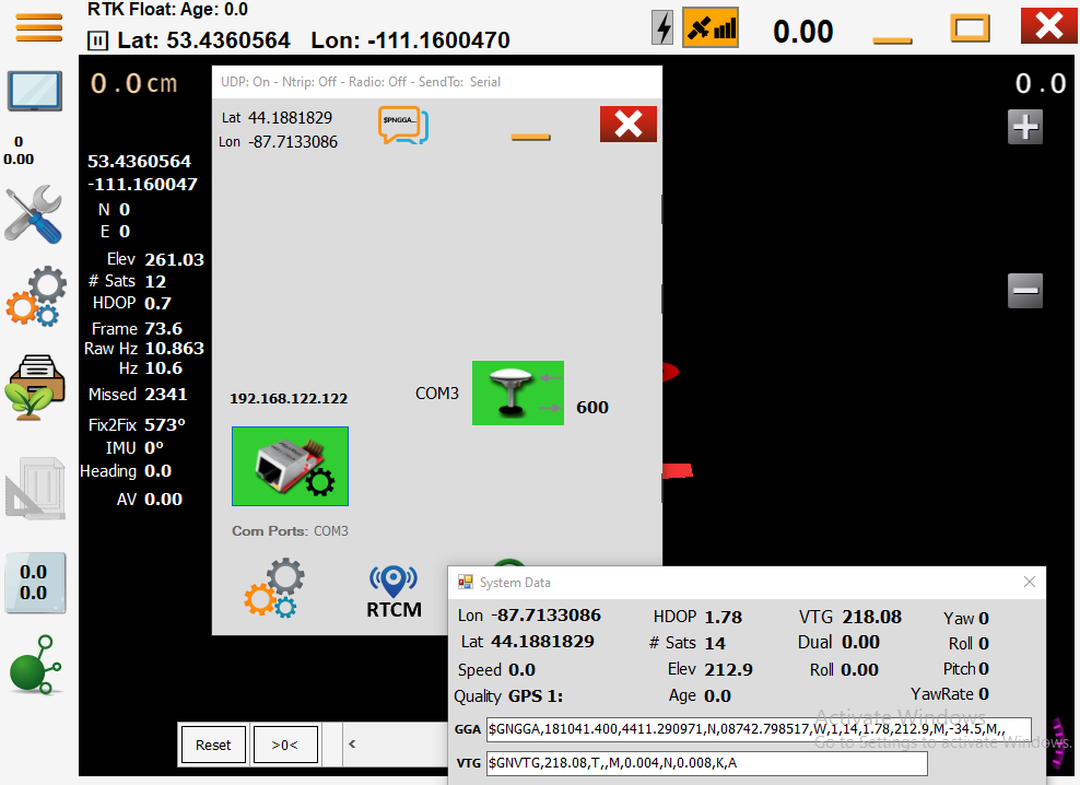

I am trying to bench test a setup to just get a basic light bar running in the field and I am running into issues getting my GPS data into AgOpenGPS. I have the GPS connected via USB to the computer and using the Quectel software and the Agio program I can see the GPS is outputting the current correct coordinates. However when I open up AgOpenGPS and disable simulator mode it never updates the coordinates, it is stuck in the same spot the simulator left it. I have the GPS set to only output GGA and VTG messages at 10HZ and everything looks good to my eyes. Any ideas what is going on here.

Does your antenna have a very clear view of the sky?
Have you updated the f9p firmware via configomatic?
Try a different usb cable perhaps
Do you have any other programs running in the background, shut them down if you have
Also try updating to the latest v6.6.2

That update to v6.6.2 did it. After the update my position is carrying over into AoG just fine now.
