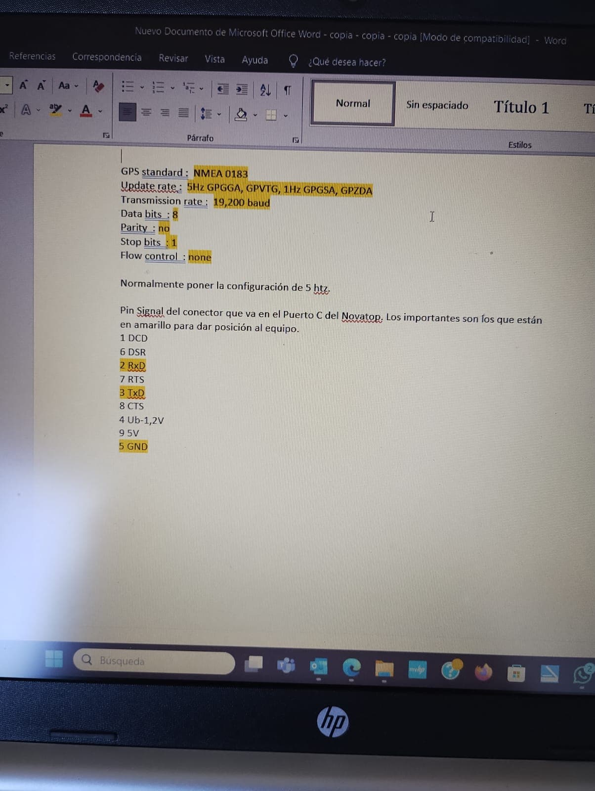

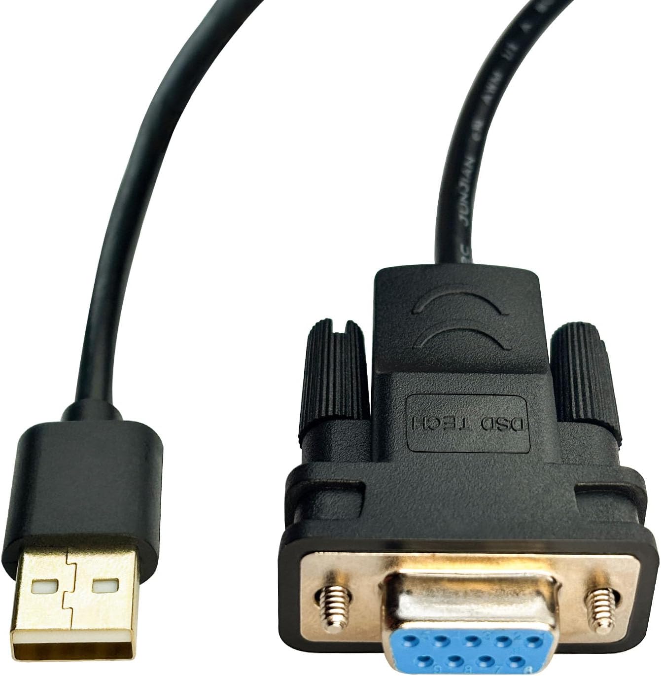

Yo utilizo este cable. Primero hay que instalar el driver antes de enchufar el usb
Thank you so much. I’ve already have same cable with installed drivers, but I haven’t Nmea setting. I’ll try to use your settings, I hope everything will be fine

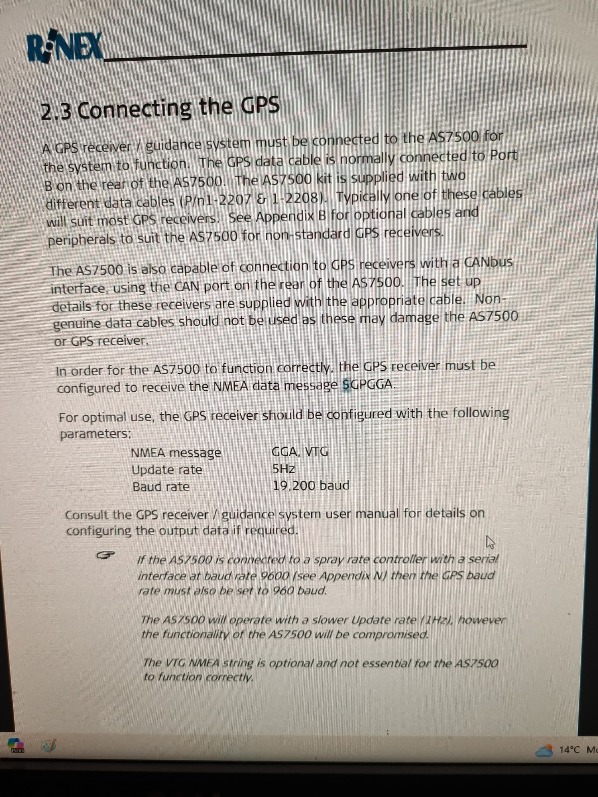

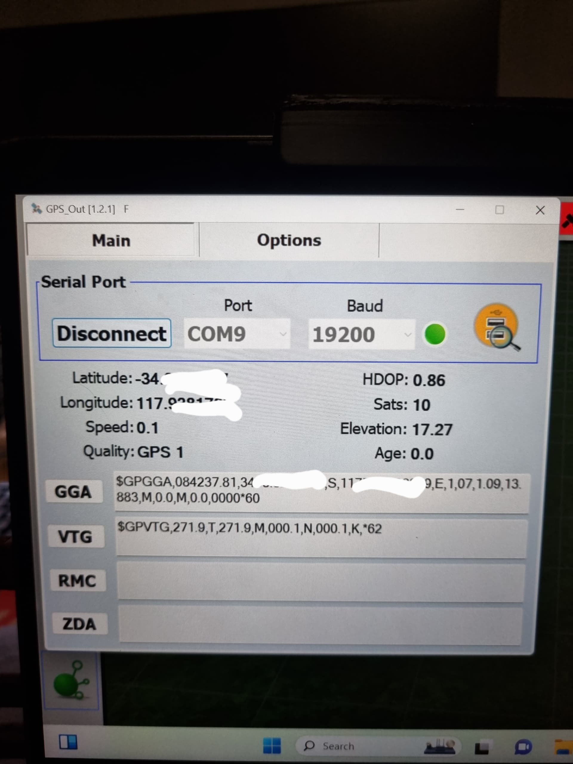

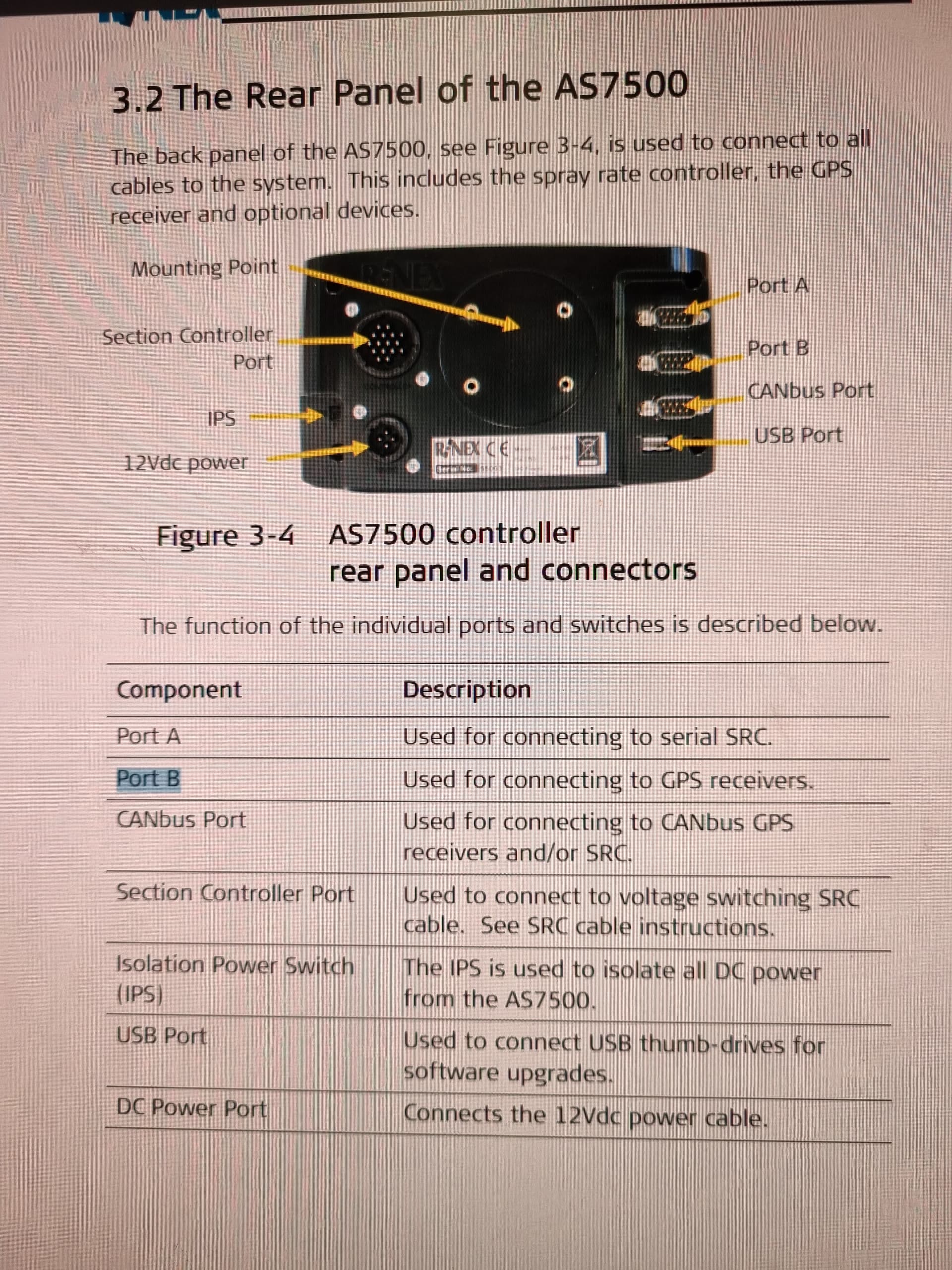

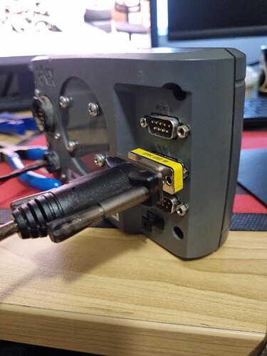

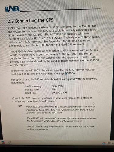

Hi, I am having some trouble with GPS_Out v1.2.1. I have current GPS fix/position in AgIO/AgOpen, but while using a USB to DB9 cable going into port B of ye olde Rinex AS7500 section control box. (Yes i know its ancient and outdated but it was $50 and I have a sprayer wired for it already…)

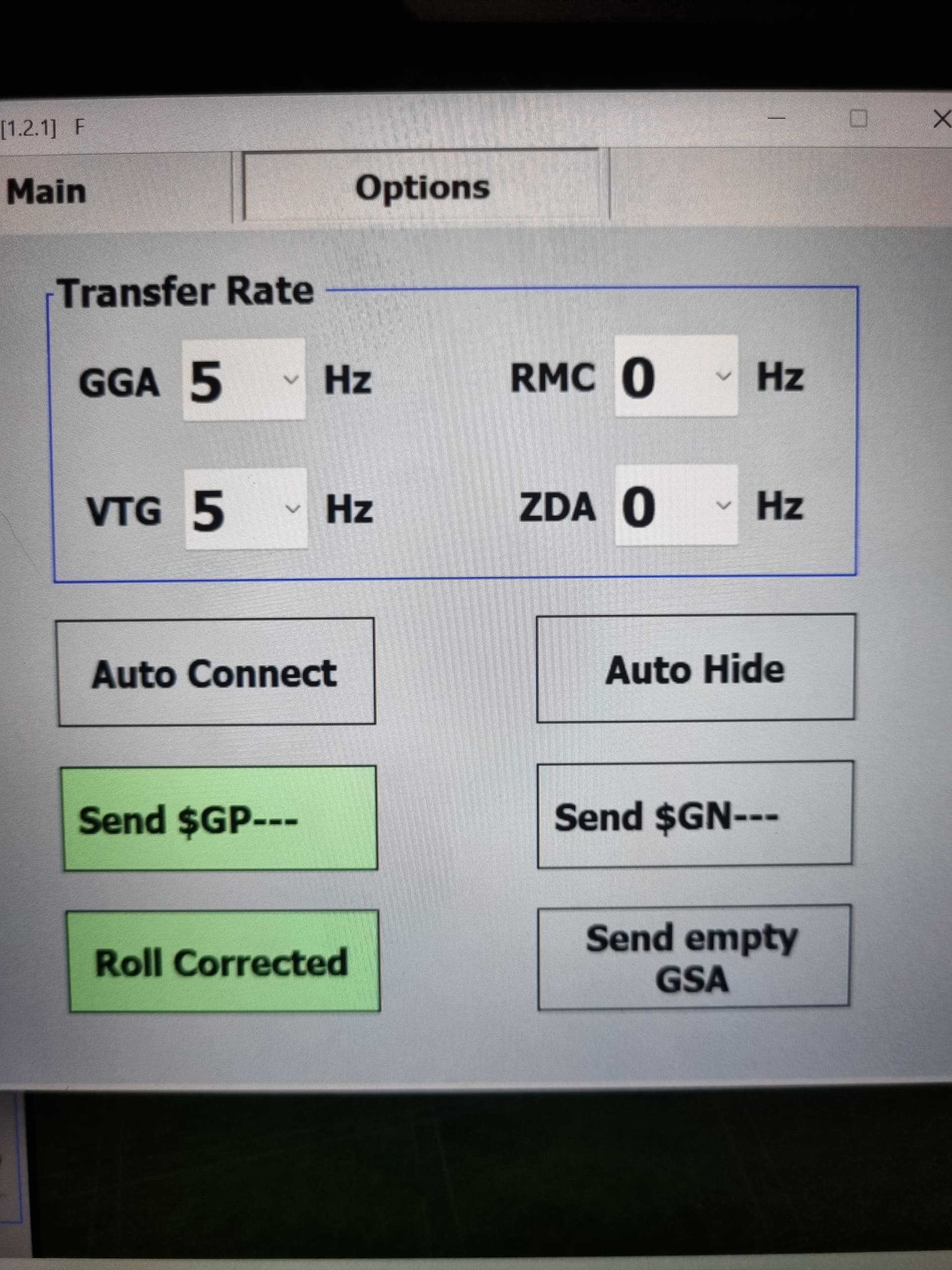

I have GPS_Out set to the settings prescribed by the Rinex user manual, I belive I have the correct drivers installed to make it all work, but I am getting no signal to my rinex box.
Is there any way I can validate that it is actually exporting GPS signal? This is an intermediary step between getting my board set up with a MAX232, but I would still like to get this to work!
EDIT: I have validated baud rate settings on the rinex box, and tried all available baud rate options on the NMEA setting and on the NMEA2000 setting, with no success, and little idea of what I am really doing!

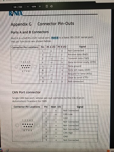

Settings look correct. The Rinex document states two different cables. Maybe the pinout of the Rinex is different.
I have provided some more references from the Rinex user manual, it states to use port B (same as a GA8500/Inex display if anyone ever remembers them!), and it provides a pin out for port A and B. I am using a USB to DB9 cable and a mini gender changer, I have a spare cable I might try, but might have to try another device to see if that gives me any luck…
