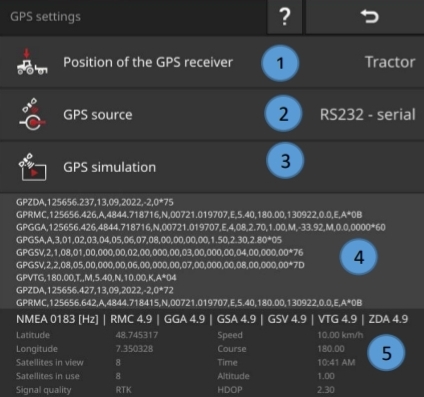

Does enyone know if I can get CCI 1200 working with gps_out?
As far as I know it works
I founted fron telegran: CCI has minimum requirement GGA+VTG and GSA
