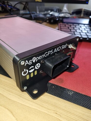

I have designed a 3D printable end cap housing for the Hammond enclosures that incorporates two mounting holes at each end. The holes are modelled at 7mm to allow for variation when using an M6 screw. I will install into riv-nuts in my cab floor, with a rubber sheet or Tee Jet nozzle O rings under the enclosure to help isolate it.
I have printed mine in PLA, as that’s what I had installed at the time, and my little ender 3 struggles with ABS, but I know the first Australian summer will deform the PLA, so I would recommend ABS at the minimum.
