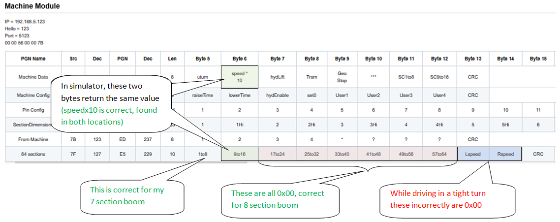

Thanks for the suggestion. With the simulator, when receiving this PGN:
Byte5 contains the correct section info, but bytes 13 & 14 are both 0 while at speed and in a tight turn.
At the same time PGN 239 Byte6 (Speed*10), is returning the correct speed. ???
Digging into Machine PGNs a bit more I find some inconsistencies with the documentation. I wonder if the Lspeed/Rspeed exists in another part of another PGN?
No negative value? So I guess you would need to use center and the higher side if one side is 0.
Odd that you see speed at the 9-16 sections byte.

This is embarrassing. In parsing PGN 239 I was getting zero for Lspeed/Rspeed, causing me to abandon that approach.
Turns out my parsing code was flawed. Fixing my code then the Lspeed/Rspeed are there.
I now have the turn compensation working using Lspeed/Rspeed. Plus I learned how the get yaw rate from an standalone external IMU.
