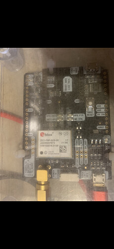

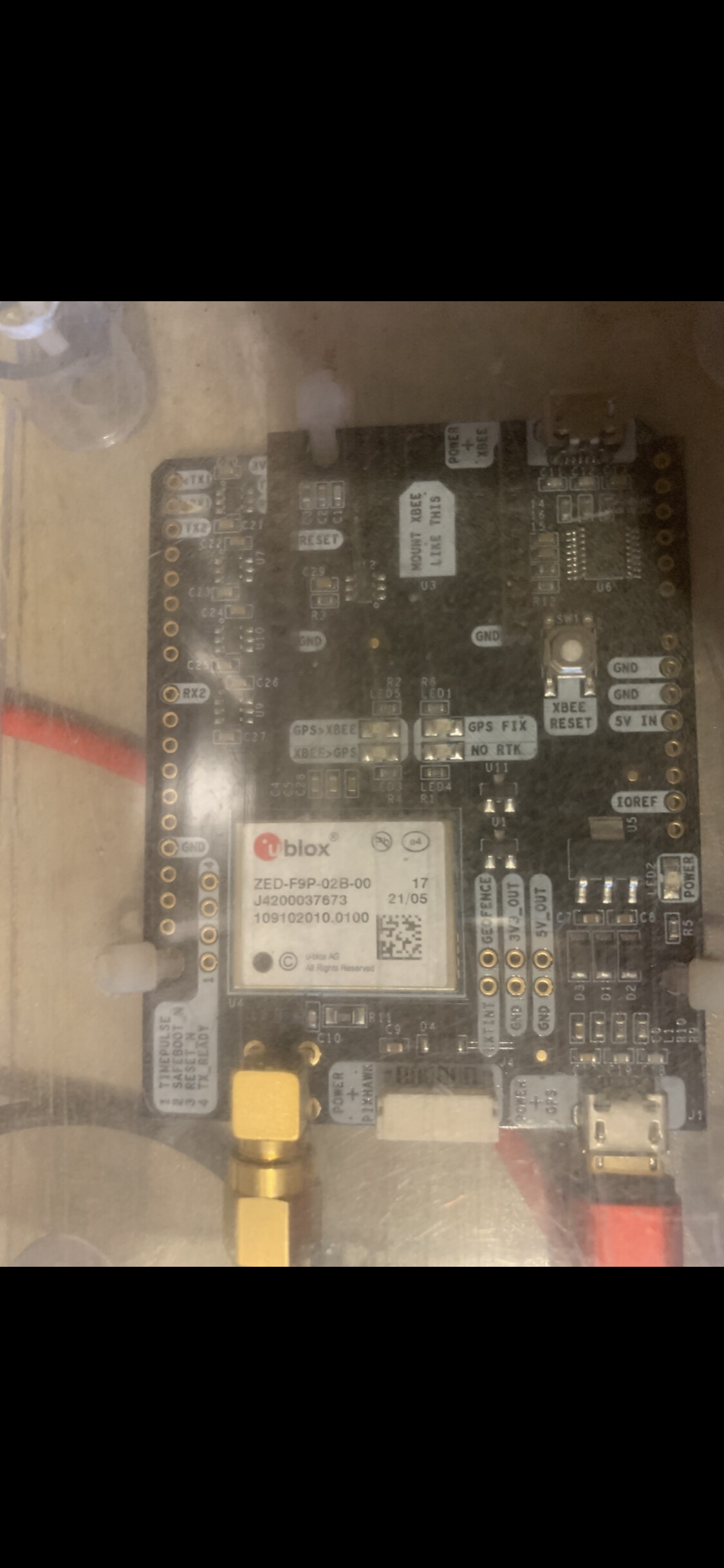

Are you using one F9P alone connected through USB?
Or single F9P on a board and, importantly, with or without a BNO085?
Knowing what hardware you have will help to guide you as it must most likely be some setting in AOG to adjust.
My antenna is ublox ANN-MB-00-00 plugs in to a ublox board (picture below), and then usb to my Panasonic FZ-G1.
