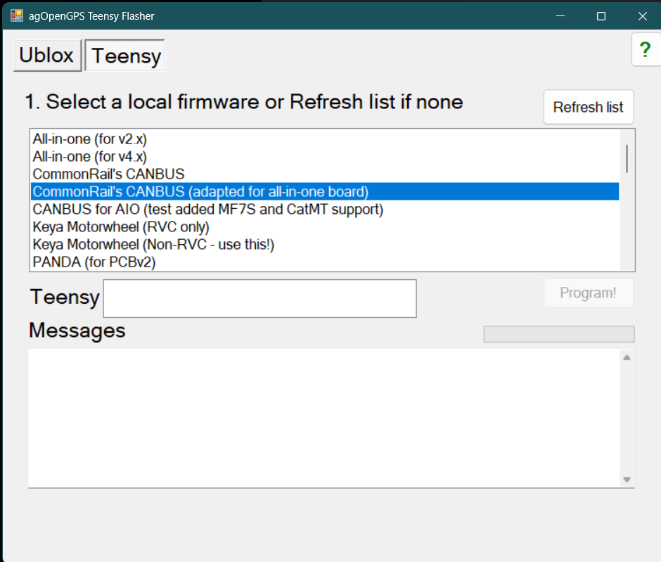

Would it be one of these?
ebcb9ef626577471791385922dd8ea4088838fe6
Thats on configomatic
Look in the boards repo and choose the aio v4 canbus option i think like @TeddyStamford suggested
