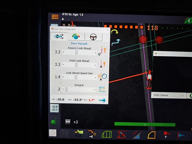

I am having a hard time to get AOG driving straight.
The steering is oscillating between the straight line and ~60 centimeters on the left of this line.
I filmed the AOG screen with setting and chart : agopengps - YouTube
Can someone guide me to the right settings to apply?
The latest version has a good feature to set the counts per degree, I would start with that. Check all your measurements then play with the look ahead in pure p
Thanks for the infos.
How can I check that the x/y axis (MMA) are correct?
Because the fact that the system is staying on the right side of the line only is maybe a question of hardware??
